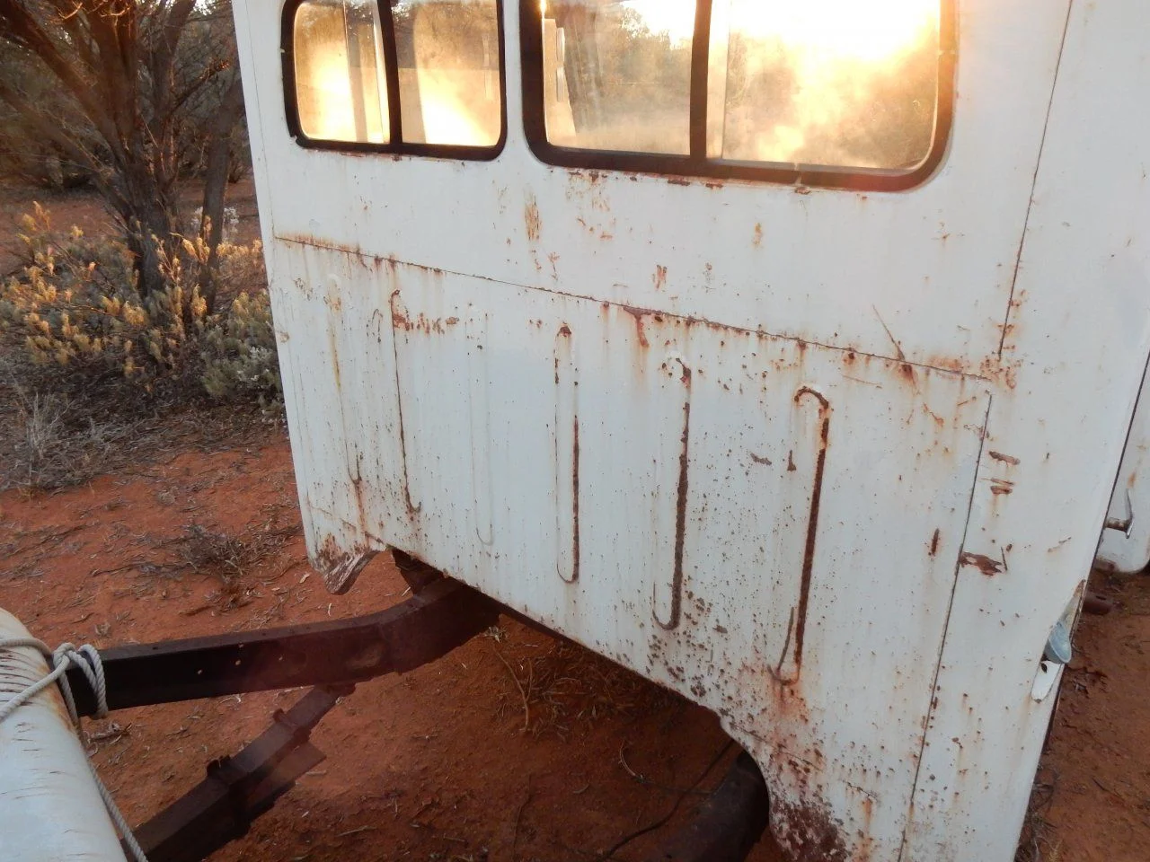

firstly the reinforcing ribs at the back of the cab were originally 6 narrow ribs pressed proud of the cab when looking from the rear; later where 4 wide ribs recessed back into the cab. early pictured.

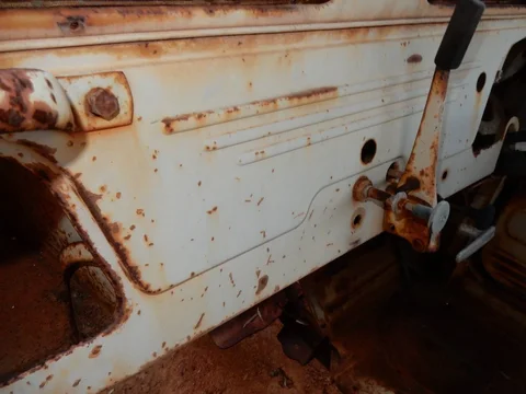

the early cabs had no ashtray, so slider rear window locks and no provision for clips to stow the crankhandle behind the earlier 'triangle' shaped toolbox.
mine also has pressed steel door keepers instead of the later cast alloy piece
