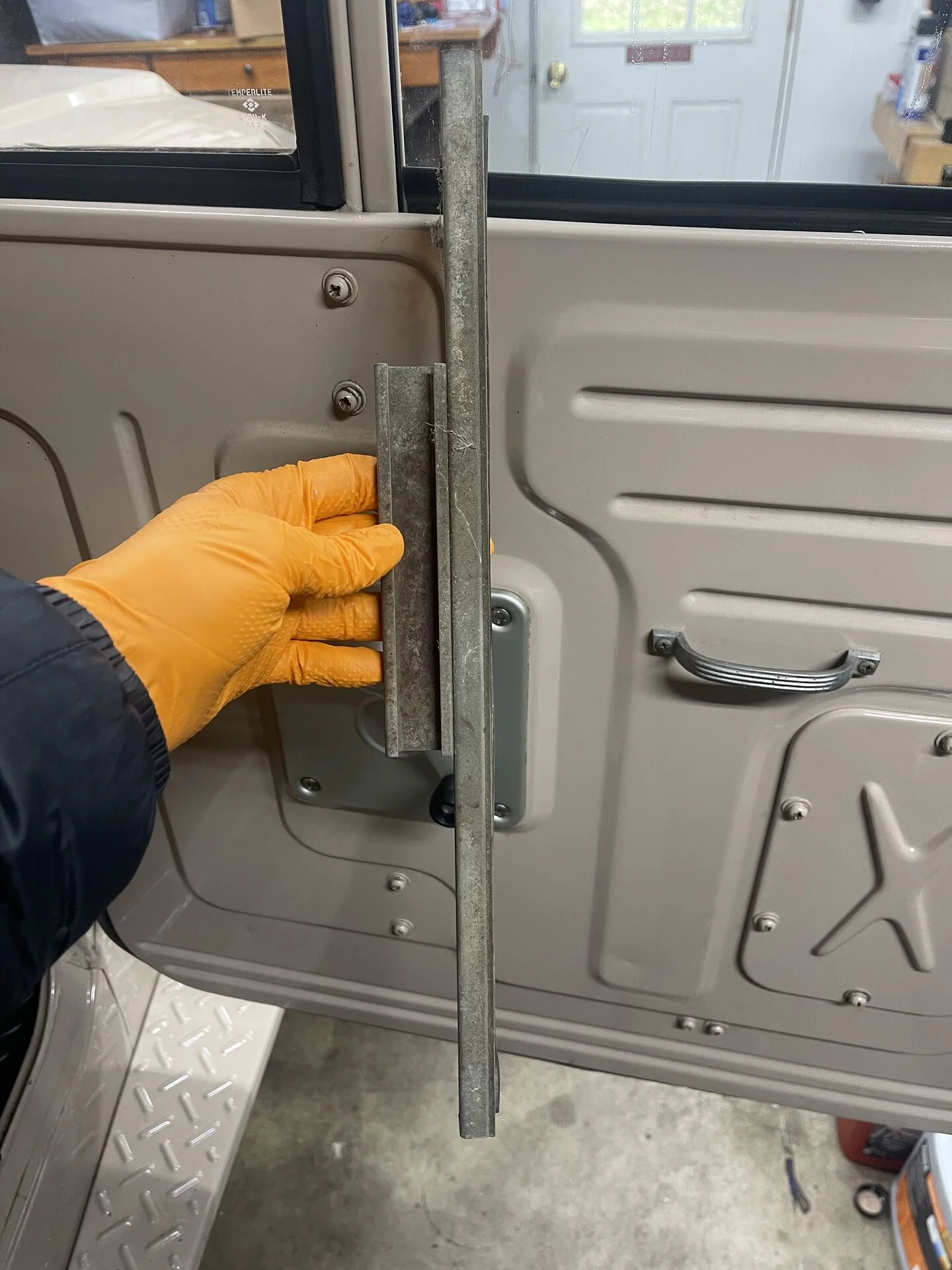

Thanks. The tracks are attached to the glass pretty good, I don’t know if I can move it, also I don’t think there is much space. The track looks like this:

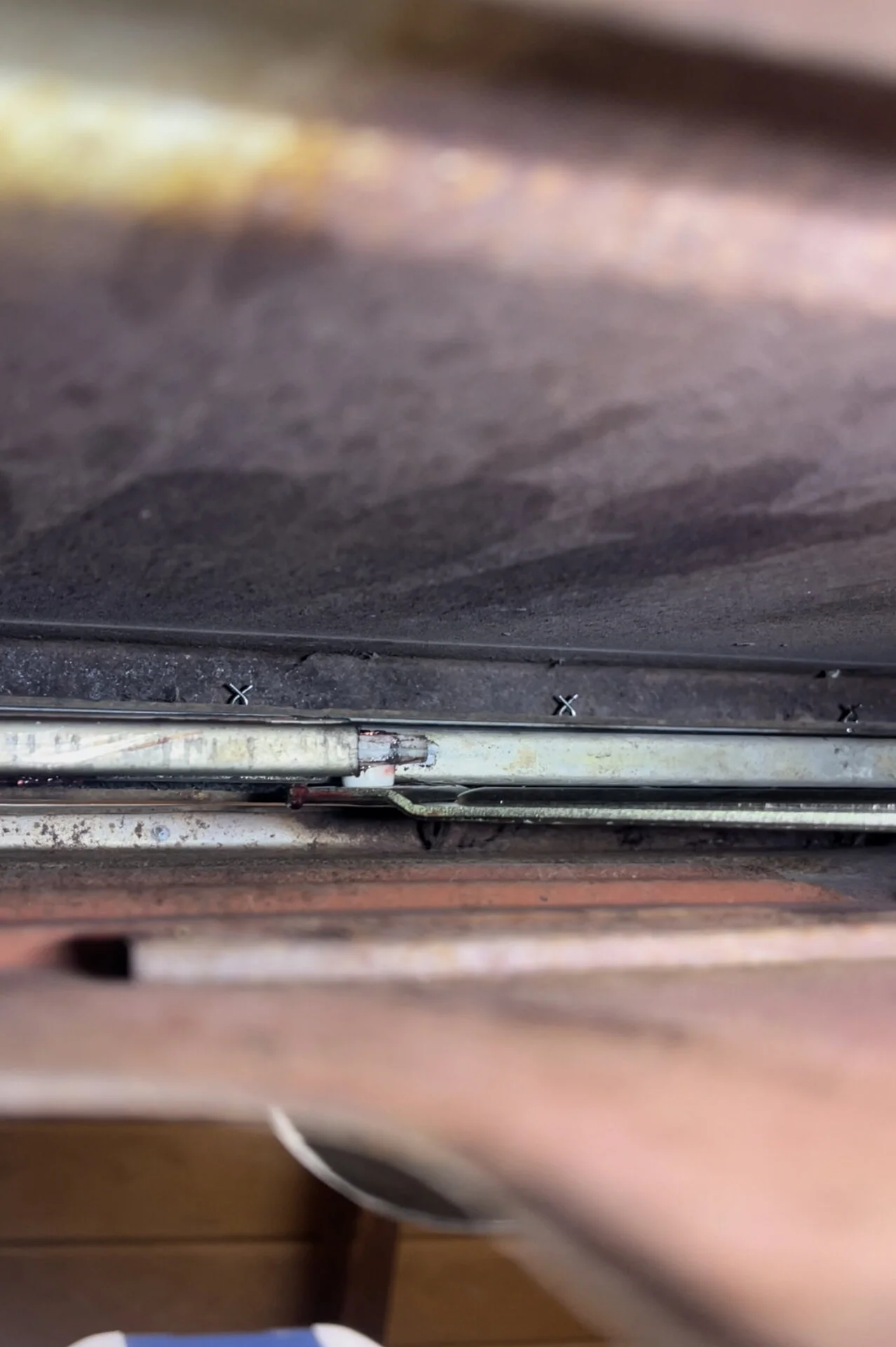

I think if I were to disassemble it (and cut the weatherstripping), I would replace the glass as well so I would really appreciate it if you have the glass size so I’d have it ready when I take it apart. I didn’t quite understand the question about the top of the door but it’s like this ( the size is roughly 16inches):
