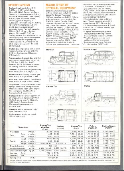

that combo was actaully listed for the FJ55(non US) in 68-9
see the options on the far upper right
I had to copy and zoom it to read it. It's tuff getting old. I think it meant the floor mat was a FJ55 only option not the rest. I know that Toyota had a full synchro four speed before the H41/H42 but didn't think it was mated to a single speed transfer case. I'm working on doing some trading right now to get an early four but it mates to the two speed transfer case. I think the early one is 5.33 to 1 compared to the 4.99 to 1 of the H41. Pretty the FJ25 four speed is 5.41 to 1.

55 or 40.....dunno but it was shown as an option for one or both......unless a miss print(which I doubt)

I think that the 4 spd in the brochure is the "early" full syncro unit that is shown in the black cover chassis & body FSM. It clearly shows the counter shaft w/gears as seperate parts, the H41/42 has a unit counter shaft.
