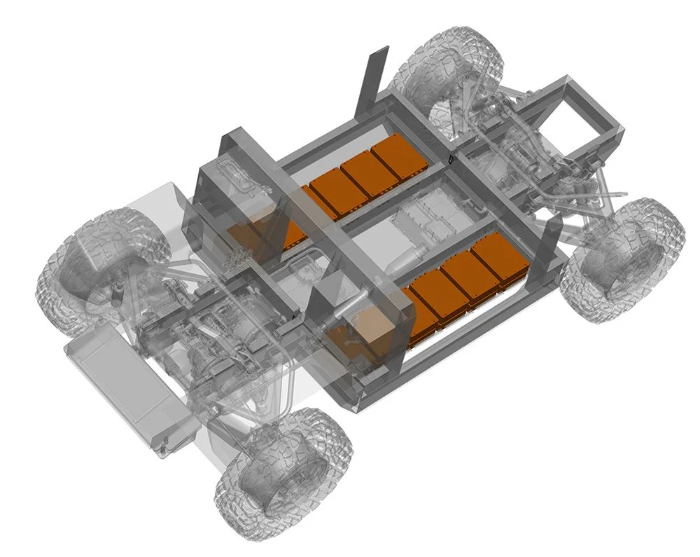

Just to flesh out what’s meant by more usable space:

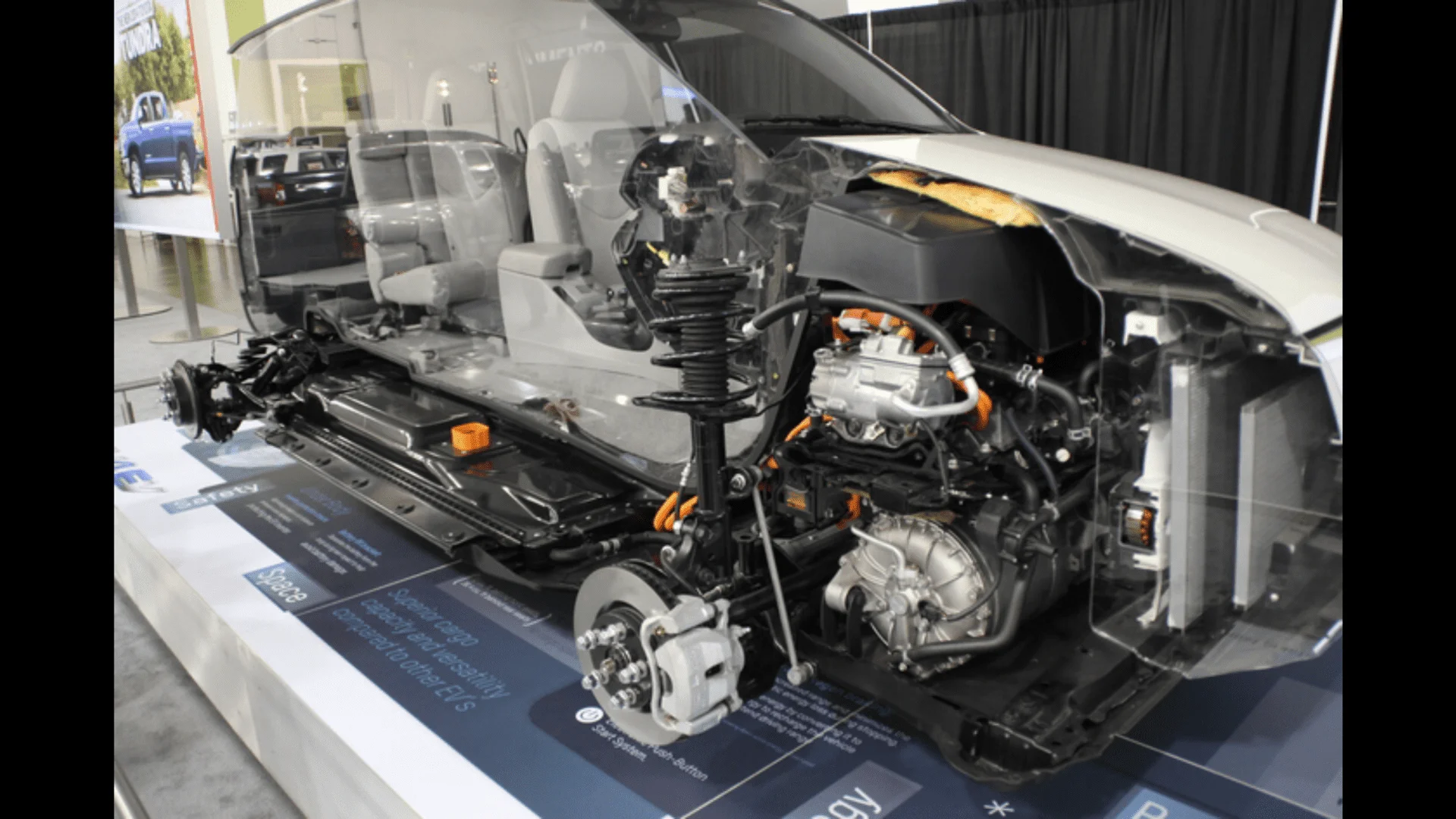

Imagine: (a) the Tesla battery pack sandwiched between the frame and the current body, acting essentially like a body lift; (b) Tesla battery modules detached from the Tesla battery pack and distributed into aluminum or carbon fiber boxes into the existing LC200 frame, including current tank mount location, etc.
This results in the engine compartment being freed of engine, tranny, radiator, air intake, etc. You’ll still need a small part of the engine bay for mechanicals (AC/Heaters, Transfer Cases, etc.). But the cubic meter/yard or so that’s freed up by the engine is one more cubic meter for your camping gear. Not too shabby.
Next, getting rid of the high-mounted tranny channel allows you to have more interior space in the cabin, if you want to reclaim it, including the possibility of a front bench seat, 3+3 riding configuration, a proper deep, functional console — instead of the puny console or San Pellegrino fridge many modern 200s come with.

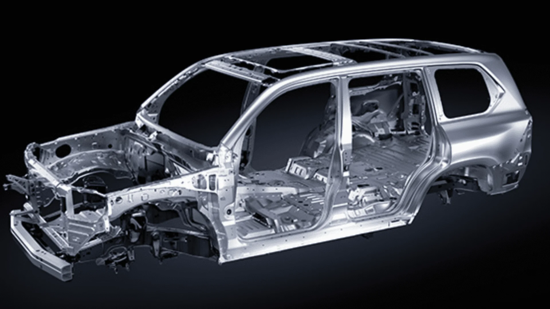

What “remains” of the 200 with a build that’s this radical? Uhmmm, the LC’s legendary structural integrity in terms of frame/rolling chassis/suspension/geometry/cab — with only the drivetrain swapped out.

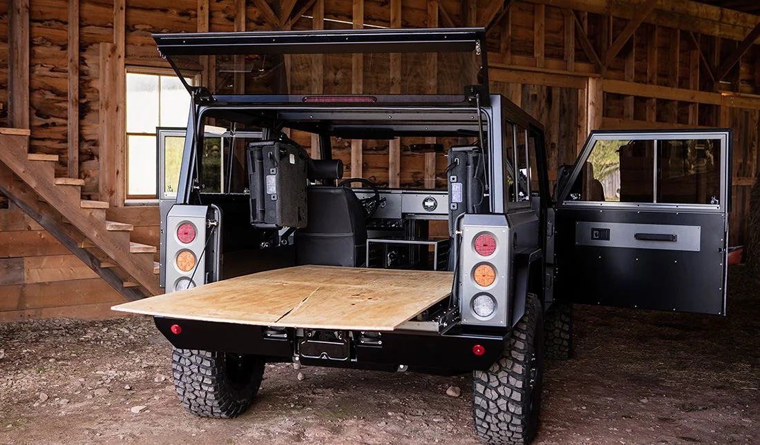

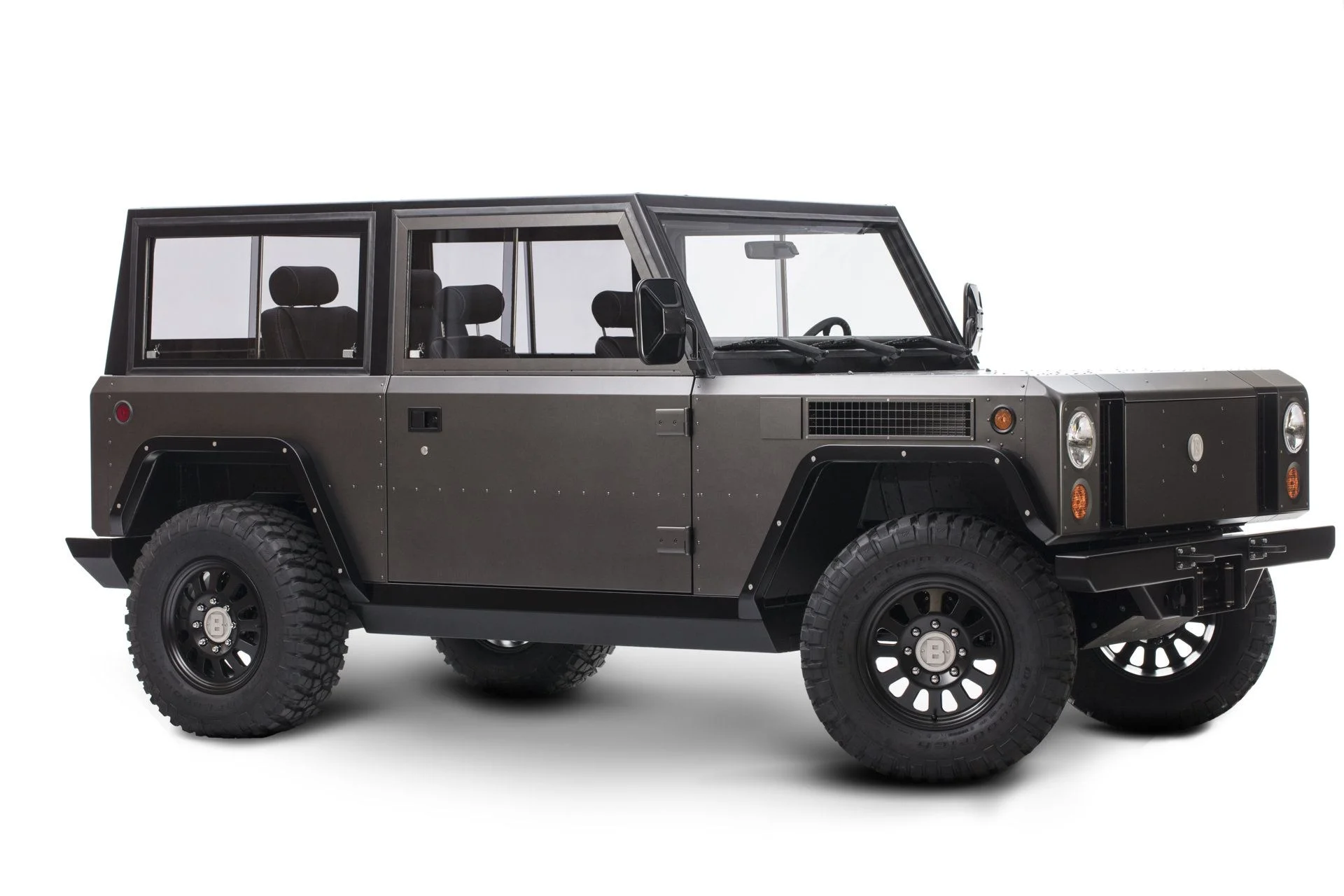

The Bollinger prototype rocks, Yes, but at $100K to $150K, this is pricey untested proposition. Versus $25K for a solid/straight used 200 series, $25K for salvage/restored/running Tesla two-motor axle assembly and controller, and another $5-10K for a functional battery pack. Plus a ton of elbow grease = $50-60K ECruiser.
Advantages of ECruiser versus Bollinger: Extremely tested/proven structural/frame/suspension setup, electronics and safety setup (ABS, Airbags, etc.). The ECruiser *proposed* build would be cheaper/safer/simpler than an entirely new model line. Then again, Tesla has been breaking that paradigm for the past several years, so nothing here is meant as a diss on Bollinger. They announced that when production pricing is revealed, most people would be “surprised” — if they can get it at the $50-$70K range, that would be a huge surprise indeed, though realistically we’re looking at $100K+ — which prices many would be ECruiser enthusiasts out.
What WOULD be a HUGE surprise and a huge boon to Bollinger brand and entire market presence is if they did what Tesla categorically refused to do — sell the infamous “skateboard chassis” directly to consumers.
IF Bollinger sells a working rolling chassis (frame/motors/battery/controller) NOT AS A CAR but as an enthusiast/experimental crate chassis — in the $25K-$40K range, that would be a HUGE market splash. Mudders would be tempted in droves. If you had a beaten/rusty but straight and reliable 100-series can that could just bolt on top of a brand new $25K Bollinger chassis, where the only thing remaining for you is to do suspension adjustments, you tell me you wouldn’t be tempted.
If Bollinger is reading this, and they release a rolling chassis for sale, they’ll have a Model T moment on their hands, akin to Tesla’s release of the original Lotus-based Roadster. Cruiser enthusiasts will be willing adopters, just because of the SMOOTH & POWERFUL torque curve, and the real (not theoretical) promise of endless range with solar charging.

Just looked at the Bollinger photos a bit more closely. A Bollinger (or other electric maker) rolling chassis + controller could theoretically serve as a base for 40, 70, 80, 200 etc. ECruisers — to say nothing of the thousands of 2000-era surplus Hummers that are cyclically coming to market.

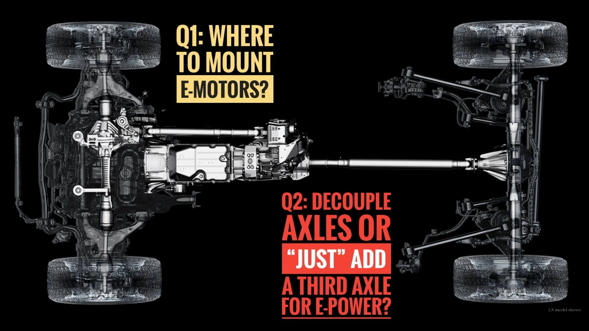

Some “big picture” strategic questions. The more input we can get on this from as many qualified tinkerers/mudders/mechanics/engineers the better, so please share this broadly.

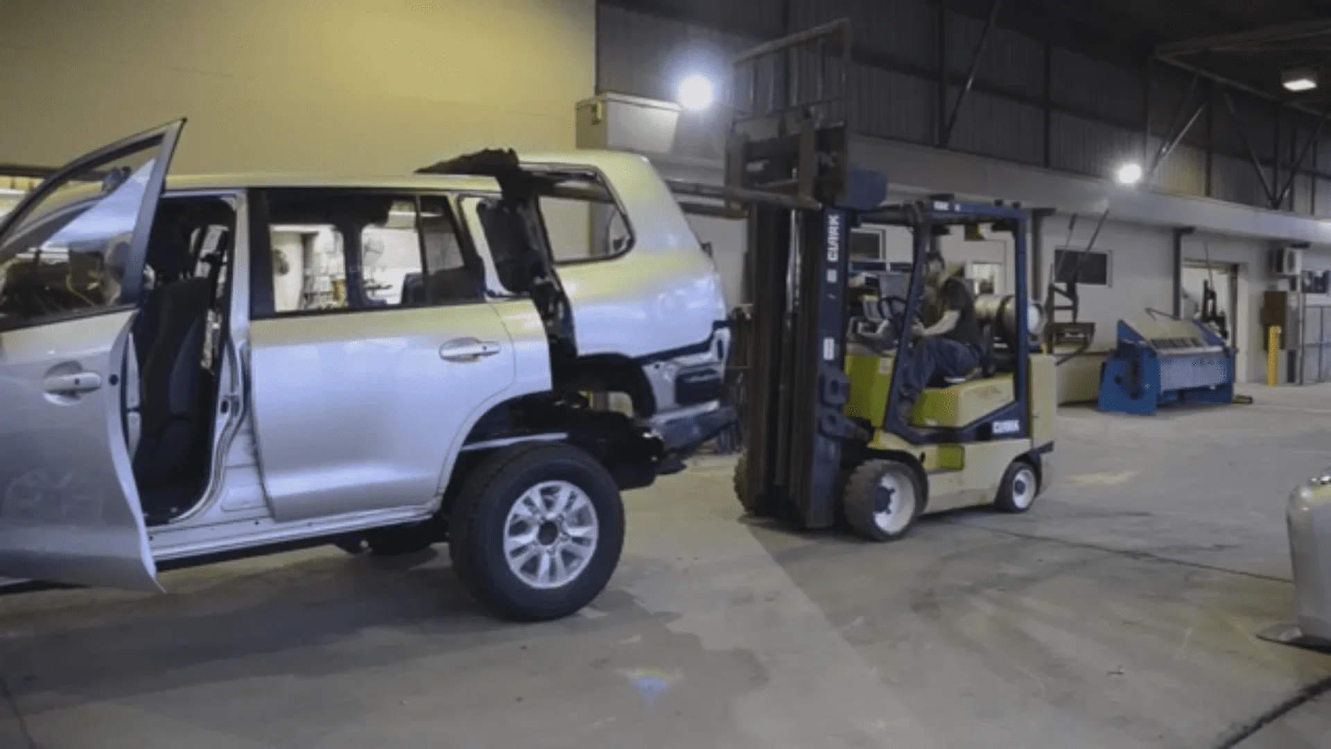

And a screengrab from our Aussie friends at Creative Conversions who seem to take special Down Under delight in chopping up perfectly good BRAND NEW 200-series Cruisers because, hey, they are Aussies and need that extra 650mm, 2 feet, of extra drivetrain/wheelbase/frame for their various “Ute” builds.

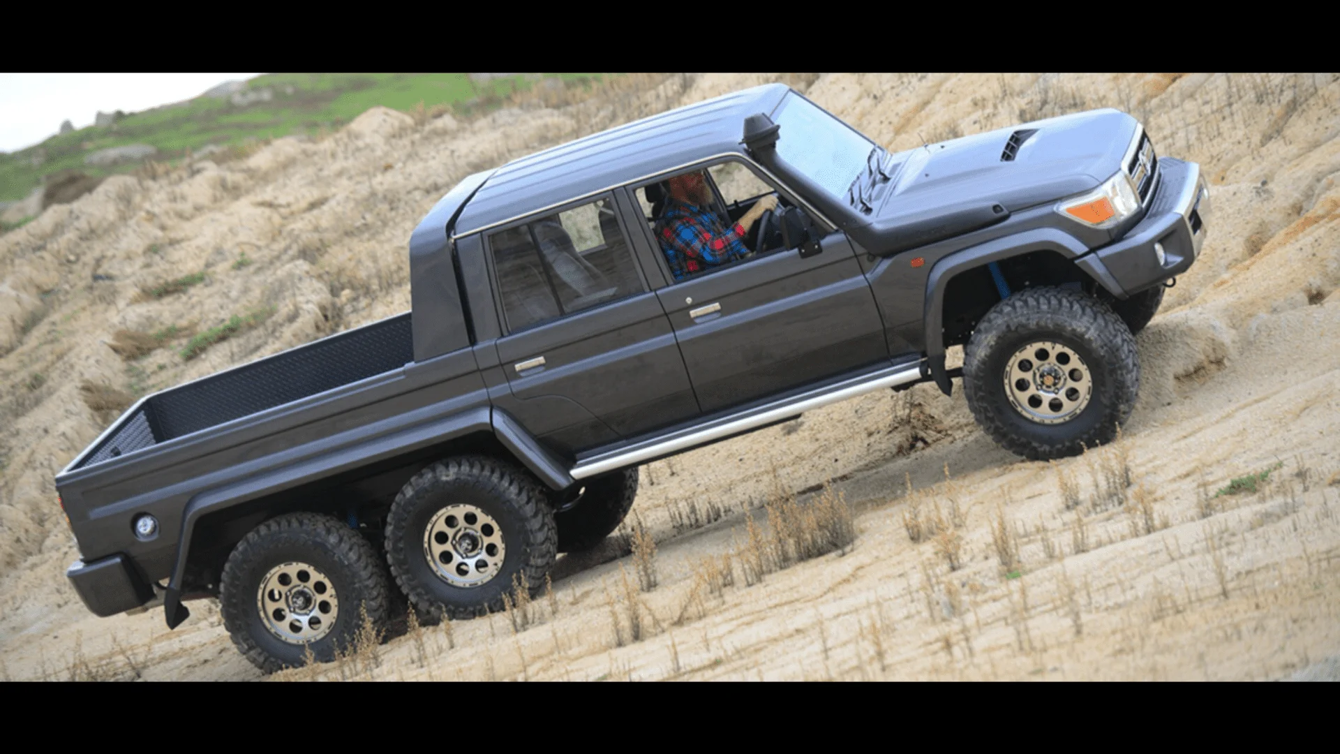

For an idea of 6x6 capability — take a look at this video (
Patriot Campers’ 6x6 Land Cruiser 79 Series video review)
from minute 9:20 onwards. The whole vid is worth a look, but you can imagine the third axle as an independent electric axle adding push and added stability even in some challenging terrain.
For me personally, the 6x6 seems like overkill, but if it’s easier to “just” add on a fully electric axle by somehow figuring out an effective way to disengage the driveshafts on the regular 200 T-Case, so as to not destroy the tranny, then it may be the way to go.
Here’s another visual —
Pros of 3rd independent axle: (1) seems FAR more simple than decoupling the 4x4 and splicing electric motors to front and rear axles, and then somehow attempting to replicate the carefully balanced traction control mechanics/electronics that are standard fare on the 200; (2) original look; (3) more traction on rough stuff; (4) etc.
Cons of 3rd independent axle: (1) added weight; (2) registration hell if you intend to drive stateside depending on state; (3) being pulled over every time you get to new state by cops eager to “learn about your rig” and “educate you about local laws”; (4) etc.
So, for a true overland rig that’s going to be driven thousands of miles on family expeditions, it’s still a coin toss. On the one hand, the extra length and stability are always welcome. On the other hand, the cons are considerable.
