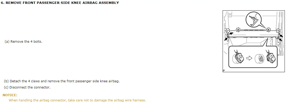

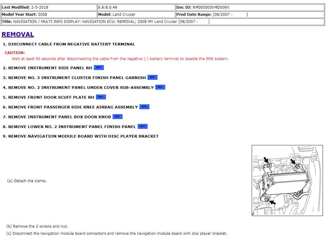

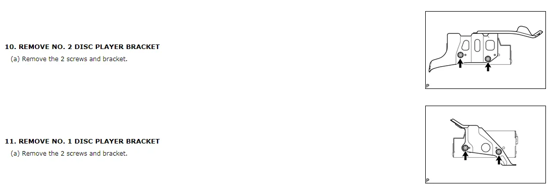

This is the removal procedure for the DVD player. If you need instructions for steps 2 through 8 let me know... I'm assuming they're just removing some screws or tabs or else I would've expected those sections to be broken out.
Most of steps 2-8 are just removing bolts and clips. Step 5 also has you disconnect the airbag connector. Not a big deal, just make sure the battery is disconnected beforehand.
