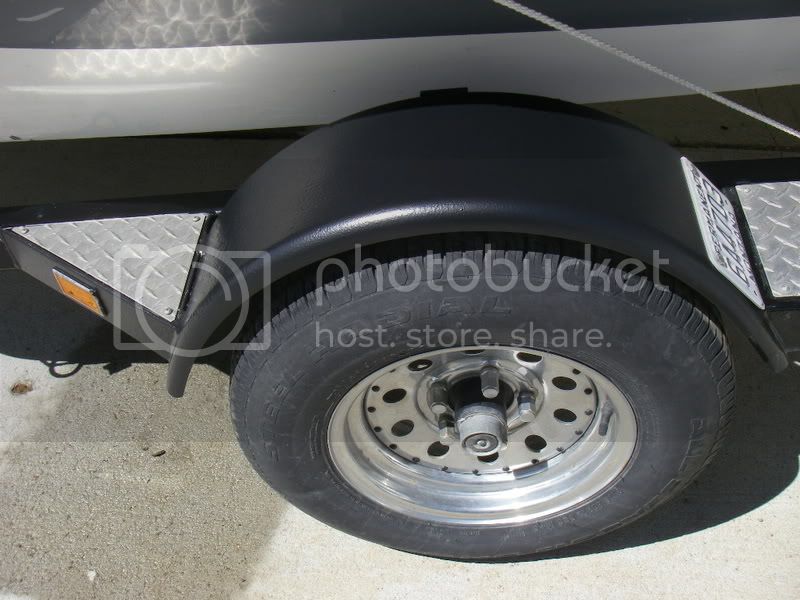

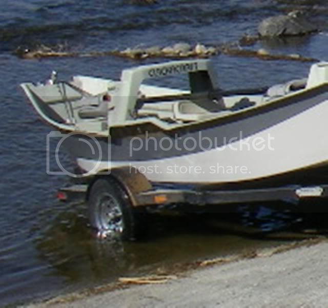

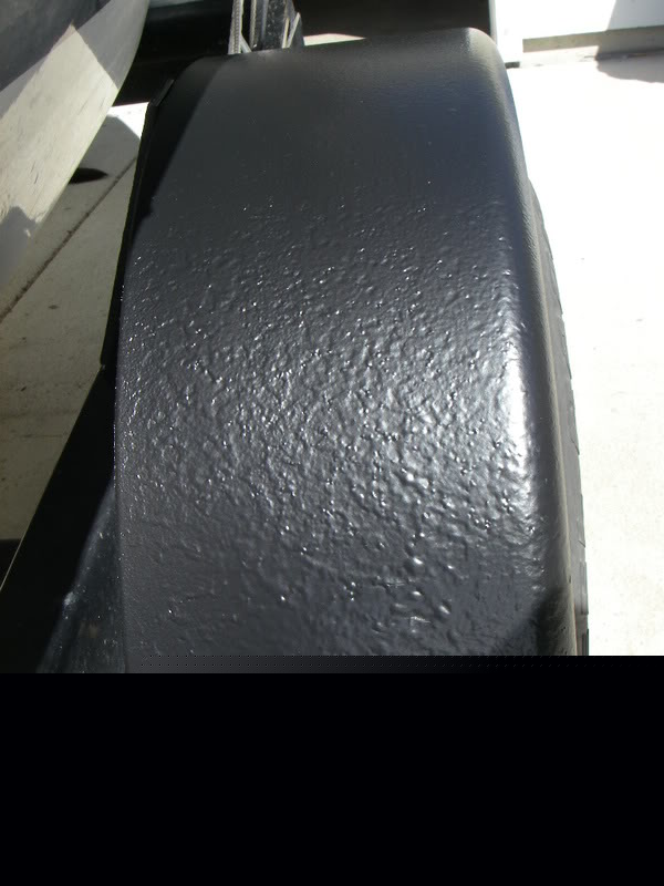

2 summers ago I used it on the wheel wells of my boat trailer. It looked good for a while but once it cures it becomes very brittle and chips easily. Now this may not apply to a truck bed but my wheel wells get peppered with gravel, this has chipped the Duraliner pretty badly. Next time I'll look for a product that stays a little softer. 1 can gave me 3 coats on my wells and leading edge of the trailer frame. Here are some pics:
Wheel wells before -
After -
Most of the texture you see in this pic is from the chipped paint under the Duraliner, it actually cures fairly smooth.
Sorry, I don't have any pics of what it looks like now and my boat is in storage 1.5 hours away, I will say that it doesn’t look new anymore.
