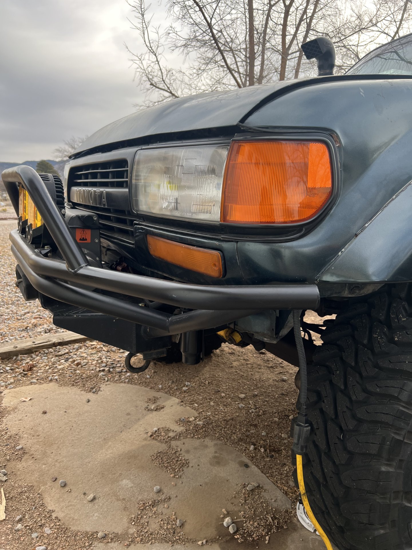

The headlight bulb went out on that side and I had to remove the batteries to get to it. Not a big deal, but did make the project take a little bit longer. Still way worth it to have the two batteries and have them in that spot.
Still need to take care of wrapping/securing the aluminum lines, but they look fine so far after just a few snow-wheeling trips. Still don't want to blow it off...better put it on my list.
