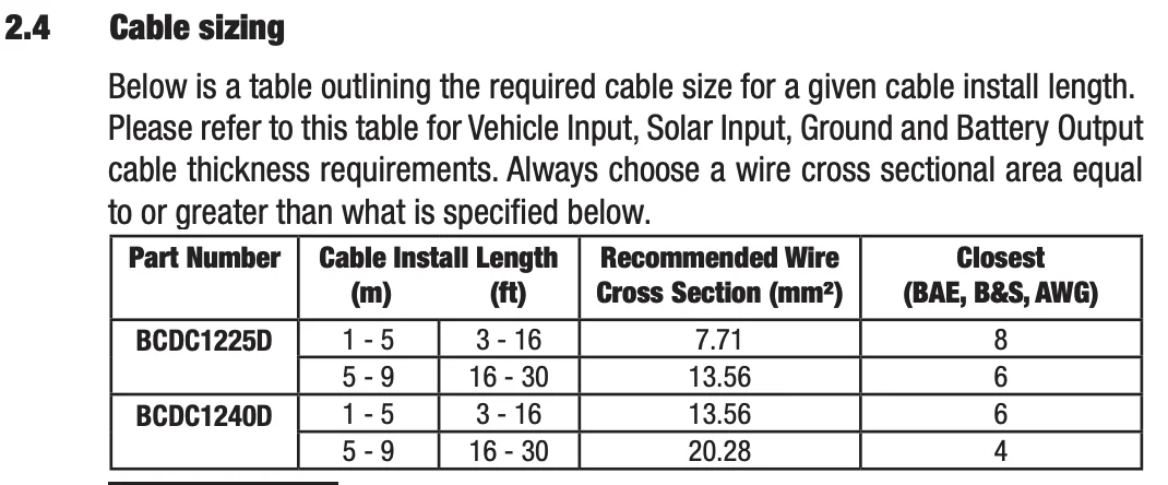

I ran 6 gauge as that's what's indicated in the Redarc manual for the distance involved. No issues that I'm aware of...
Is that for one-way or round trip length? Those recommendations seem ok if that is round trip length. Not so much for one-way.
Even if you can take the most direct path from the engine to the cargo area, I would imagine it would be more than 30 ft round trip, depending on where you mounted the charger of course.
The chart indicates that it's the length of run for each connection on the BCDC; vehicle input, solar input, ground, and battery output. From directly behind the rear seat where my aux battery is located, to just rearward of the engine bay fusebox is less than 14'.
