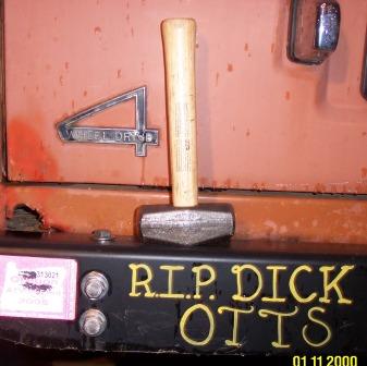

I have a thing for hammers see. I like them.
My 3lb drilling hammer:

Haha, me too actually! My engineer's hammer is probably my favorite tool in the garage; 4lbs still gives you quite a bit of whack but its small enough to swing one handed and in tight places. Plus its the tool of choice for teaching stubborn parts a lesson, so theres a certain phsychological satisfaction associated with it in my memory... :D
[as far as I know engineer's hammer and drilling hammer are interchangable terms, is there a difference?]

:lol: Heck I don't know :lol: . Bet they are. I know that the term drilling hammer is derived from the mining Industry. They used to drill dynamite holes with it and a chisel, but the chisel was called a drill. Not sure but the engineers hammer was used to smack train parts to test for integrity. So the only real difference might be the weight.
