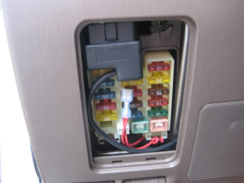

also yoop- I remember seeing in a scanguage thread that some people made a 90deg bracket to remount the OBDII plug in their 80, do you think this could work/clear the fuses with this unit?

Did they use an adapter or was there enough slack to relocate the OBDII plug?
Ordered the OBD to blue tooth adapter. I have owned a Droid since about day one and have always used the car mount too. This will be so nice for monitoring the actual engine temp. I am definitely going to remount the OBDII plug so that I can get the cover back on. Hopefully the bluetooth signal will be strong enough even with the cover on.

I did a couple of searches trying to find that post and no luck so far, but from my recollection they had enough slack.

Bluetooth through the plastic should be no problem unless it's a drastically different transmitter, my radio stays connected to my phone from +20ft away from the truck
