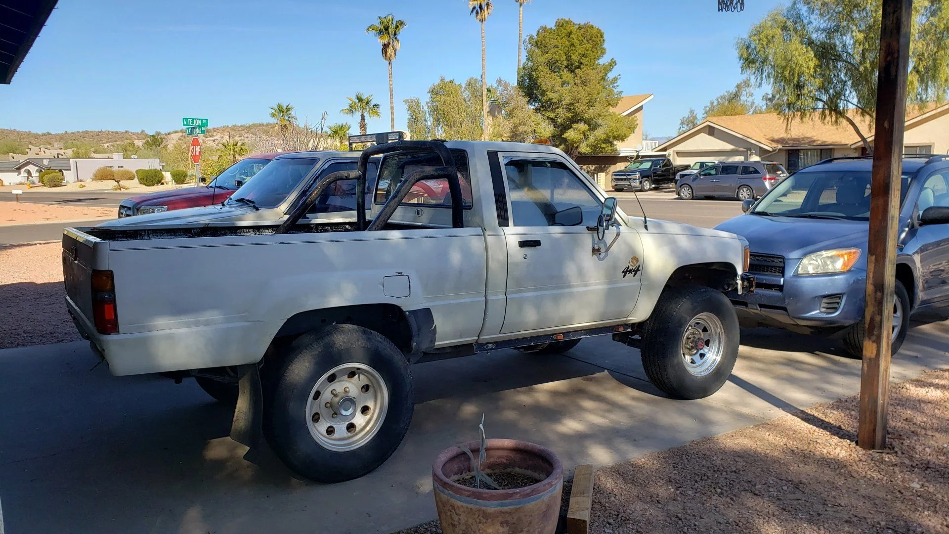

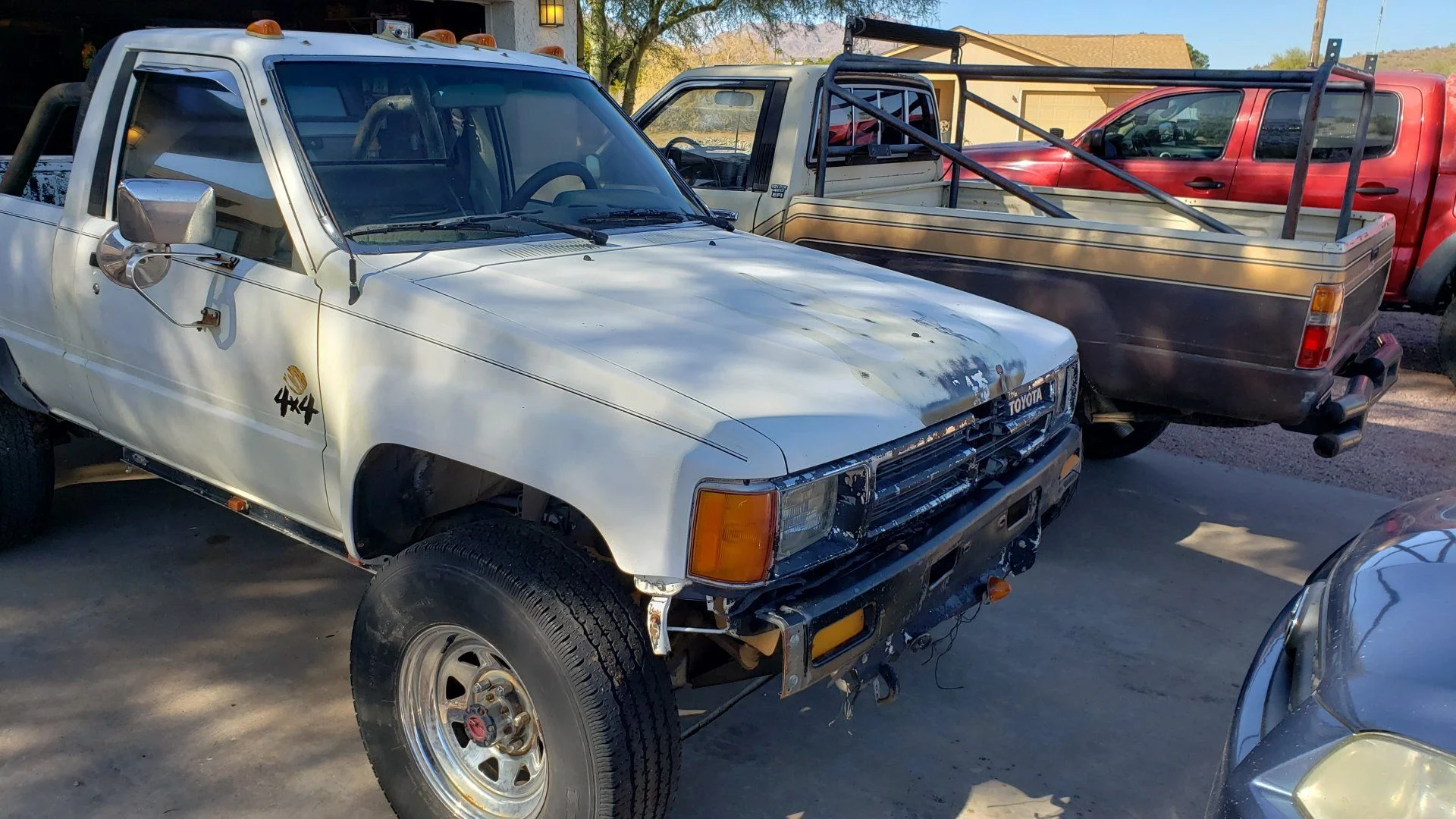

Here's how it sits now

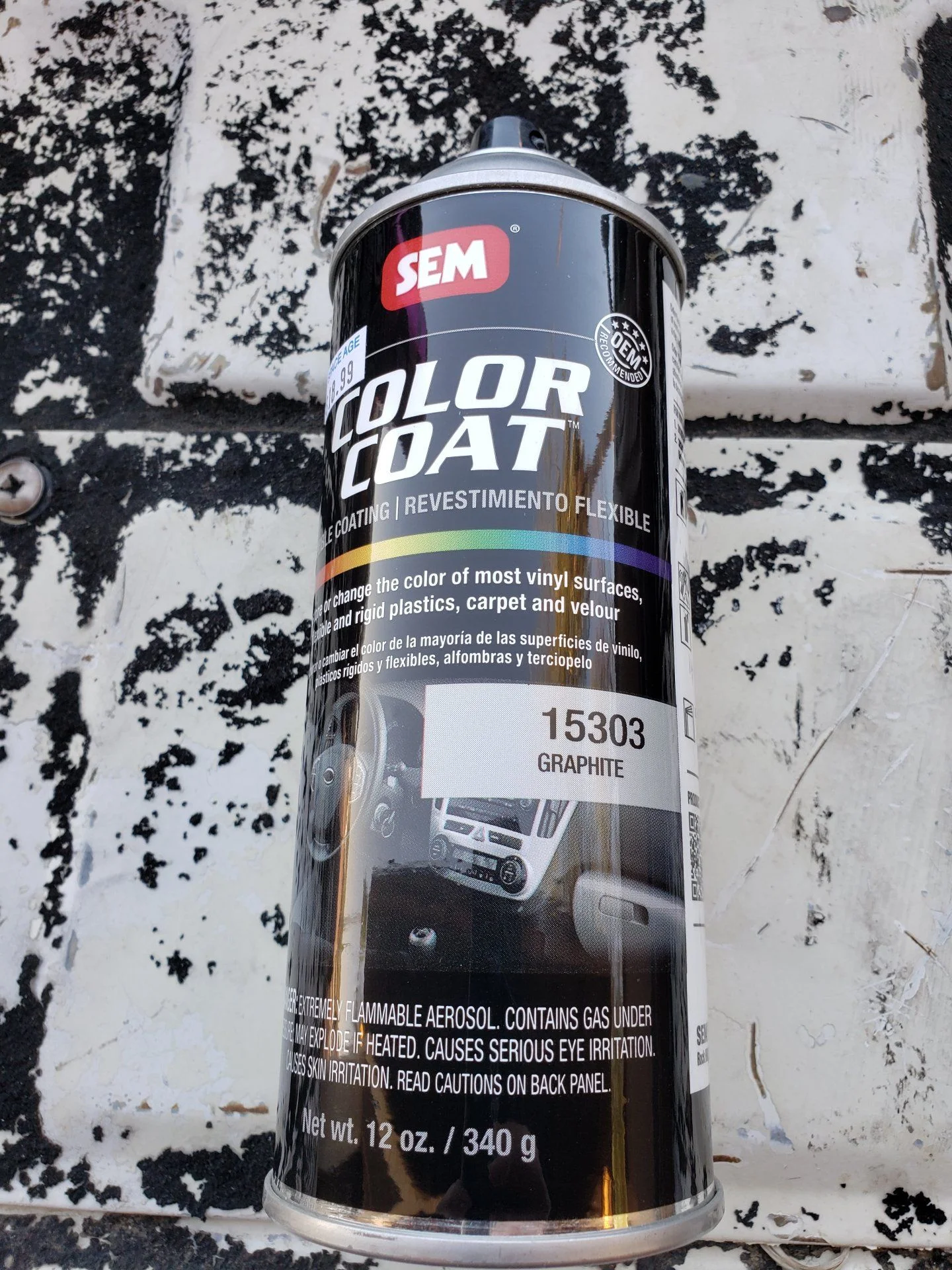

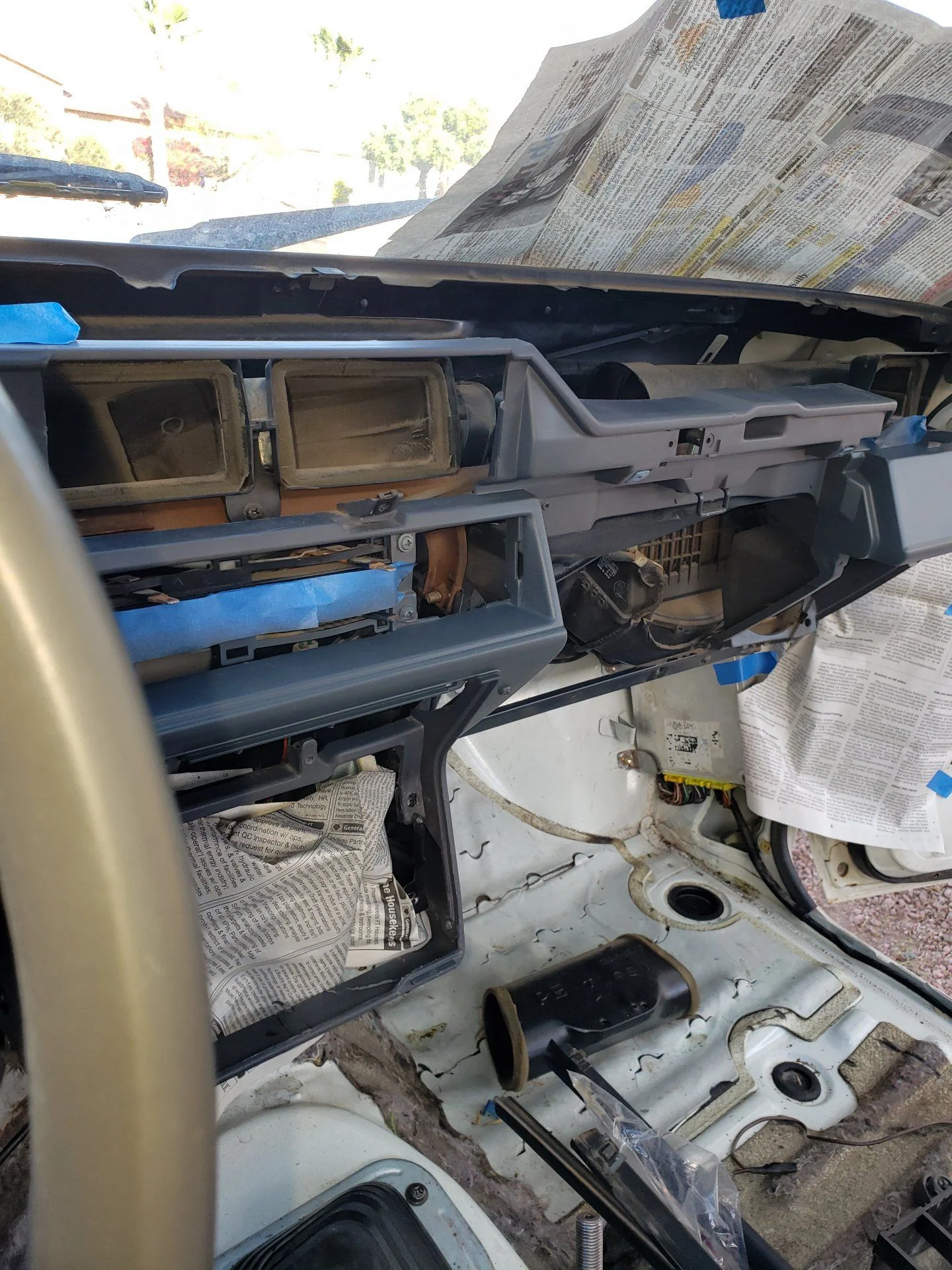

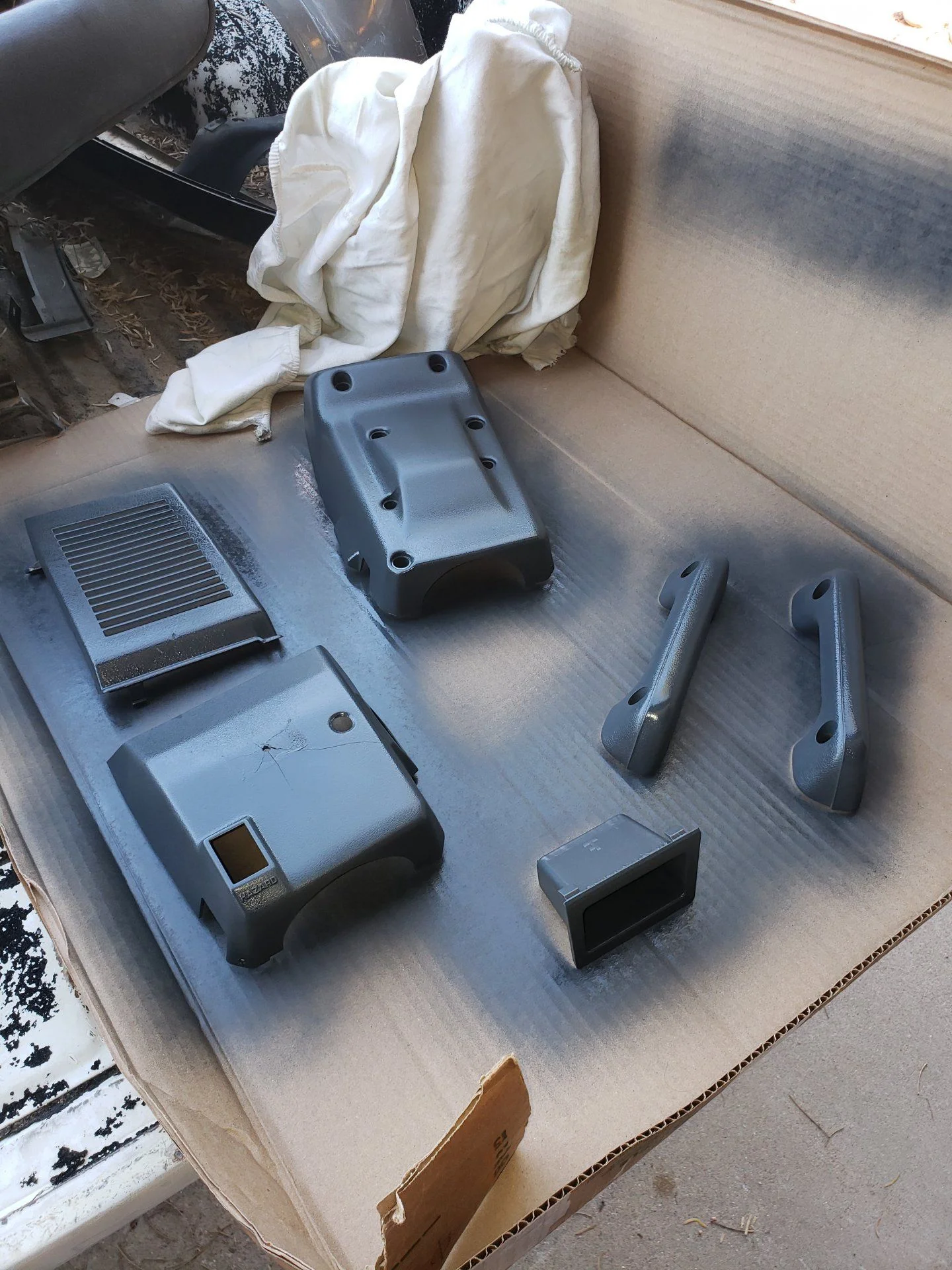

Painting the dash parts has been really easy. Hardest part was finding a close enough color. Another 'mudder had painted his dash with this same paint. I found it at Space Age Paint in Mesa AZ (same place that mixed the Toyota 033 in rattle cans), SEM Graphite 15303. It's a little darker than the original but since I'm painting everything who cares? There are several spots on the dash that need paint, then I removed everything I could and repainted it. Started with a adhesion promoter and then the paint:
These are all "after" pics, I'm terrible at taking pictures beforehand. Oh well.
