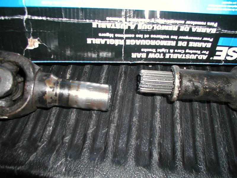

Update: FJ62 slip yoke does not fit FJ60 Shaft side. The splines are the same but the inside dia. of the FJ60 part is smaller than the outside dia. of the FJ62.
Maybe the picture will make more sense. The solid part of the left piece, that slides into the right side, is bigger on the FJ62 driveshaft, so it won't fit into the FJ60 side.

I know its to late now , But could you cut off the steel dust cover and use a shock boot in its place??
Shotgun, yes, was/is an option, but had no way to get that done yesterday morning. I will just get the flanges off the 62 and then put them on the 60 driveshafts.

so how close in length are the 60/62 shafts side by side?
Not close at all. The rear is way shorter on the 62, I guess due to the Auto tranny, and the front is longer, due to the double cardin on the front of my 60. Mine is an 84, so no spacer on the back of the tranny either. That makes it even longer. The splines are the same on 60 and 62, but the rest does you no good.
