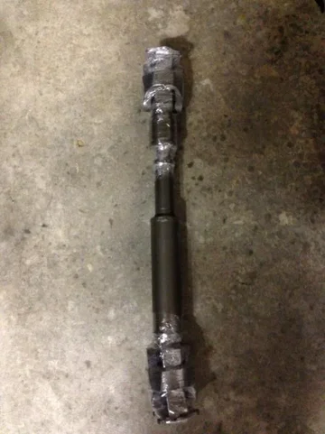

Can't say with certainty, yet, but this should (on paper) be the cure-all for any and all driveline vibes, regardless of caster, pinion angle, or any other front drive shaft related vibration.
Will know Saturday, definitively, if it works in mine.
Is that a double-double DC shaft? Out of curiosity where did you get it?
High Angle. Not for the faint of heart, and certainly not for all front DS issues. It's not a cure all for the common angles, but was successful for mine.
Unsolicited recommendation would be to discuss with Ben Swain at Slee. They've successfully outfitted a front, too.
