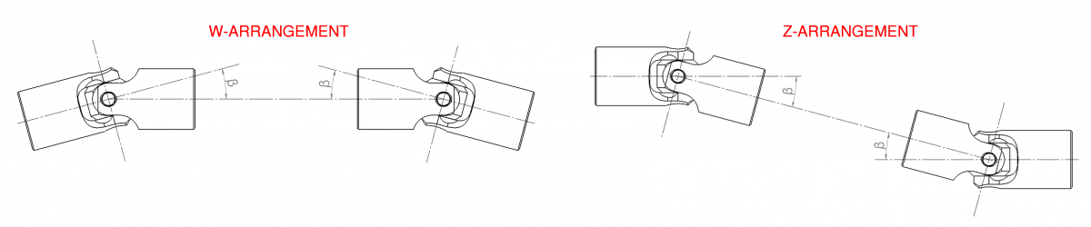

A Important factor with all cardan driveshafts is that you want the same angles on both sides - otherwise you'll end up with vibrations sooner or later due to the fact how a cardan or universal joint is working. Have you double checked that the "Forks" of the actual shaft are in the same plane ?
Just found that after a quick google search.
Phasing is the proper term for aligning those yokes.
The Z-Arangement is what I wanted to describe in my post above.
The W-Arangement can be found on front driveshafts with tilted up diff heads.
Driveshaft alignment diagram
@relaxedcruiser — thanks for all of the information. I feel like I know enough to be dangerous but not enough to understand the nuances of what im dealing with. So my rear drive shaft is in that z arrangement. My two flanges have somewhere around 1.5 degrees of difference. With absolutely no practical experience, but what I have read, when accelerating the rear transfer case will rotate up nearly a degree. This would the. Create a 1/2 degree of difference which I would think would be tolerable.
