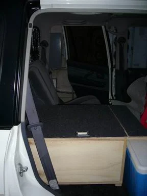

does this system bolt into the floor in any way or is it just "laying" there? seems to be bolted in. any up close shots of that?
the main box is bolted to the floor. you can see the bolts (that haven't been tightened) in the last of the pics attached in the first post.
the portion in the 2nd row is not bolted to the floor, but is bolted to the main box.
Peepers,
As Doug said, the main box uses four bolts in the floor utilizing the bolt holes from the third row seats. I did the same thing with my extension box using the bolt holes from the second row seats. It's not going anywhere!

LOL! Actually the drawers themselves weigh less than the seats they are replacing. It's all the stuff in them that weighs so much, and you'd be packing up all that anyway.
I did the same in my 80 in '06 but will have to tear it down soon because of a new addition to the family (= two Britaxes behind). I screwed that box to the rear drawers and used a U-bolt to secure it through the floor. Your setup looks far better, but I used the space between the box and the door for a water tank and a fire extinguisher that come handy in traveling situations.:cheers:
