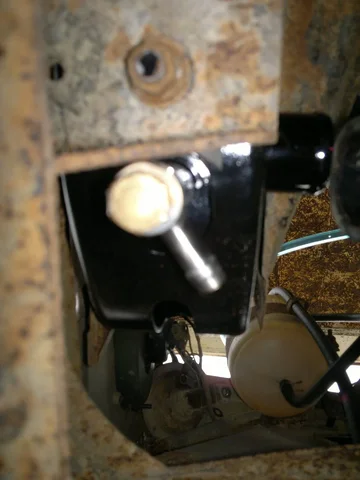

Anyone know where I can get a drain valve that is long like the original? I have new radiator but it has the little brass petcock (or whatever it's called) which makes it virtually impossible to drain.
Something like this:

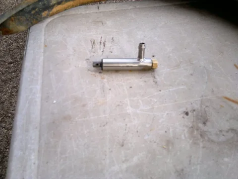

How did you make one? I realize the concept is pretty simple, just not real sure where to begin. Almost seems like a plumbing supply place might have something in brass to work with.
Dang, ok. I will figure something out. I want something similar to what was on the original.
Could a decent machine shop do it you think?
I don't know anyone with a lathe right off. Is it a lot of work to make it? Just want to have an idea of what to expect if I can find someone.
Mine came with a brass petcock which I promptly tore up trying to see if it would work.
What's with the hose end on it? My old one does not have that.
Oh and thank you for going to the trouble of digging out the pictures for me. I appreciate it.
Thanks Sarge. Now just to try and find someone around here to make one.
Sarge, Very nice work. it's hard to see the end that attaches into the base of the radiator. Does it screw in? Is it brazed...
Thanks, Dan
