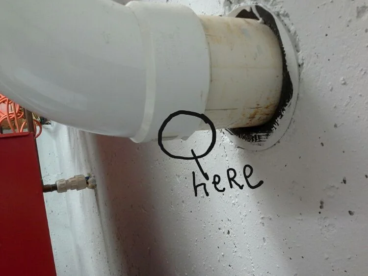

Any suggestions without cutting out section and replacing. It is a very small leak a few dropps a day. I am thinking epoxy for now, any thoughts as to type and how to dry out besides using a heat gun?
If you want to patch it use the epoxy you talked about, but to fix it right...it sucks, but you'll need to take it apart and redo it. Water will find a way out.
Plenty of pipe left to cut off and fix it the right way. Water damage sucks.
Drain from a single sink? Or how many drains on that dump? Vent only? What are we looking at?
