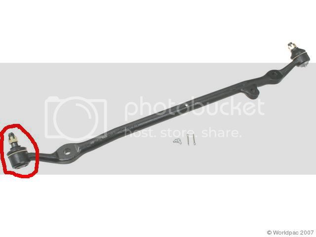

I know I need to rebuild my idler arm, but where the idler arm connects into the drag link is broken as well...it's the post/rod coming out from the far passenger side of the drag link that is broken. It still is connected to the idler arm as it should be (post through the idler arm, locking nut, cotter pin), but the post/rod coming from the drag link seems to be sheared off (on the inside of the DL).
My questions: 1) Is it possible to rebuild/replace that post/rod that comes out of the passenger side of the drag link, or do I just need to replace the entire drag link? (BTW, my 2wd PU is NOT part of the steering recall).
2) if I need to replace the drag link, are there any special tools or tips I'll need to remove/replace the drag link from the Pitman arm, stabilizer, or tie rod ends?

But to answer your question, if I understand it, is that NO you cannot replace that stud. It is part of the part.
Got it. OEM type replacement is like $60, and I'll replace the bushings in the idler arm while I'm in there ($5)...they need it.
