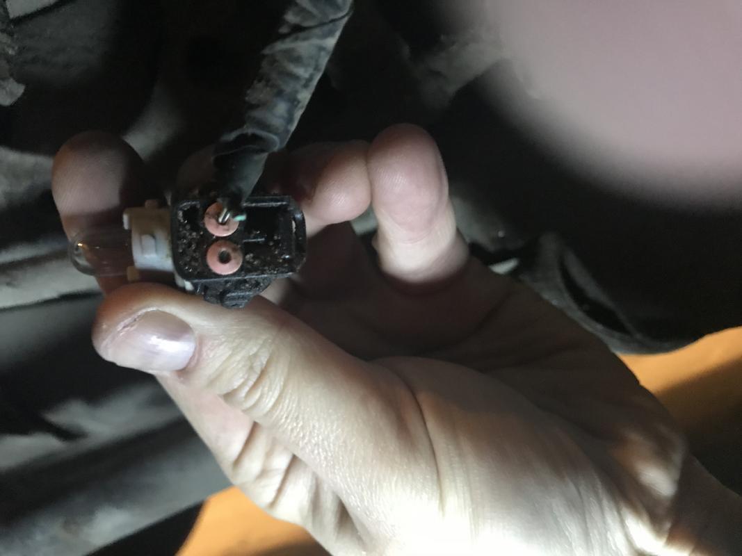

Figured out the issue. One of the wires broke on the connector and I am guessing the other side doesn't work because they are connected somewhere. Ordering a new harness.
Nice job. Mind me asking the location of this connector?
