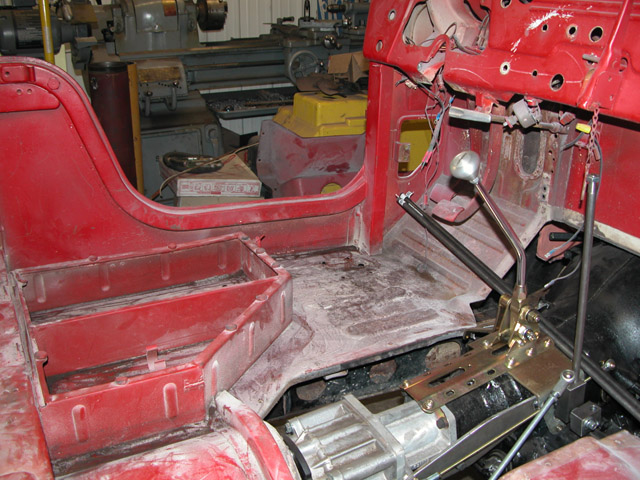

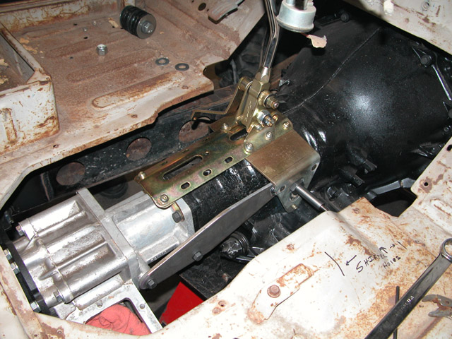

RamJet/TH350/4spd Land Cruiser case project...
I thought that I had a couple more of them someplace...
Same project...with the correct tub on the frame:
Lokar shifter, modified support and pivot mounting plate for the AA twin stick..
The 1962 FST truck had a three speed floor shift trans and tcase in it when it came into the shop that someone had put in at one time.
The Lokar cane passes through that hole in the floor that took a stock three-speed shifter boot.
You could make something very similar and make it function with your bench seat, no problem.
I will try and get you a couple better pics tomorrow...
:beer:
ATS6350C AUTO TRANS SHIFTER TH-350 12"
I think that I am going to need to install a taller cane however...I do not have everything dialed in just yet with this build...
