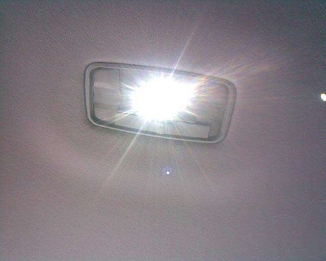

Ok, with the help of a friendly FJC owner I had a chance to test fit one of the new modules in an FJC. I now know the correct length to make the tabs for a nice snug easy to install fit.
Here's some pics to show how it goes together and a comparo of stock candle to new LED technology:
How it fits:
how the lens clips into the fixture:
firing it up to blind the poor cell phone camera:
comparo, led (front) to candle (rear)
Oh, and also found that the LED module does dim - I'm guessing maybe the FJC uses PWM to dim the LED and so the dim effect is fully operational - free bonus :)
How it fits:
