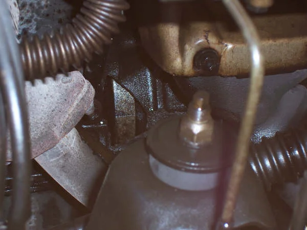

attachment.php
I can't imagine that prices for 1fz's are much higher, but I haven't looked. I'd fix it just to have something to wrench on if I was closer.
