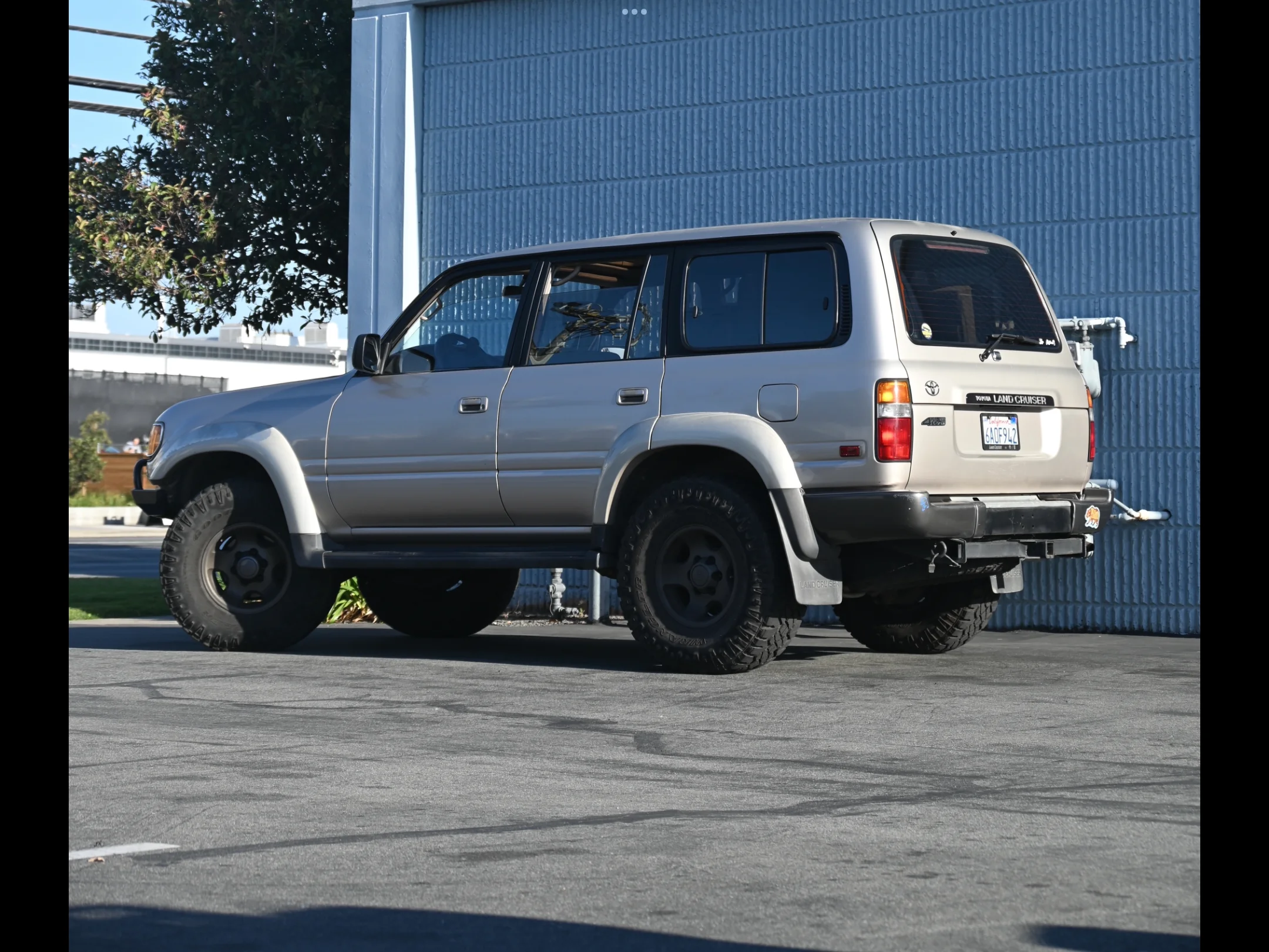

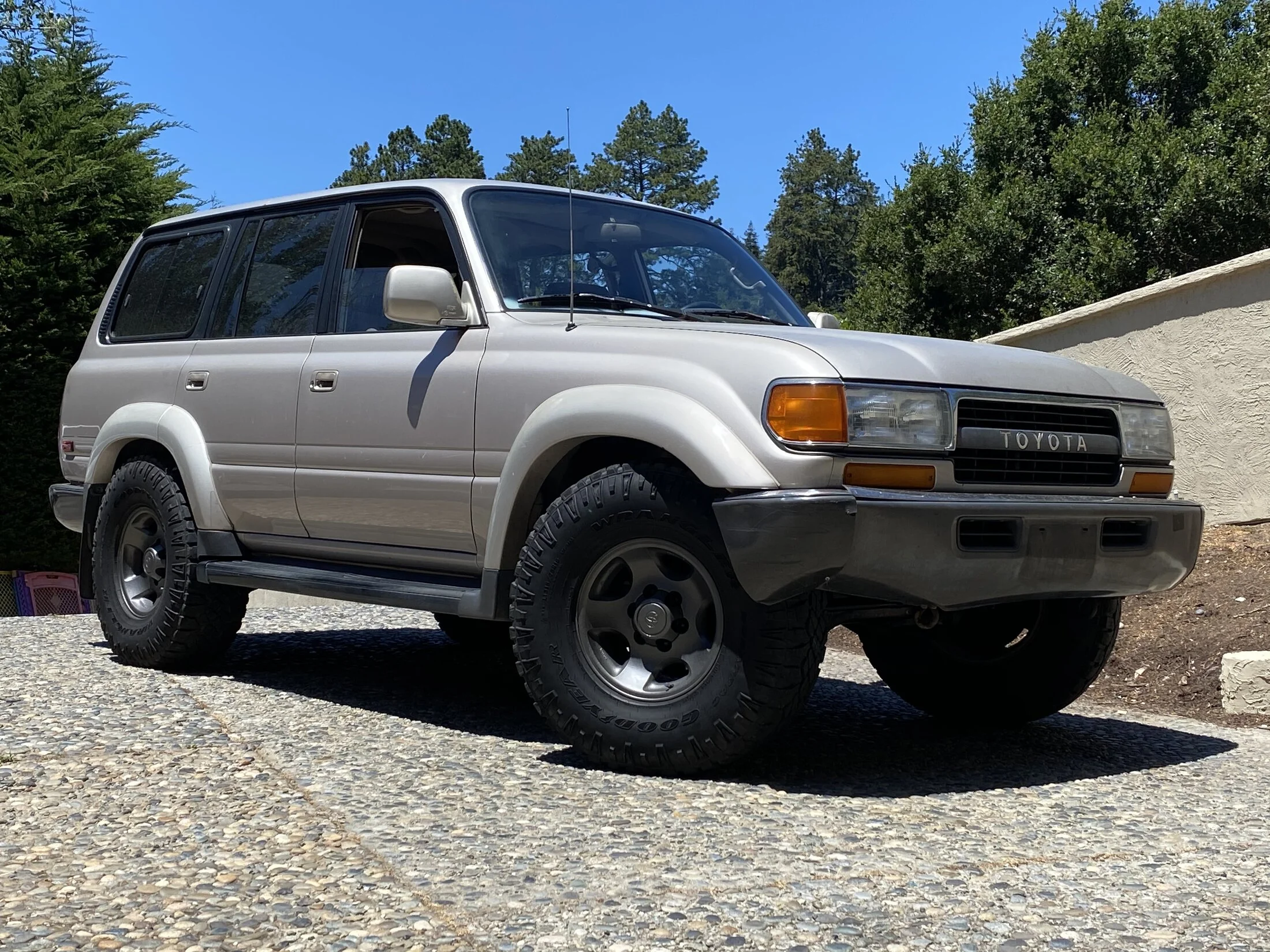

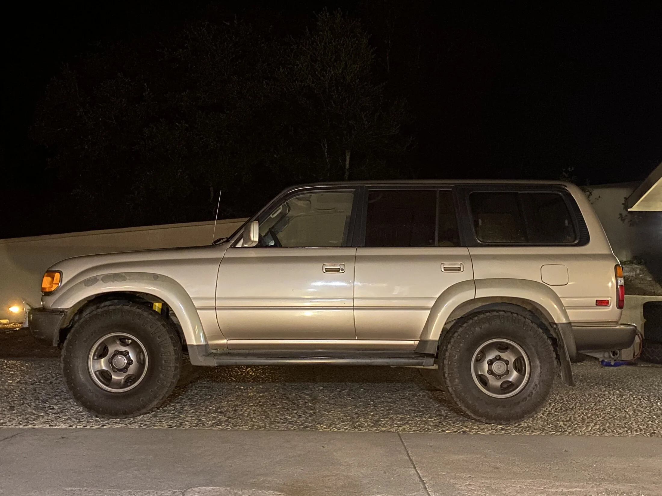

Stock weight stock suspension on 35s
Below 2 pics: stock weight stock coils WITH 30mm coil spacers all 4 corners, 35s (25mm lift over stock)

Below: same as above but added a 100# front bumper and 60# hitch bike rack (~20mm lift over stock)

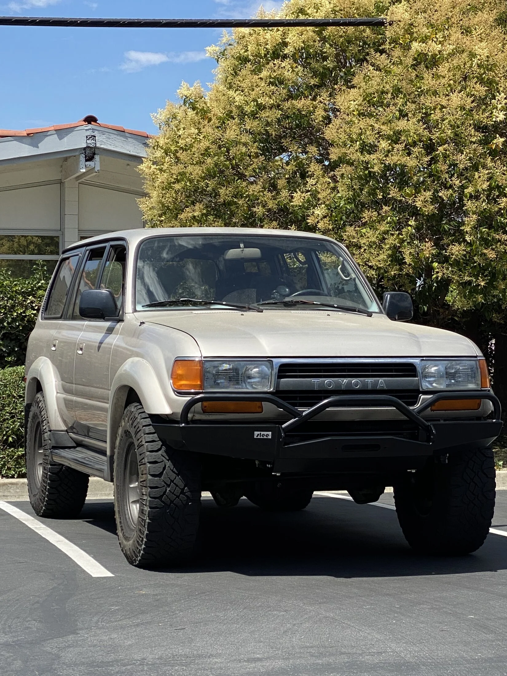

Below: stock weight + 100# front bumper

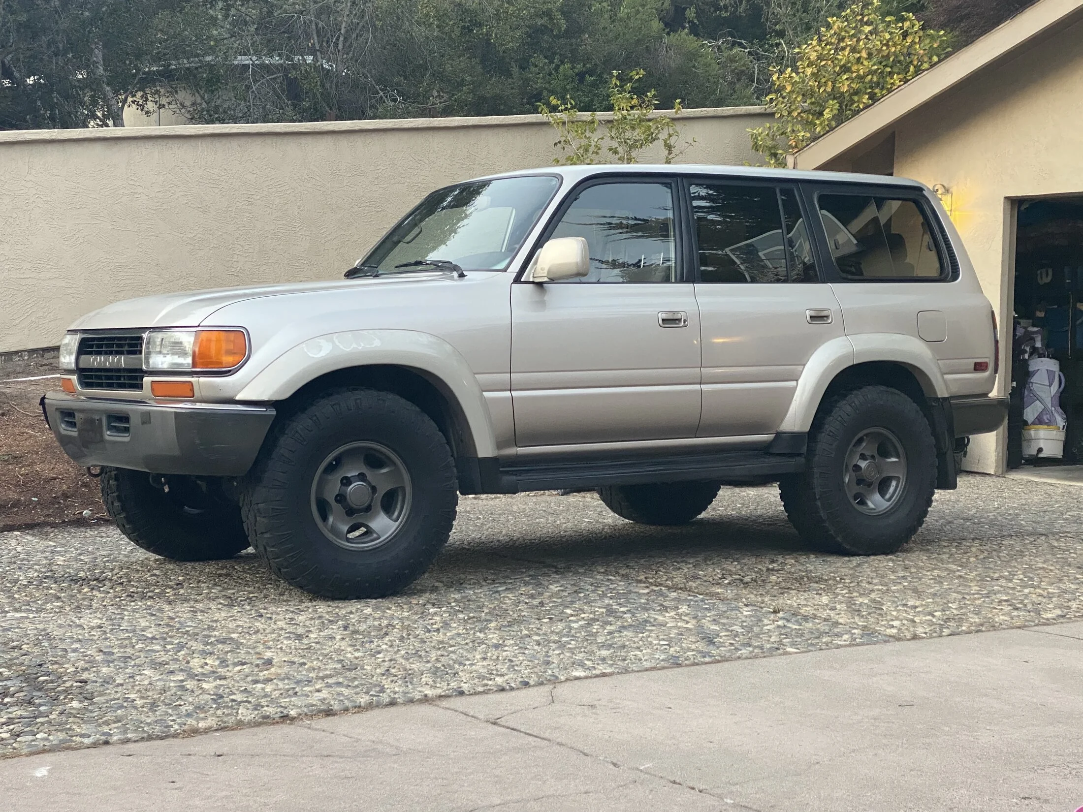

Dobinsons C59-234 front
Dobinsons C59-223V rear
(~1.75” lift in front, 2” lift in rear)
Figured I’d chime in as I went thru this. The Dobinsons coils give a better ride vs the OG stock coils. The 1.75” lift with 35s is perfect for me as I was rubbing alot with any sort of weight on the stock +30mm setup. No caster correction currently. It’s not terrible with handling but I do want to add correction at some point.
