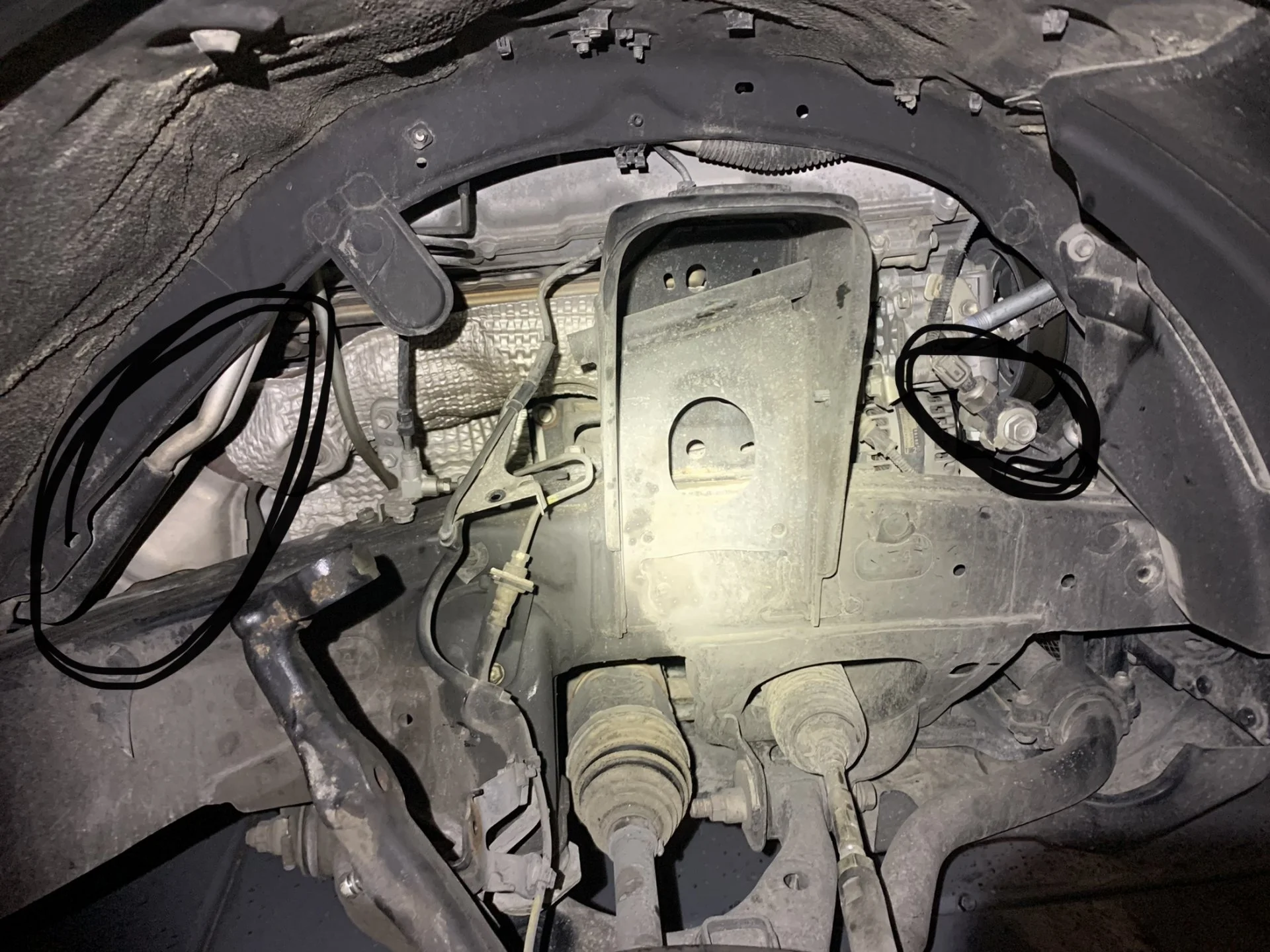

Hey guys so I have a 2010 gx460 w/KDSS and I can’t seem to find where I’m supposed to mount the external reservoir for the coilover on the front right side. The left side has enough clearance aft of the coilover on the frame but the right side has hard lines in the way, and in front of the coilover where the instructions say to mount is some part that doesn’t show up on their instructions can anyone help? I have circled the two things that are preventing me from mounting on the frame.
I’ll check it out, maybe I’ll just have to figure out my own spot. Seems weird that dobinsons has specific instructions for one side of KDSS models and not the other
