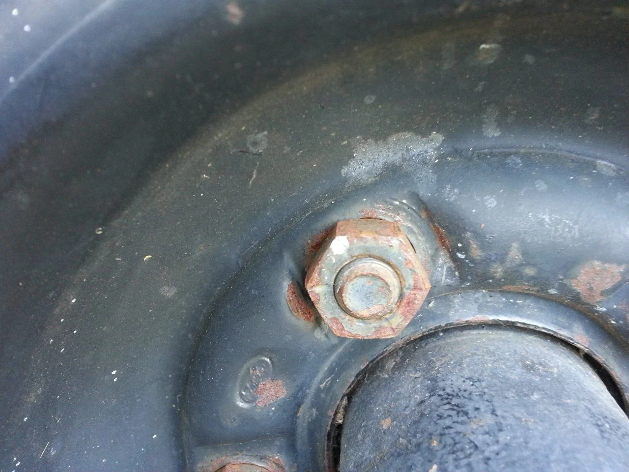

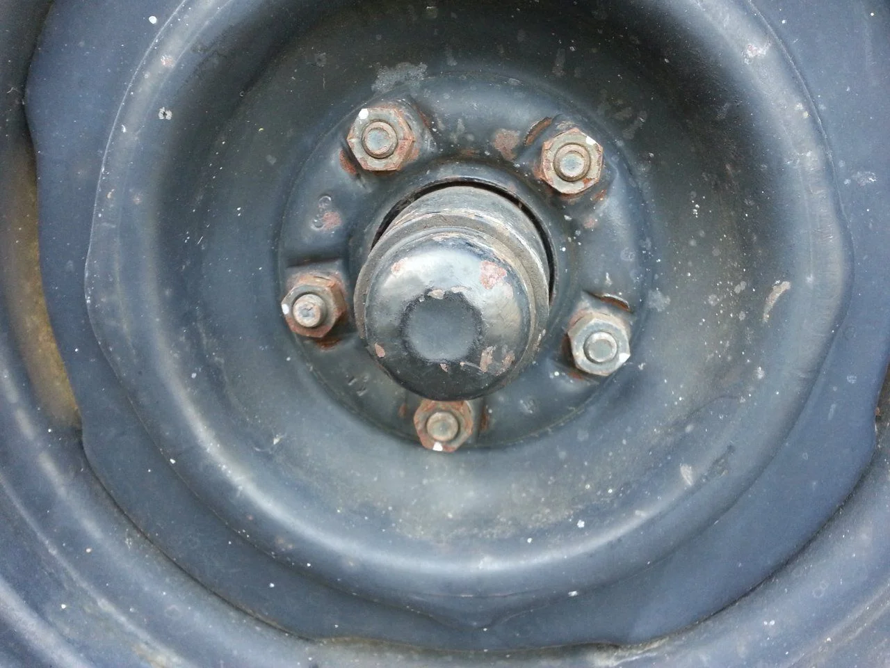

nothing to do with the direction. How about the dots locations? As I said, better not to ask...

Nuts backed off, wheel fell off, now you've marked the nuts so you can tell at a glance if the are loosening? :meh:
smart man!
fortunately, it didn't fall off completely but that was very close. Likely had forgotten to tighten the nuts fully on one side after putting on new tires. But that did a number on the studs so I am checking visually now to make sure the nuts stay tight...
Better to do this preventively though.
Don't know if the nuts would go back to the same position after removal and reinstallation though. So I used an easily cleaned paint.
