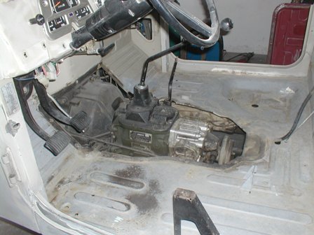

The twist of the motor eventually loosens the bolts in the AA adaptor. I think the poly bushings on those propeller braces don't give enough, like the rubber motor mounts, so the tcase can twist w/ the motor. I'm runnin the SM420/ AA adaptor/ propeller brace on my :pig: & I added the AA support brace under the adaptor - there is a provision for it. You can kinda see part of it right in the middle of the pic. I haven't had any problems w/ the plate style adaptor & propeller brace on my 40.

in a v8 conversion, you've got the front of the powertrain supported and the very rear supported, so everything inbetween in subject to flex and twisting, which causes bolts to loosen up and leak. i used to have to go through my trans/xfer adapter and retighten every six months before i got rid of the propeller and made a transmission mount.

That is a good idea. Did you mount to the tranny, or the adapter (assuming you are running one) between the tcase and tranny. I have the AA 6" adapter, and i think there are some holes on the bottem that i can use to mount to. Just want to know if they are strong enough or if they will twist and loosen like the propeller.

i've got a 465 with a woody adapter (1"). i made new covers for the two pto ports and mounted off of those, but if you've got an area to bolt to on the adapter, got for that. should be simple. the t-case in a cruiser is made to hang.
