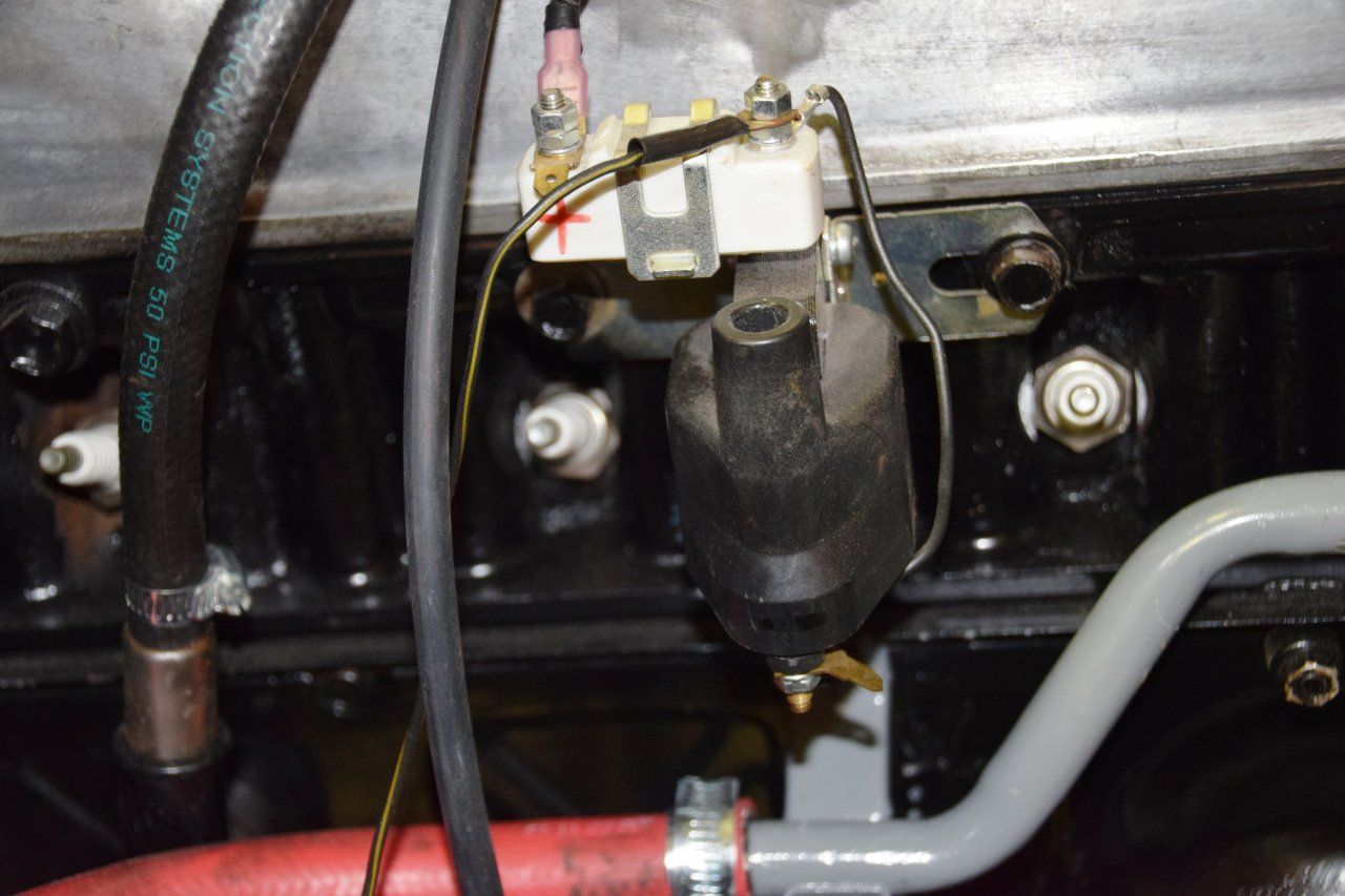

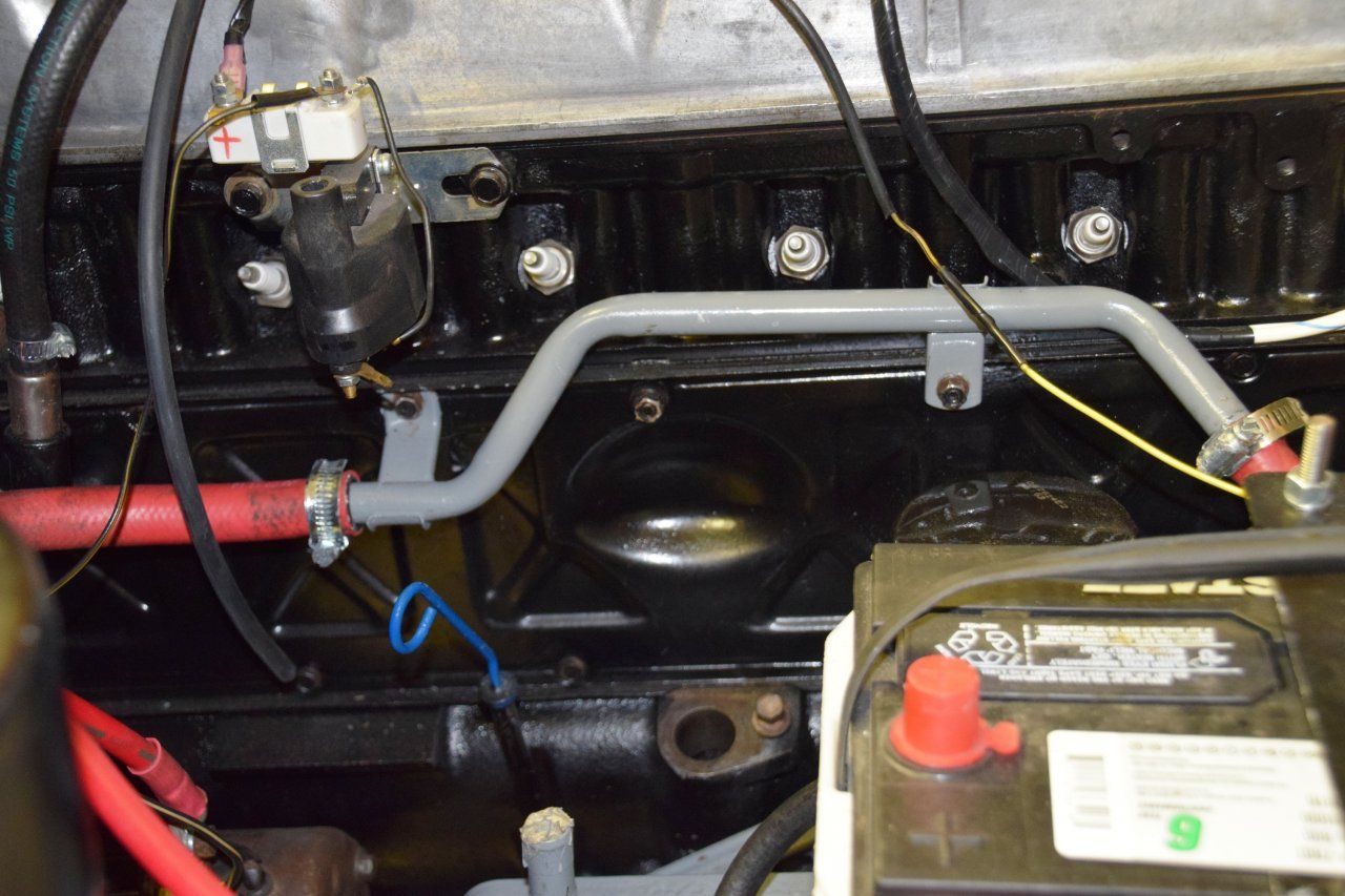

I seized an engine in my 1972 FJ-40 and got a 2F out of a 1985 FJ-60 as a donor motor. Long story short it has been a long journey to get the engine rebuilt, correct components fitted to it and the final steps to get it started. My next step is to get the distributor installed. I have read numerous sections on dizzy installation but still have some questions. Question #1 is a 2F Large Cap distributor better than a new distributor with electronic ignition? Second question is I can not get either distributor to drop in, the old one or the new one off of my F engine. YES I have checked to make sure the slot is lined up. Any suggestions? I am a bit frustrated at this point and really am hoping someone can help. I attached a previous thread that seemed to be the same problem I am having. I have included pictures for reference. Any help is appreciated.

If you are using the 85 fj60 dizzy you will need the ignition module for the dizzy, this was usually on top of the coil on the fender, your setup doesn't have this ignitor. You may have to use that new dizzy with internal ignition regardless.

When I installed the '86 2F into my '77, I used a Trollhole dizzy and the original '77 coil & ballast resistor, but disconnected the OEM igniter.

Looks like you may have a pertronix electronic in the small-cap dissy. Either dissy will work, but will be connected differently. Both of those distributors are very good. Make sure the vac advancer on the large dissy is working.

You absolutely can use the points style Dizzy in a 2F.
The igniter won't be used tho and you will need a ballast resistor as well, so the wiring will be different.
