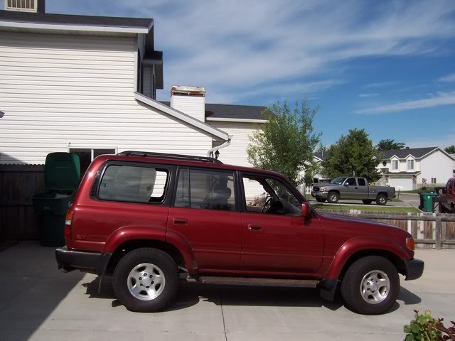

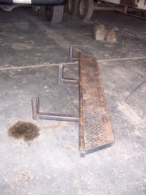

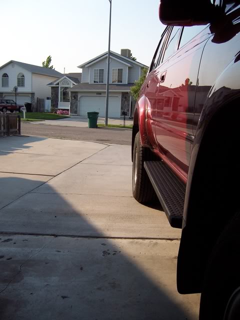

My Step-Father and I built some Sliders for my 80 over the 4th of July. Just thought I would post up some pics of the project. Enjoy.
Driverside, rear tacked on:
Driverside, front tacked on:
beno said:
Lookin tough!!
Have you dropped the full weight of an 80 series on them yet? How did they hold up?
Not yet. Planning on hitting some trails this weekend to "break them in". Test out the lift & the Slider's! :D:D

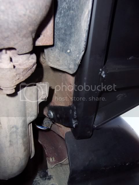

Do you have any more shots of around the cats?
Nice work.
IBCRUSN said:
Very nice! I like the ability to remove them if need be. I'm sure you will get comments about the one bolt per mount but I think you did your homework. There really isn't much load on the bolt when your on the slider, it is transferred to the mount nicely.
Nice work.
I dont, but I will take some and post em.
We actually didn't go around the Cat (single on mine). We figured we would just be taking away from the clearance of the frame if we built a mount around the Cat. because we built everything out of square tubing. This does leave the Cat. unprotected though. So its a trade-off. I might add a piece of flat iron in the future to protect the Cat.
The Passenger Side Slider has 2 mounts (rear & middle) just like the other side. Then, the front mount actually is mounted to existing holes that appear to be designed for a running board. The front mount point is technically on the body, but it is right where the body attaches to the frame, and appears very stout.
Hopefully this is not a big issue. I dont think it will be.

Pic's around the cat as requested.
Wow!! That's a huge pic. I like the tie in with the body. Keep us posted how it holds up after a few times of hammering on the slider. It was difficult to tell from the pic but it would be a good idea to use at least 8.8 hardware. It will be interesting to see how the captive nut in the body holds up.

BUT...there is a small "feature" that was discovered. It took a mechanic to help me diagnose...but here is basically what happens:
The bolt that connects the PS Slider to the body where the Cat. is in the way...causes a slight issue with the flex of the frame compared to the flex of the body. I basically started noticing a "boing" sound when I would drive in situations where things normally flex. So what seems to happen is the body is slightly forced to flex with the frame because the Slider is connected to both frame and body.
Long term effects? Probably none is what I would think, and that is what the mechanic thinks as well. You could probably also just put some sort of rubber washer or grommet on the bolt that attaches to the body, and it would probably go away.
