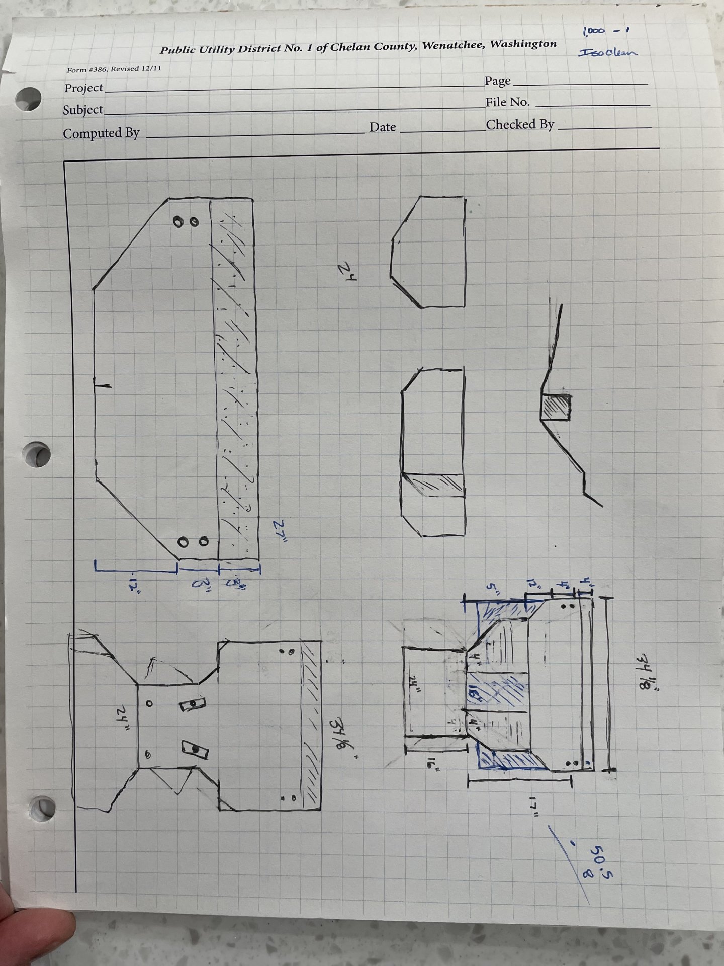

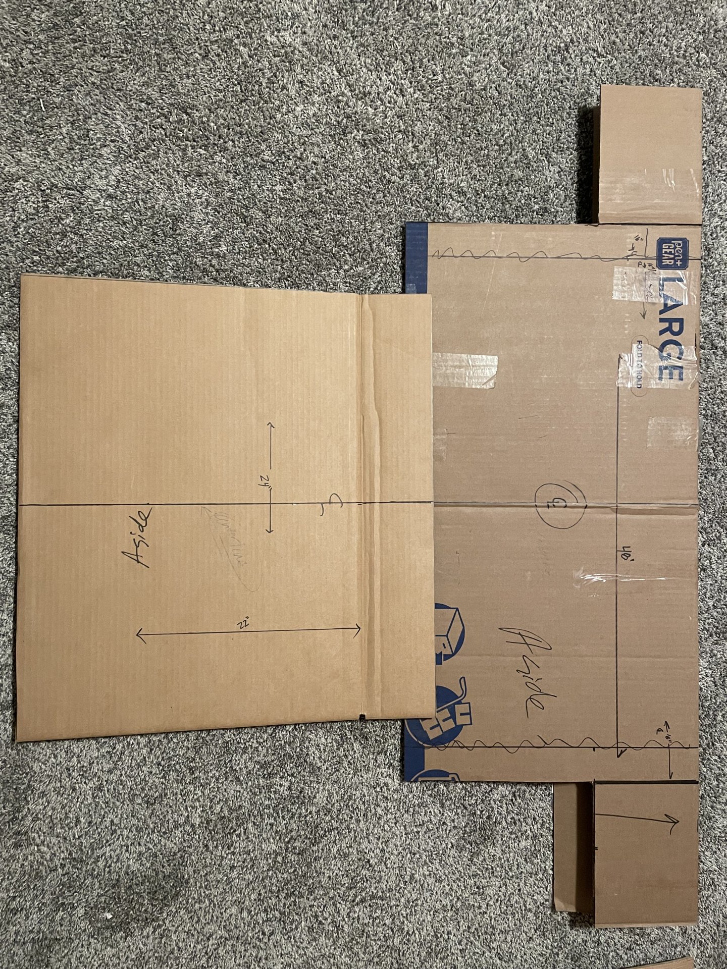

Been loosing too many hours of sleep thinking of this build. Finally got some cardboard to start mocking it up!! Woohoo!!

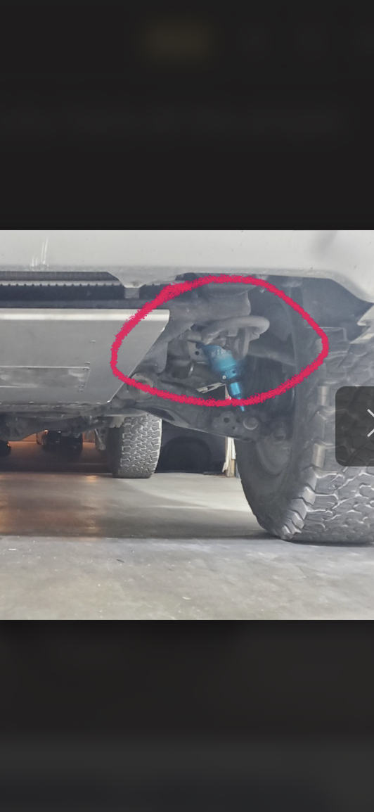

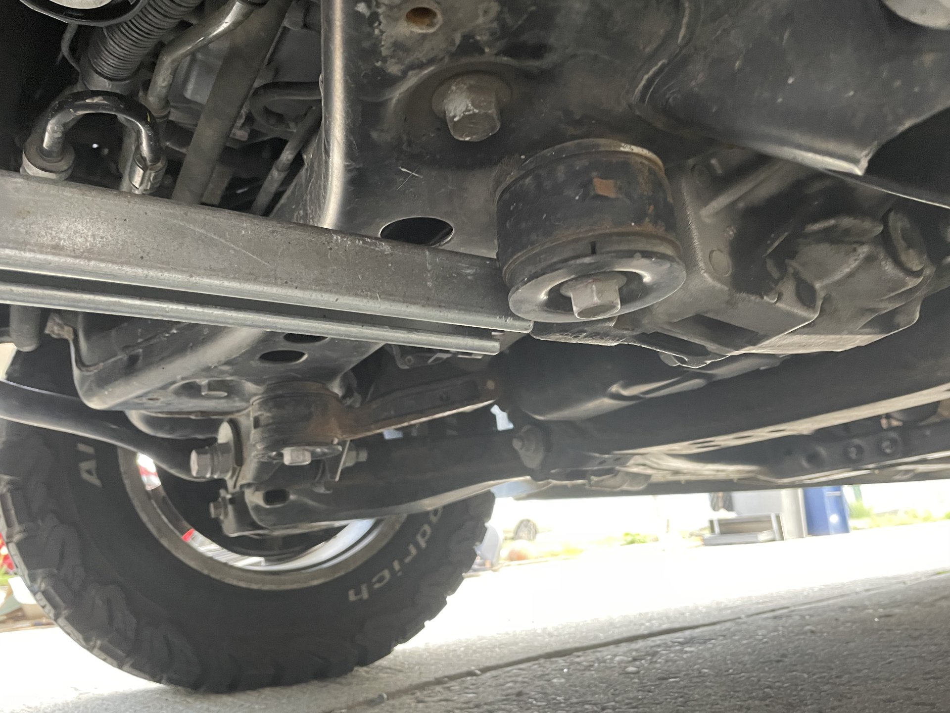

It may be a moot point, but my intention is to provide a little more protection to this area here:

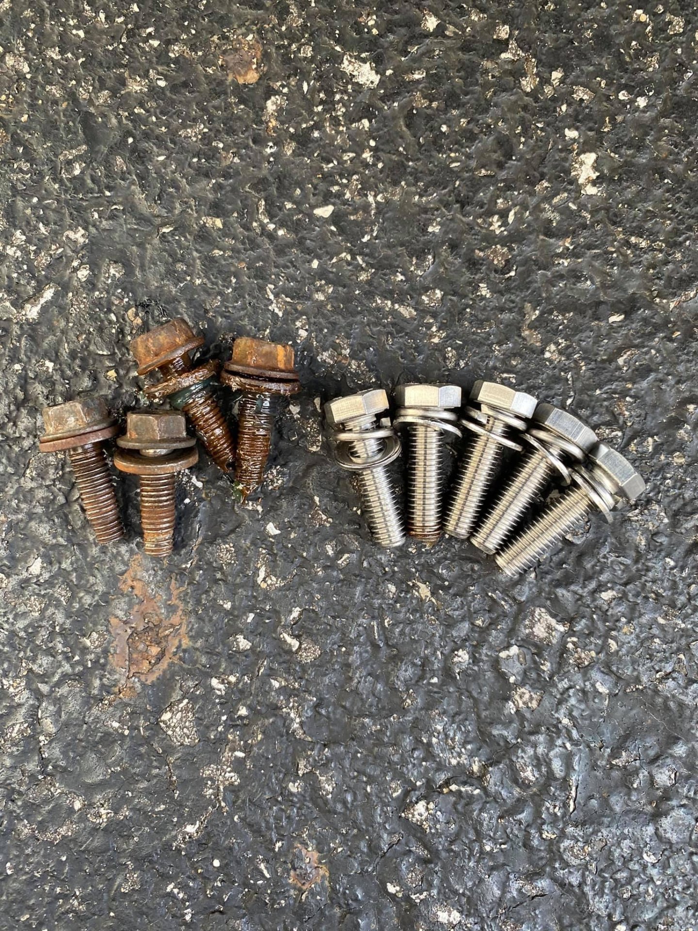

Yes, I'm using these:
Kind of hard to make a hex hole by hand, so you can use these:
If using the round ones, I would recommend getting them with a "wedge head". They have little teeth on the head that dig into the base metal, which help them not spin. part number example: AELS8-420-260W (1/4-20 thread with max material thickness .260", wedge head)

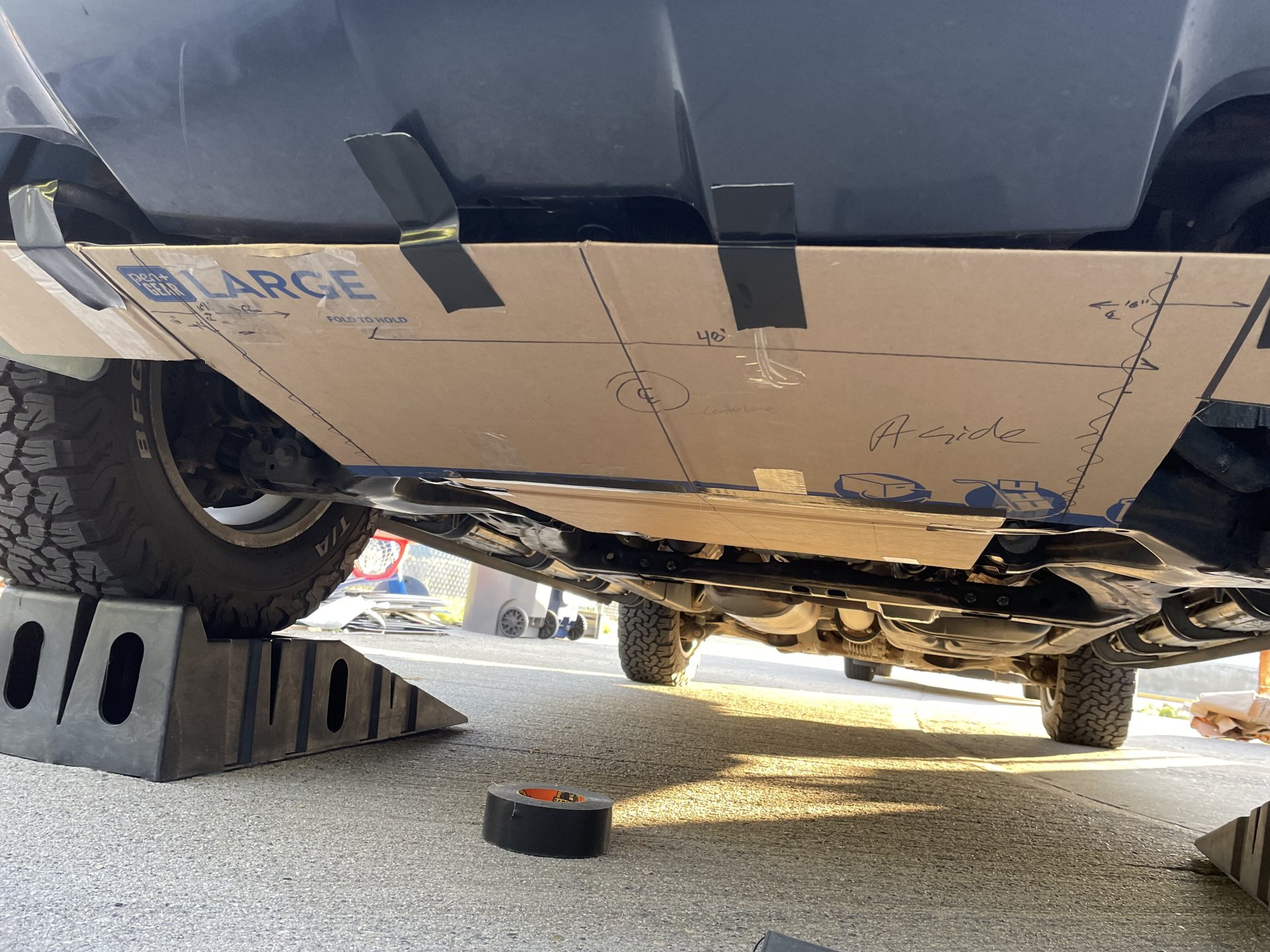

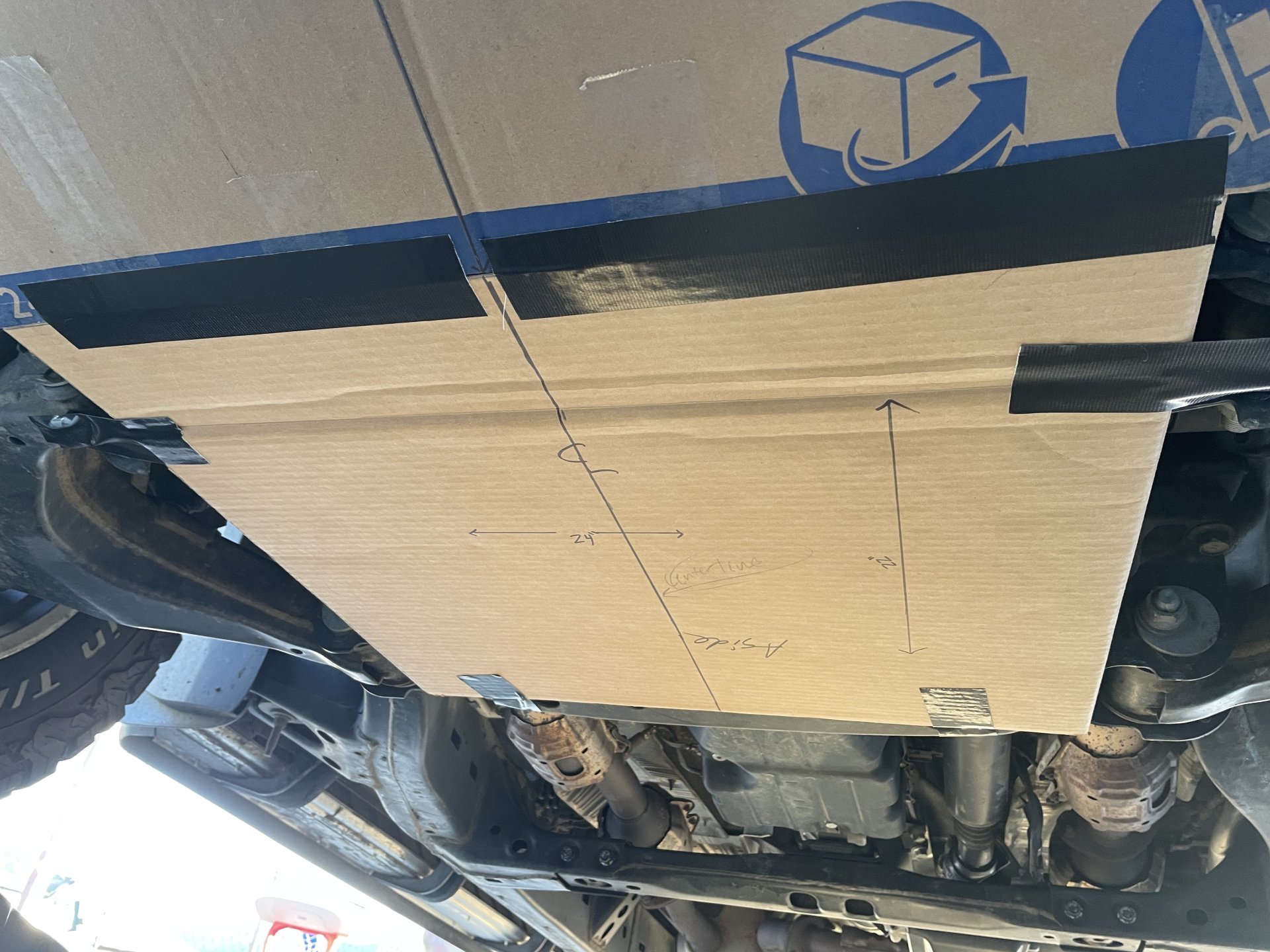

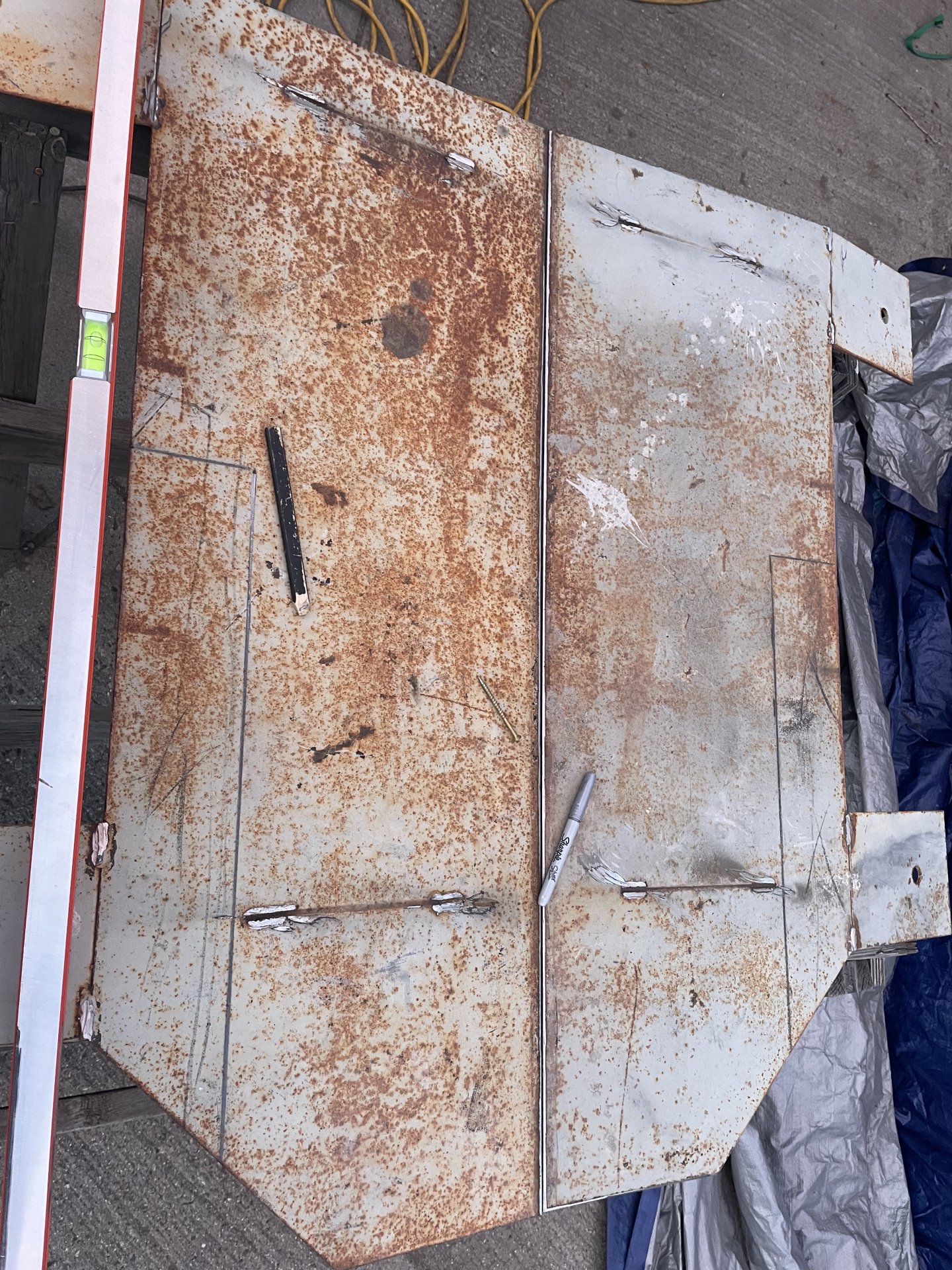

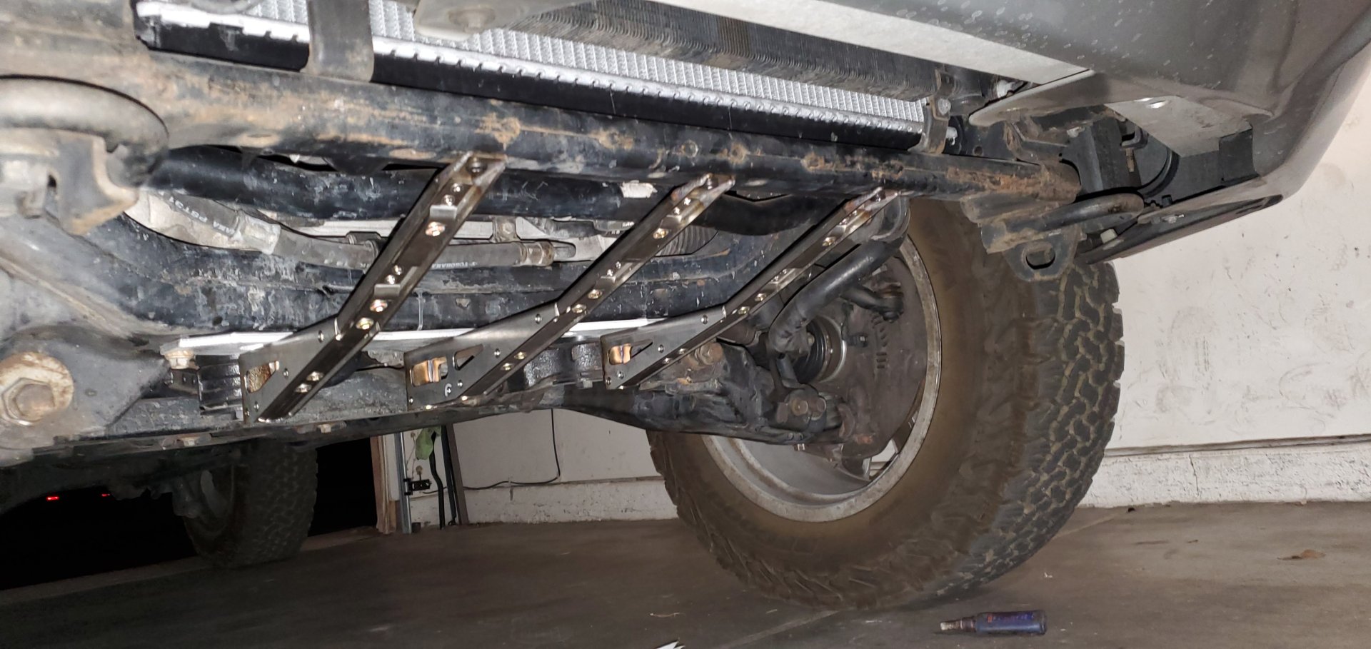

I got some time under the truck tonight to work on mocking up the skid plates. I’m pretty stoked with how this is going to look!
If you need ¼" steel plate under your truck, you must be planning to drive like a f'n retard. That is way overkill on anything other than a dedicated crawler.
Well, I don’t plan on driving like a retard. I know it’s overkill. I’m not even 100% sure if it’s really 1/4” - might be 1/8” now that I think about it. I haven’t officially measured it. But regardless. I know it’s over kill. I plan on drilling a lot of holes to lighten it up as much as possible.
