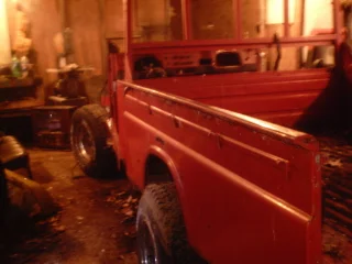

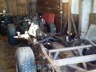

i an restoring my 76 fj45 and here r some resent pics

First thing I'd ask is this: are the drums in good working order?
How do you plan on using your truck?
