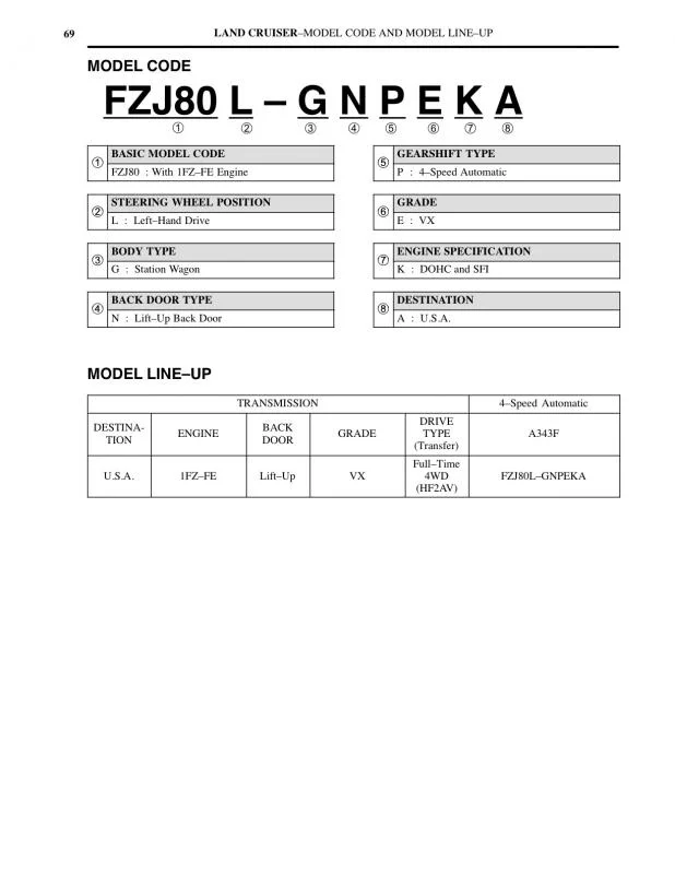

C/TR 6M1/LB10 A/TM K294/A442F FZJ80L-GNPEKA

The "P" in the 8th digit comfirms the 93 model year. It can change from manufacturer and year to year on the month that the next model year will come out. Mostly mid-year change over even though some recent major facelifted Toyota models even were produced very early 2009 were sold as 2010 units.
The DOFU (date of first use) from the dealer can tell you when it was sold if you are curious.
C/TR 6M1/FF40 is your colour code (6M1) and trim code (FF40).
A/TM K294/A442F is your axle code (K294) and transmission code (A442F).
FZJ80L-GNPEKA is explained below.
