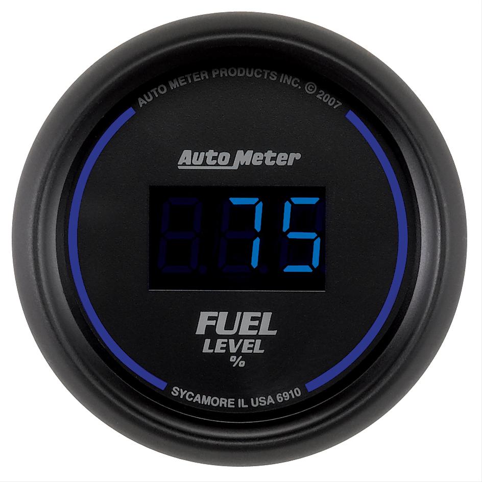

Has somebody smarter than me ever managed to install a digital fuel level gauge? I like the idea of a digital gauge to get a better feel of just how much gas is left and level at which the light comes on seems to be all over the place.
I found this programmable Autometer gauge
http://www.summitracing.com/parts/atm-6910/overview/
Would it need a new sending unit? http://www.summitracing.com/parts/atm-3262
And another brand that actually has a gallons remaining readout
http://www.summitracing.com/parts/cyb-a034e060n/overview/

Given the manual for the autometer says it supports a custom mode where you calibrate it with the tank empty and tank full - I can't see why you would need to replace the sender...

I think I just answered my question. Per the FSM, the range on the factory sender is 110 ohms empty and 3 ohms full. I'll have to see how hard it is to program these gauges and if it's as simple as plugging in the ohm range...
