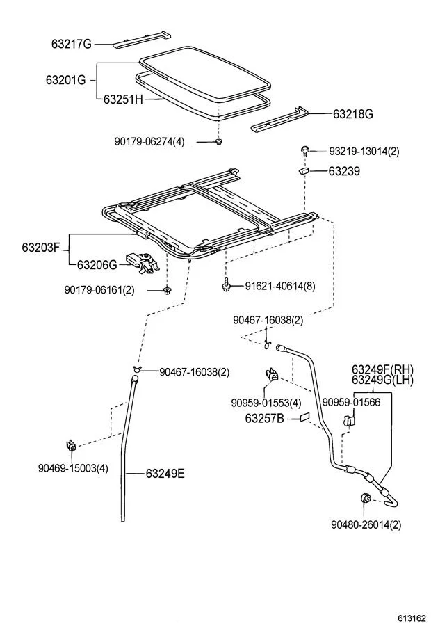

Glass gasket. Possible it's not centered or sitting too low, you can loosen and adjust slightly but more then likely it requires replacement after 18+ years.
WEATHERSTRIP, SLIDING ROOF
Part Number: 6325160062 ; 6325160061
WEATHERSTRIP
WEATHERSTRIP
Thanks for the part number. Does it fit all glass panels? I only ask as the part number seems to be for 2002 and up. Now that I know what I should be looking for....the parts diagram for a 1999 shows 63251-52020 but the diagram is really weird and only shows a part of a gasket. Anyone know if there is a significant difference? How many bananas is this job? Can it be replaced with the glass installed..perhaps in tilt/vent mode?
