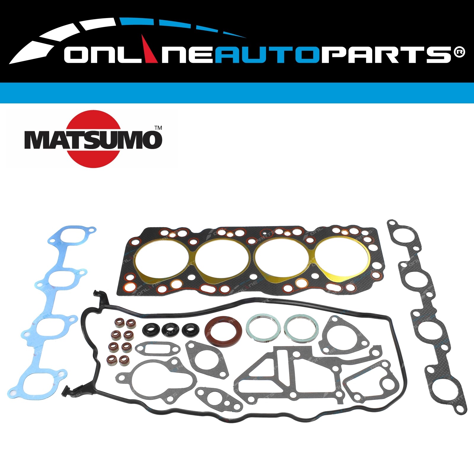

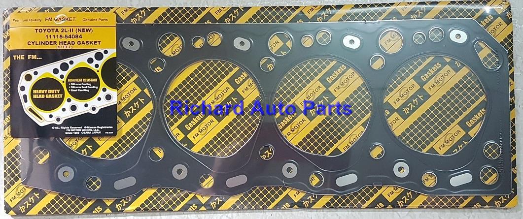

Is there a difference between the early and late 2L headgaskets and valves? trying to order parts but there's no information on the differences between the two.
There are a lot of differences between the two. I would not attempt to interchange parts. Use Megazip and ToyoDIY to compare part numbers etc. I recommend ordering OEM Toyota parts (from Partsouq... ). 1989+ 2LT-II shares same shim over bucket and valve design as 1PZ/1HZ/1KZ/1HDT though.... Quite different than the older rocker head.
