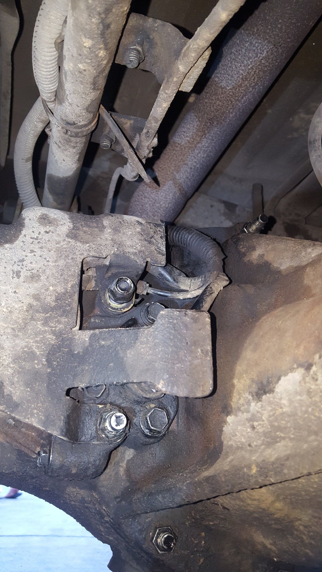

If your 3rd is separated from the differential housing and won’t come out I think its just a matter of wiggling it out. Again try and you a rolling floor jack to support the weight. If your 3rd is not separated from the differential you probably forgot to take off a nut. On the rear e locker 2 of the nuts that hold the locker are mounting nuts for the 3rd member.

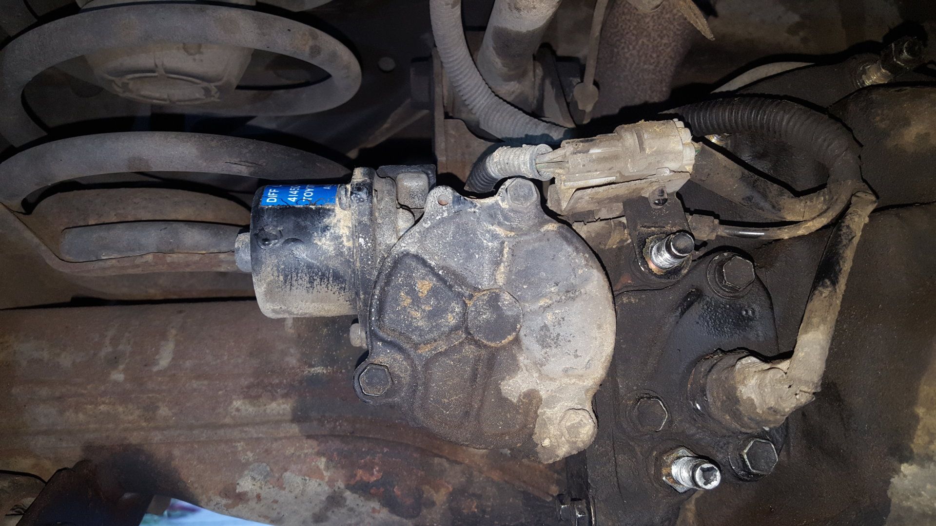

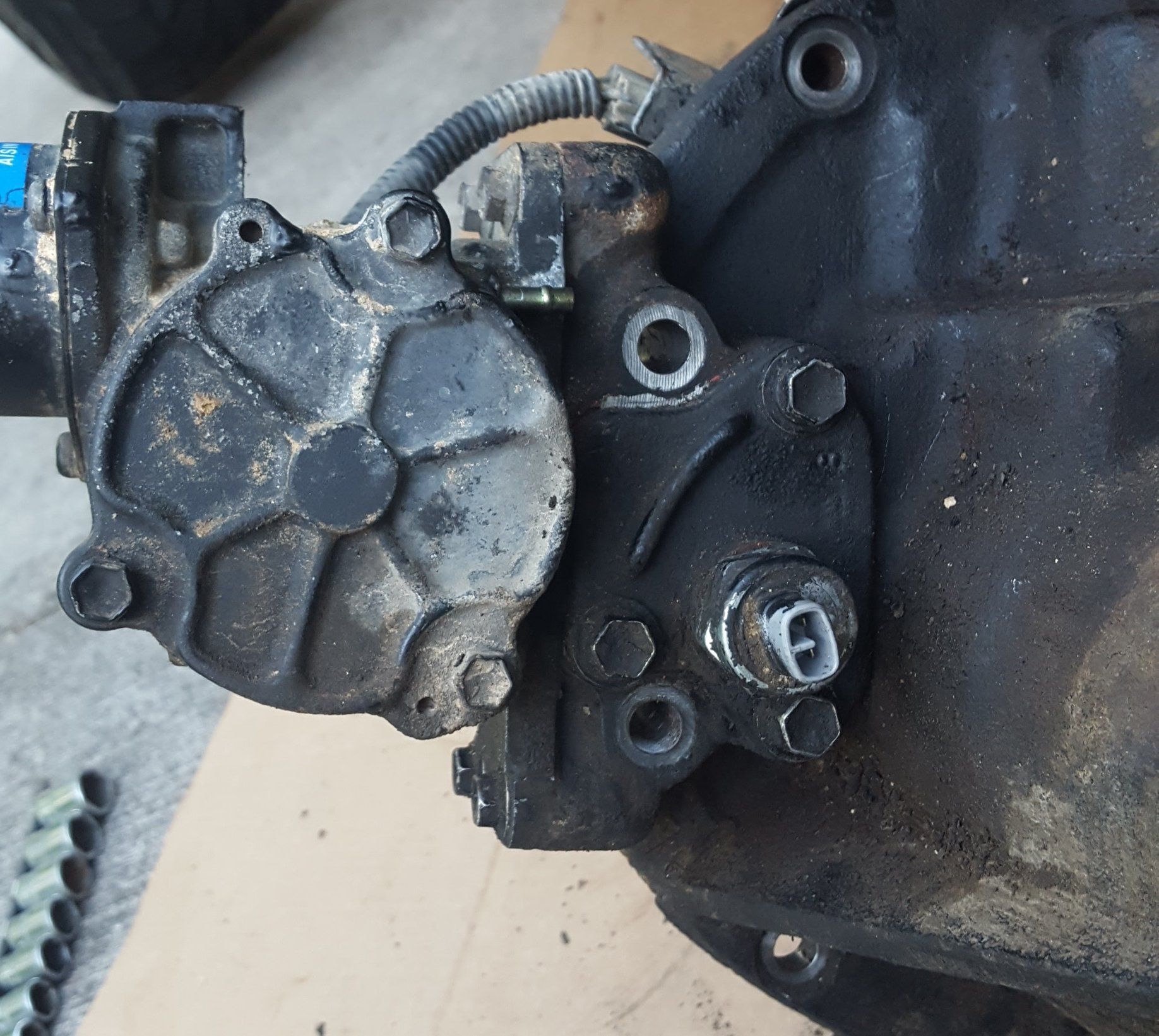

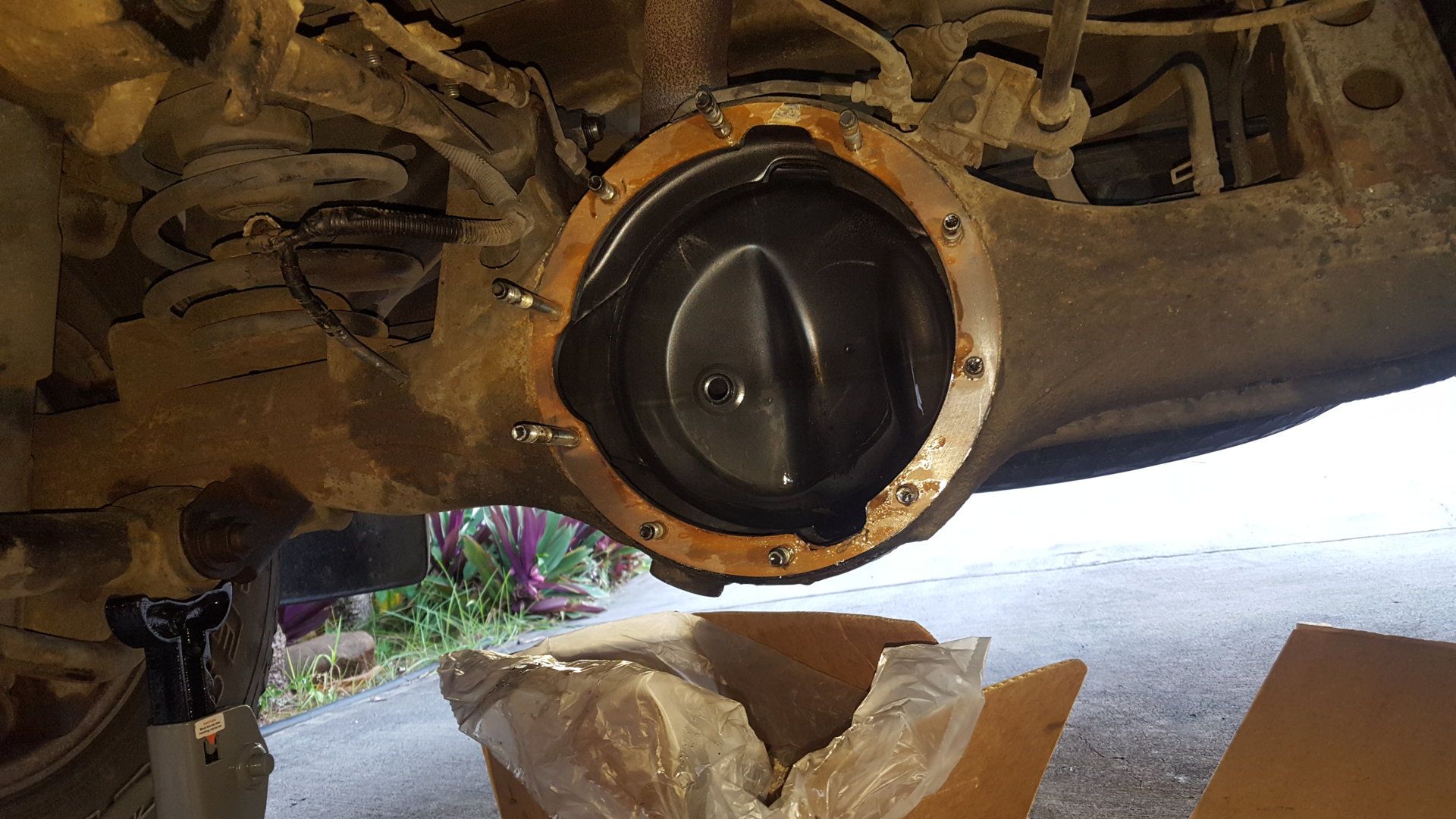

Some pics of the rear end
