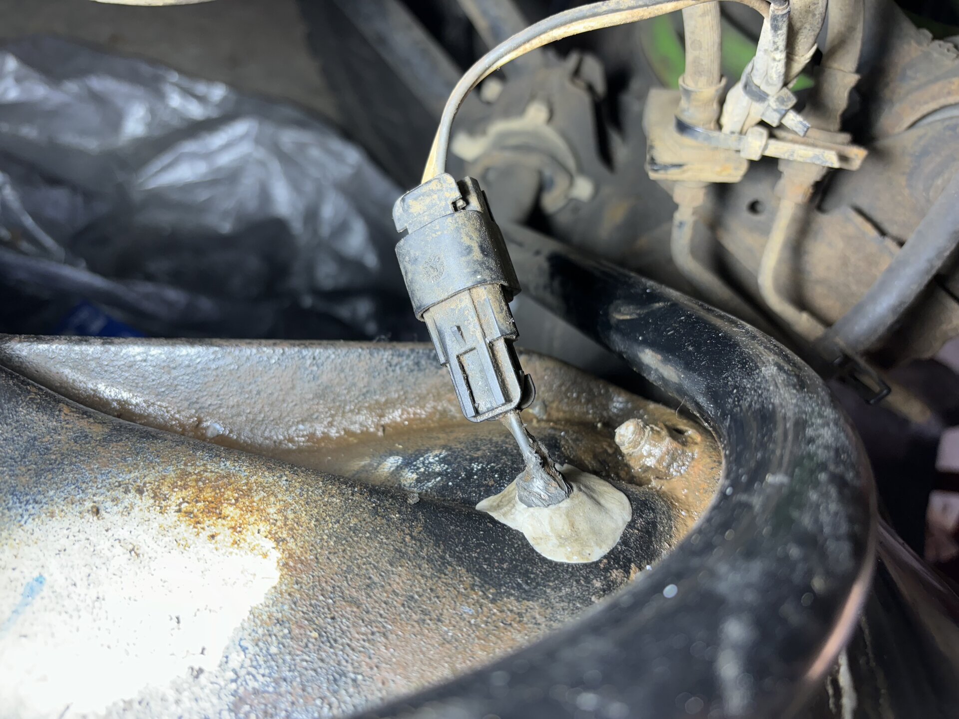

Diff leak at locker wiring grommet

It's been a minute but this seal shouldn't require any RTV. It's possible they drilled the hole too large for the seal to do it's job.
I agree where you're headed is what I would try. Clean as well as possible and apply RTV externally is about all you can do short or tearing it down.
Yeah I would think the grommet from Nitro would suffice. I thought the shop was being overly cautious with using RTV but it's possible the diameter was off. I suppose it's also possible with vibration, flex, wind, etc that the grommet has split or cracked just a bit form wire movement.
Aside from gear oil-resistant RTV, I suppose once I pull off any existing RTV and clean off all the grease I could apply JB Weld around the opening, then once that hardens use RTV to seal it all.
Cleaned up the area with non-residue degreaser, removed the old RTV (which was pulling up). The “grommet” for this really just seems like a rubber sleeve. Fortunately it’s intact. But it’s definitely not crazy tight.

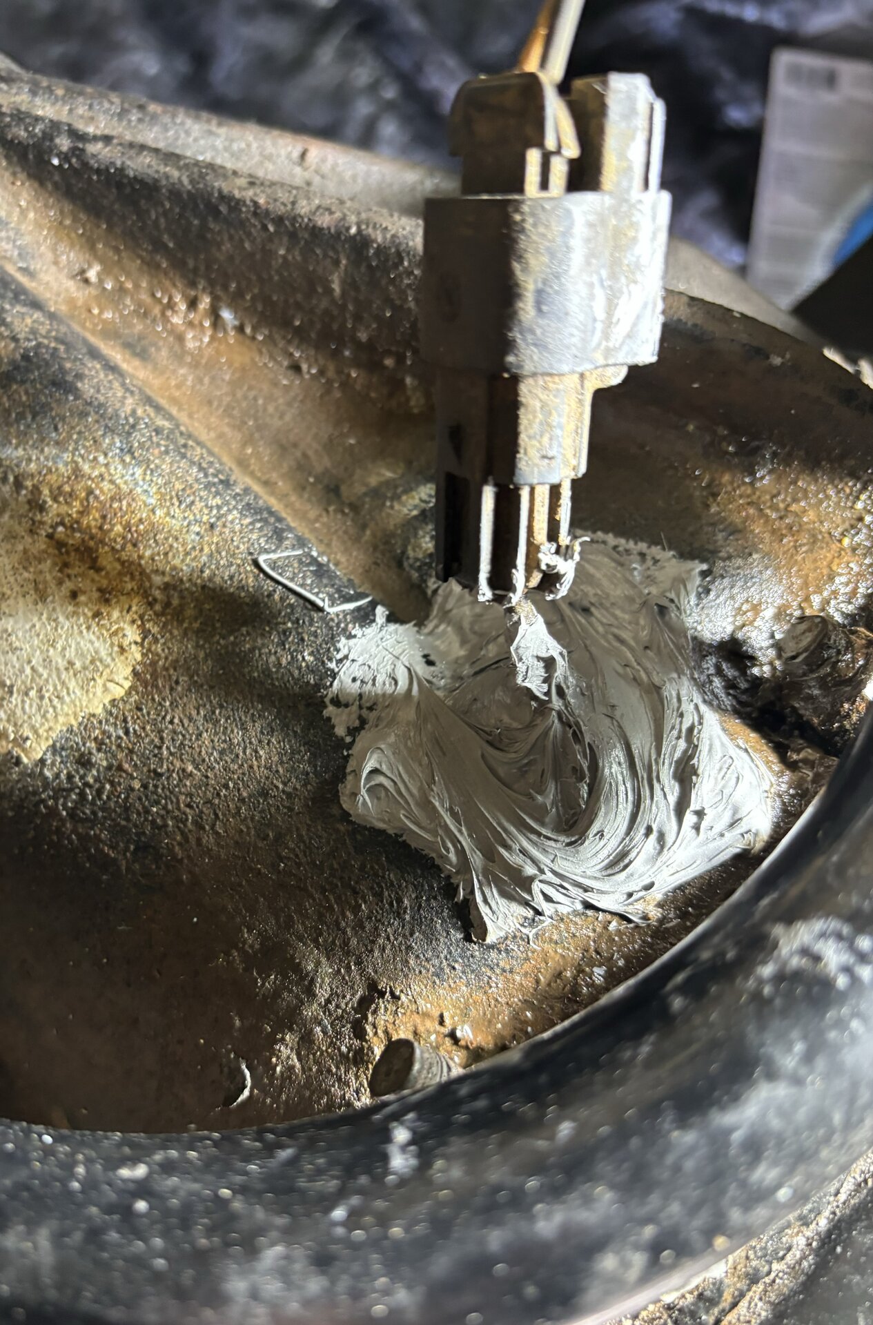

I used some high temp JB Weld around the base, pressed it pretty good in the hopes it would make its way into any gaps, let it dry for an hour, then coated the whole thing in Permatex “green - for gear oil” (which incidentally is light gray, but whatever). Man that stuff is tacky. The JB Weld supposedly fully cures in 8 hours and the Permatex in 24, so I’ll wait until tomorrow to drive it.

Figured I'd post one last follow-up on this topic. After letting the JBweld and RTV set for almost 24 hours, I did a couple short trips around town and then we did about 100 miles round trip yesterday. Checked this morning and everything looks super clean around that spot. I'll see how it holds up over time but seems promising for now.

Thought I’d follow up for posterity. Did a trip to Moab and back, so about 4k miles since fixing this. The fix seems solid, no evidence of a leak so far. We’ll see how it looks in a couple years I guess
