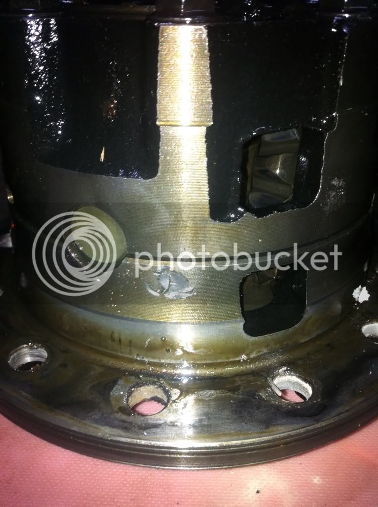

A bit of tooth did this to the center , must have been hit by pinion a million time
I got new bearings & r/p
What u think? Can I still run this?
If it was me....Yup run it, but I would blend it a bit so no sharp edges to start a crack....
But I have seen worse casting marks......haahahahhhahaa
Just make sure there is no bits in the spider gears......
Take a carton of ronas to arb in ozi park and they have a pallet of good cond centers they have removed when installing air lockers.
