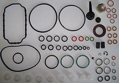

I found a guy in the UK that sells rebiuld kits.. reach out to him.. the add is for a 2L-TE denso : he even sent the extra seals for my pump

roughtrax in uk has a bosch seal kit. was used to reseal my pump . a shop did it, runs very well now, but I wont mention the mad price I had to pay...
Price around $40.00 (29 sterling)
Hey brother thanks for reaching out with this info. Bought the kit and it worked like a charm.
