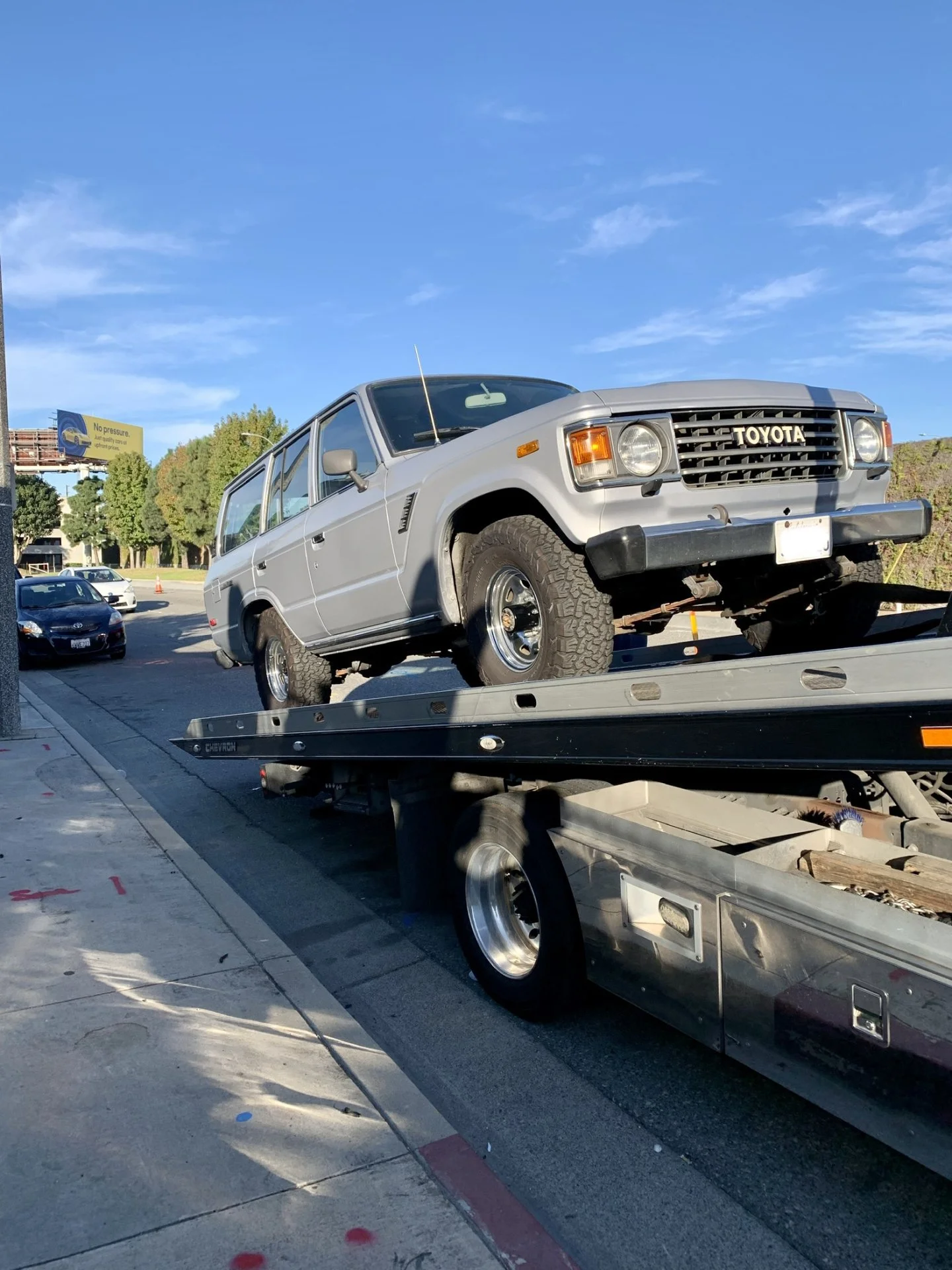

Yesterday morning I hit the road for a weekend camping trip with some friends, headed for the angeles national forest. 15 miles into the drive I noticed a knocking sound developing. I quickly pulled off the freeway as the knock grew louder. Didn’t feel any power loss but it sounded terrible. Fearing the worst I turned the car off and have not started it since. Just before doing so I took this short video. I called a tow and had it taken home. I’m now 100 miles away wondering if I toasted my engine. Do any of you guys have any thoughts based on the video (I will post below)? Is there a simple way for me to test in the driveway before I have it taken to the shop? Should I not start the engine at all? I just had the engine pulled and rebuilt ~500 miles ago by a reputable shop in Orange County. I checked the oil level the night before leaving, I was mid way between the low and full line on the dipstick. It was running perfect up to this point…

That much is for certain. I have a feeling it is going to be more than just retorquing. They're going to pull the crank to check for damage to the rod lobe. Who knows what happened once that nut fell off. As I understand it they sent the motor to another shop for the actual rebuild and machine work, then buttoned everything up with new gaskets at their shop. So now there is some back and forth in terms of who is liable and how it's going to get taken care of. I'm at my wits end with this rig, coming up on a year of ownership and I've only been able to enjoy/drive it for ~3 months.
Just to close the loop on this one (if anyone cares), I finally got my cruiser back today. The engine ended up needing to be pulled, sent back to the machine shop for re-rebuild, then reinstalled. It has been a long and emotional road but everything sounds and feels good at this point and I am just hoping for some worry free miles ahead of me.
