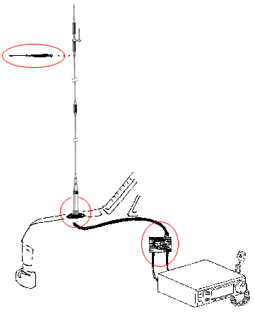

Here's a diagram (courtesy of Diamond Antennas) that is a fair representation of what can be done.
1. A single radio with two antenna ports, one for HF (incl CB) and the other for VHF... or two radios, each with a single antenna connection, are fed into a duplexer, from which a single transmission line (coax) goes to the antenna.
2. The multiband antenna is made up of a loading coil (large section at the bottom), resonators (the black tapered cylindrical pieces on the antenna), and the interconnecting stingers (the wire "whips") that do the actual radiating.
The resonators have tiny set screws at either end that allow the stingers to be moved up or down a bit to bring the desired portion (band) of the antenna to the desired operating frequency.
On this antenna, the 10m stinger is the topmost element. Simply loosen the set screw on the upper section of the topmost resonator, and slide the stinger up (lengthen the element) until the resonant frequency is lowered from 28 mHz (10m) to 27 mHz (11m).
Tuning one of these antennas is somewhat like balancing that proverbial three-legged stool and, done properly, one should use an analyzer... but that's a separate matter.
My point here, is to illustrate a convenient solution to using a CB and VHF (2m) ham radio on a single antenna. I would not suggest trying to transmit on both radios simultaneously :eek:

Interesting - thanks for the time to post this and the info Ron. For now, I'm going to stick with separate antennas.
