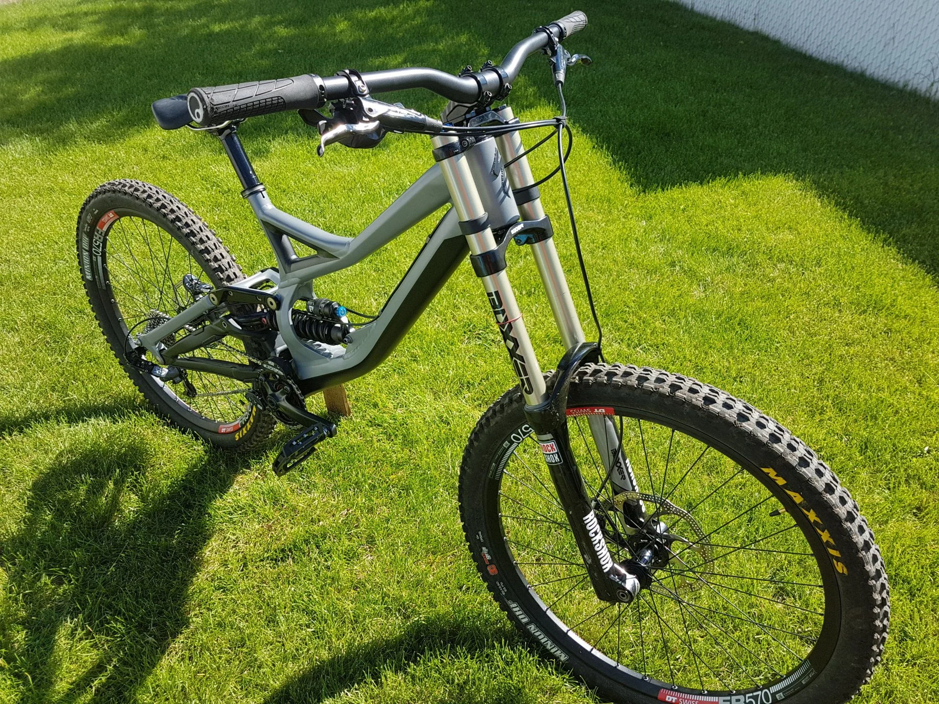

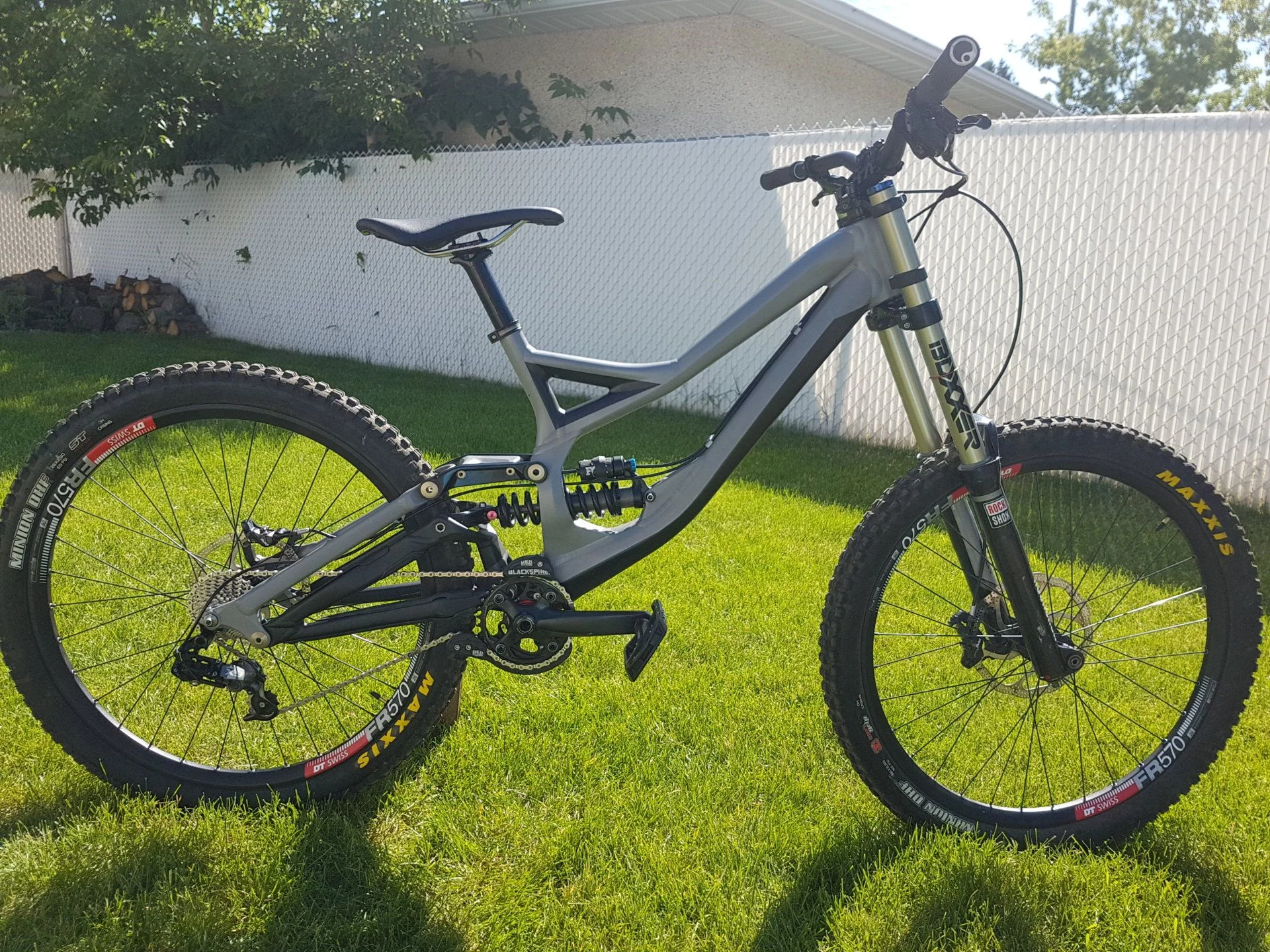

Bored at work today so I thought I'd share a recent project that pulled me away from the truck.
The scuffed, scratched and beaten look of the used Demo 8 I got last year wasn't doing it for me, so I did something about it.
Paint stripper, clean and rough up, primed, sanded, painted, painted again, wet sanded, clear coated and topped with some 3M paint protection in a few critical spots. New Tacoma cement grey with hot rod satin black. 2K matte clear coat. Looks killer up close, but I'm worried about the longevity of it. While it was apart i repacked the bearings, cleaned everything as much as possible. New rims, pedals and chain ring, but everything else reused.
Going to throw it down a mountain at Fernie this weekend, so I guess I'll find out how well it holds up.

nicely done. just needs the rest of the decal kit and it might pass for stock.
I'm a no stickers kinda guy most of the time. My vehicles have usually gotten debadged in the past too. I will likely leave it as is, potentially repainting next year if it turns out my prep work was garbage.

@Dork Just found this thread....it's been a year, hows the paint job holding up??
Better than I expected, actually. It's been crashed 7 or 8 times, dropped, shuttled, chair lifted, wedged into a gondola, hit with rocks and ridden in rain, light snow and mud over that year. There's a few nicks in the paint, most notably on the seat/chain stays.
