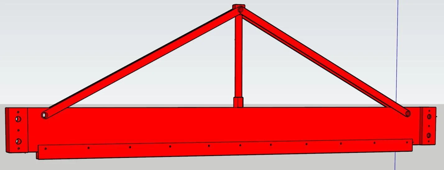

Not needed. The vertical height is buying you the most strength in that beam. The welding will just pull/bend it. I'd delete.
I would up size the hardware used to hold the truss on also. I did 1/2 inch grade 8. If I do something stupid like max out the jacks using too narrow a bottom die width I can bend them. I would go up to 5/8
On the rolling die. Rolling is a pretty different process, you need force to turn the die also. I would just use pipe/tube and see if you could find a radius that works after spring back. Make the bottom dies have a few different width positions to allow using different dia upper dis vs the bend angle you want.....likely a max 90.
10-4, will delete.
Will upsize hardware to 3/4" to match the tensioning bar.

Updated upper die guide. All 3/4" fasteners and got rid of the tube along the truss. Changed the height of the truss bar to be 6" tall, so now it's 1"x6".
