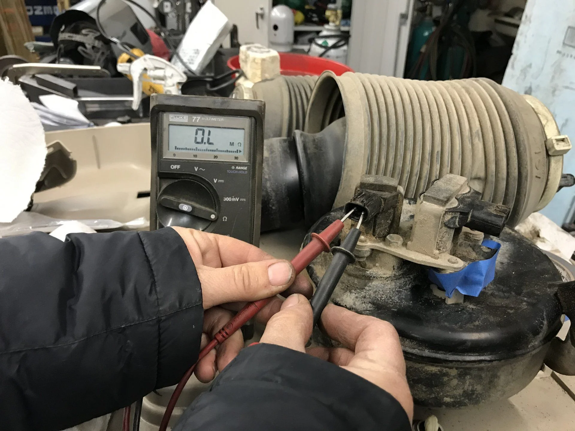

I was getting codes 34, 44 and 61 and I could hear the solenoids repeatedly going on and off when I tried to lower the GX470.

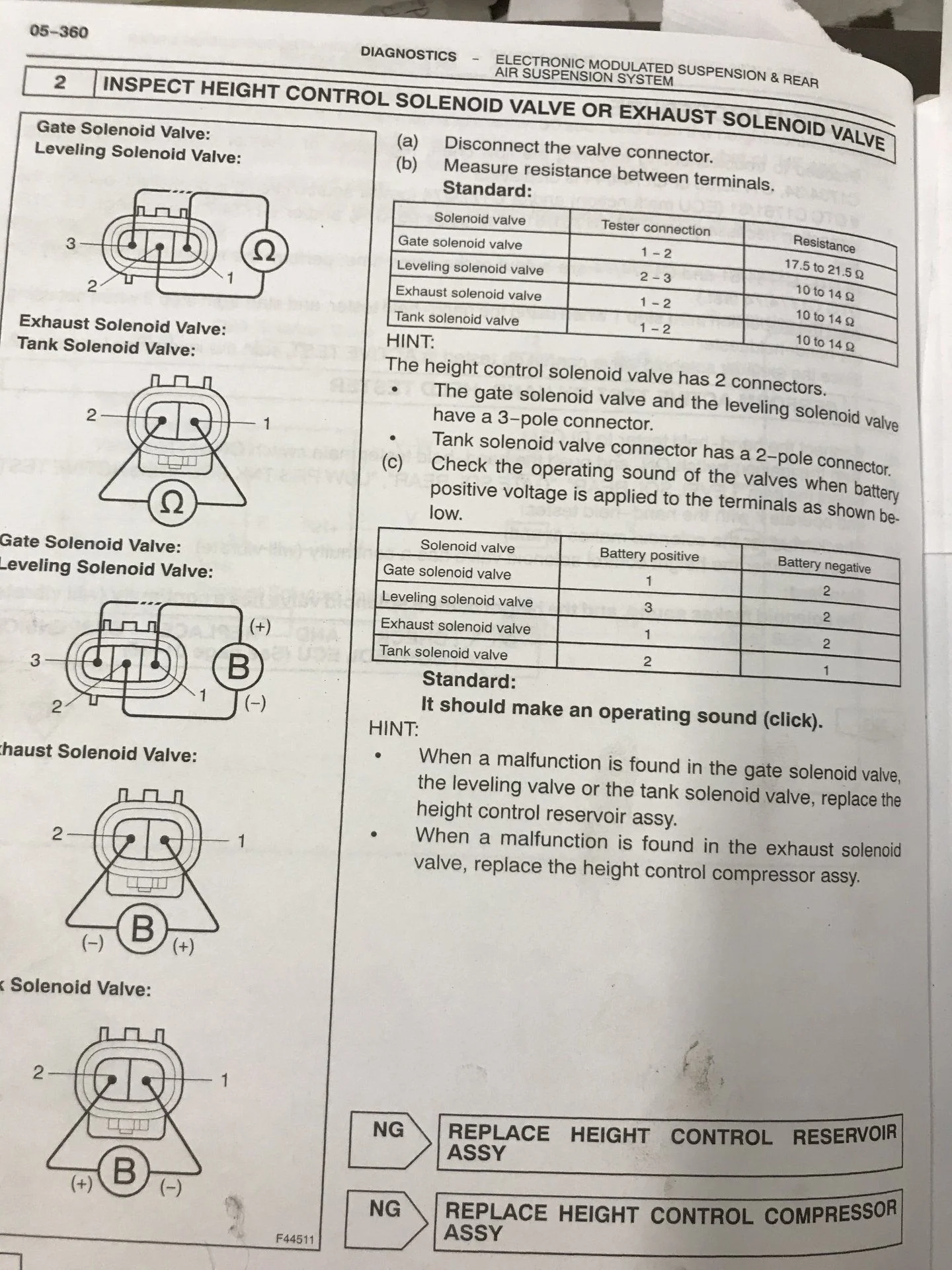

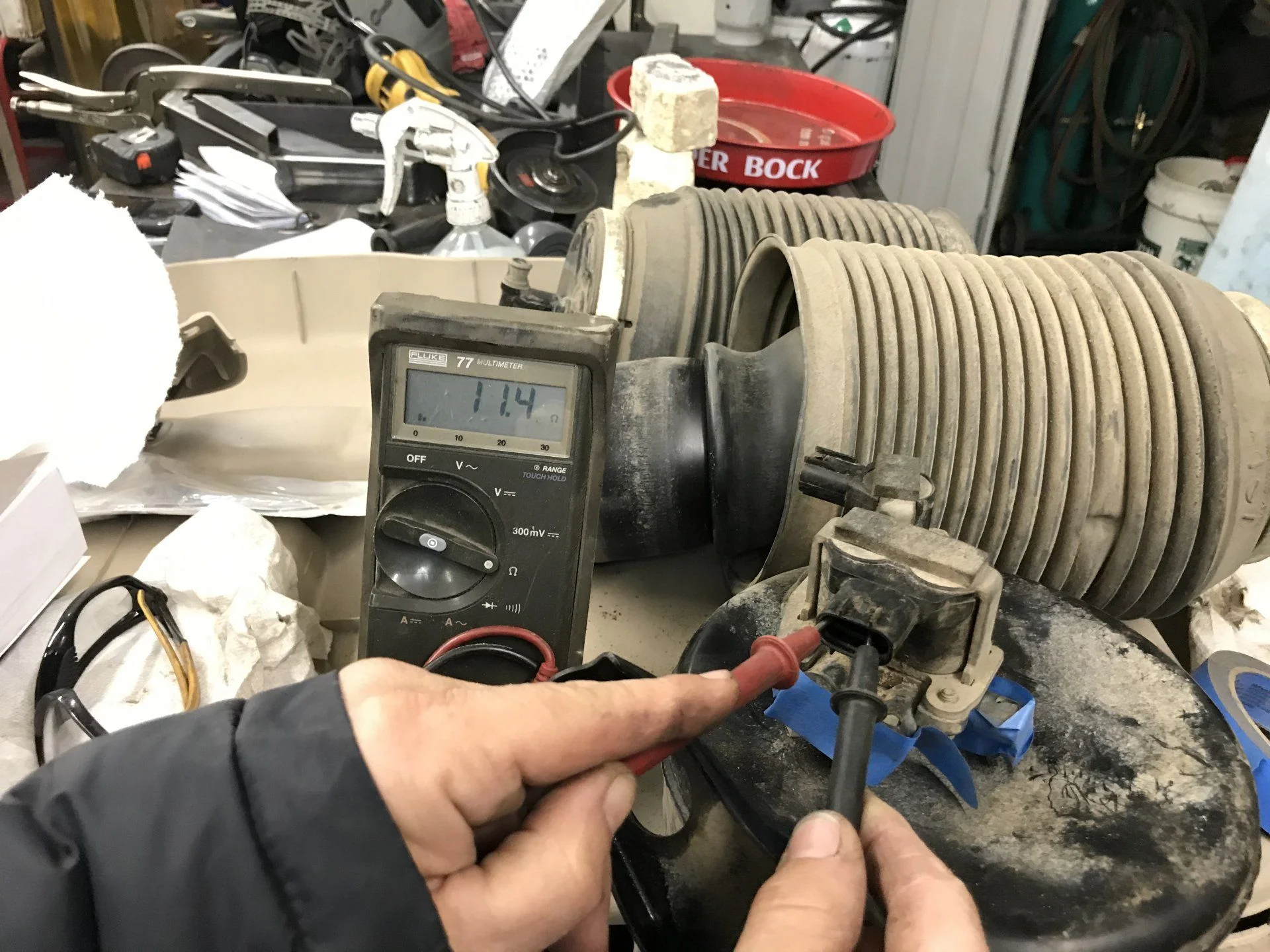

I cleared the codes and it seemed to work again briefly, but the lowering was very slow indicating the tank solenoid was bad. Code 44 was never cleared also indicating it was the tank solenoid. I dropped the tank and performed the diagnostics on it and all the solenoids are good except the tank solenoid, as expected. It tested open and as expected it didn’t click when I put 12 volts across it.
Movies won’t play but they show the solenoids clicking properly for all but the tank solenoid.
