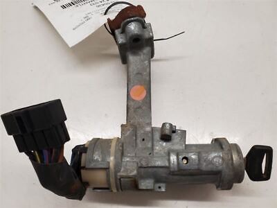

My 94 pickup (4wd, auto, 4cyl, non-tilt) was broken into with an attempted car jacking. The bracket that holds the ignition cylinder and switch was destroyed and I can't find another one. Let me know if you have the lead on one!
Here are a couple. These aren't mine and I have no affiliation to the sellers.

Here is the ( NON-TILT ) epc microfice parts diagram for you
i looked up a usa spec , pick up per your spec. in post 1 here ,,,
the OEM ignition lock cylinder has a unique interchange part #
69057
-35040 / 69057-35050
Thanks everyone, I ended up swapping in an entire tilt column out of a 4runner. Apparently auto, non tilt is a strange combo
