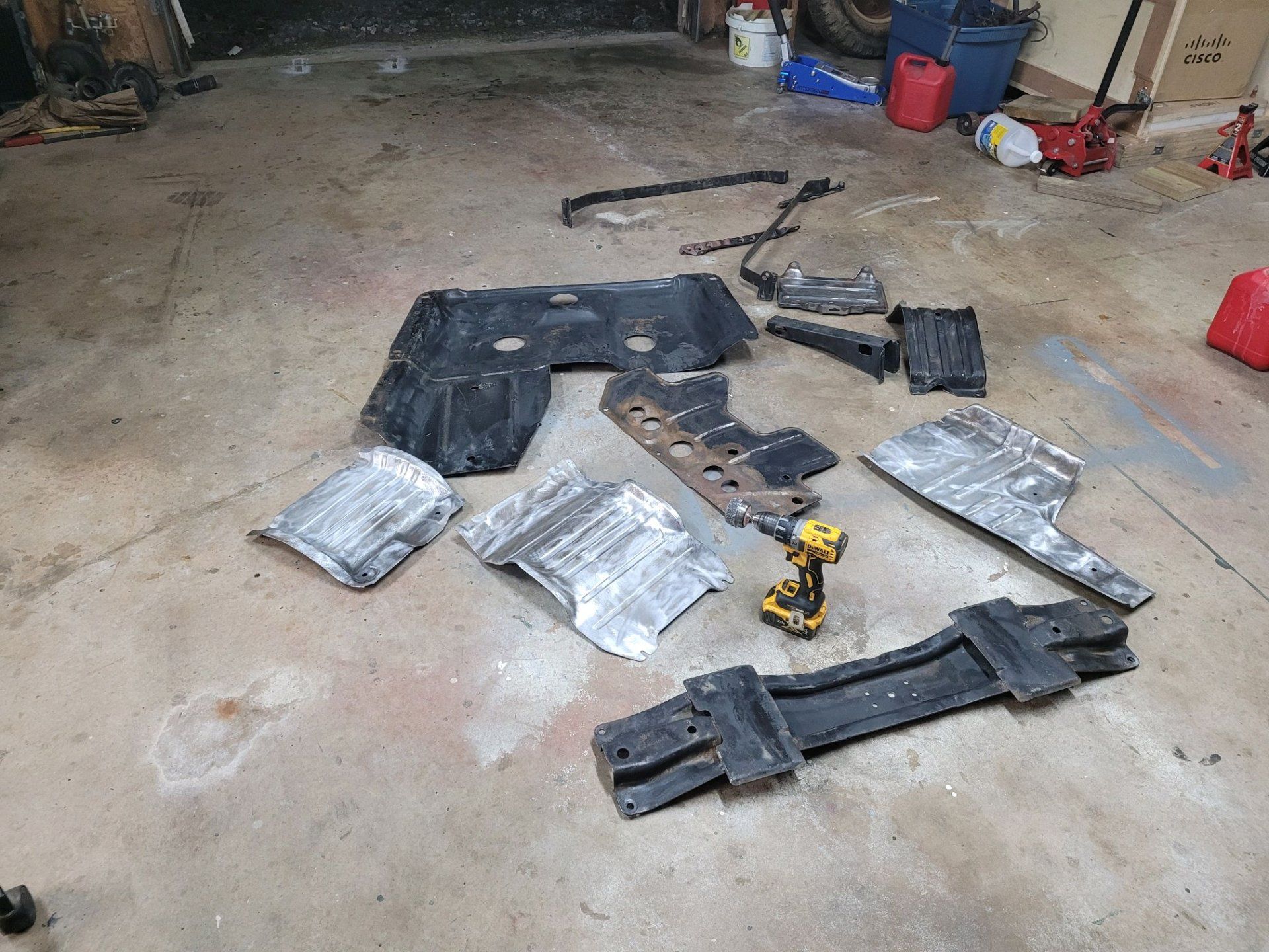

It has been too cold and wet to work on it for a few days, but today it warmed up enough to go back at it.
Today I worked underneath the truck with a wirewheel, and I also dropped some more of the heat shields. There is quite a bit of the original rubberized undercoating left, so I'm not quite sure how I should proceed with coating it. I really don't want to have to wire wheel it all off.
You can see some of the mud dauber action I'm fighting inside the radiator shroud. I'm hoping I can have the radiator hot tanked and refurbished for re-use.
Spent some time getting the things I've removed cleaned up.
Working the wire cup is pretty tiring.
