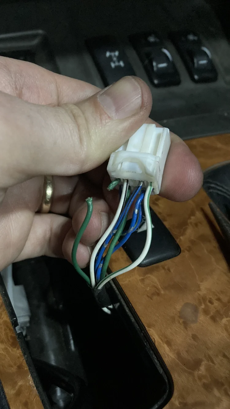

I don’t know if anyone else has posted this (probably have) but I couldn’t find it. If you’re replacing your ride height / air suspension with other switches, the cut green one is the wire for your night time dash / switch lights:
