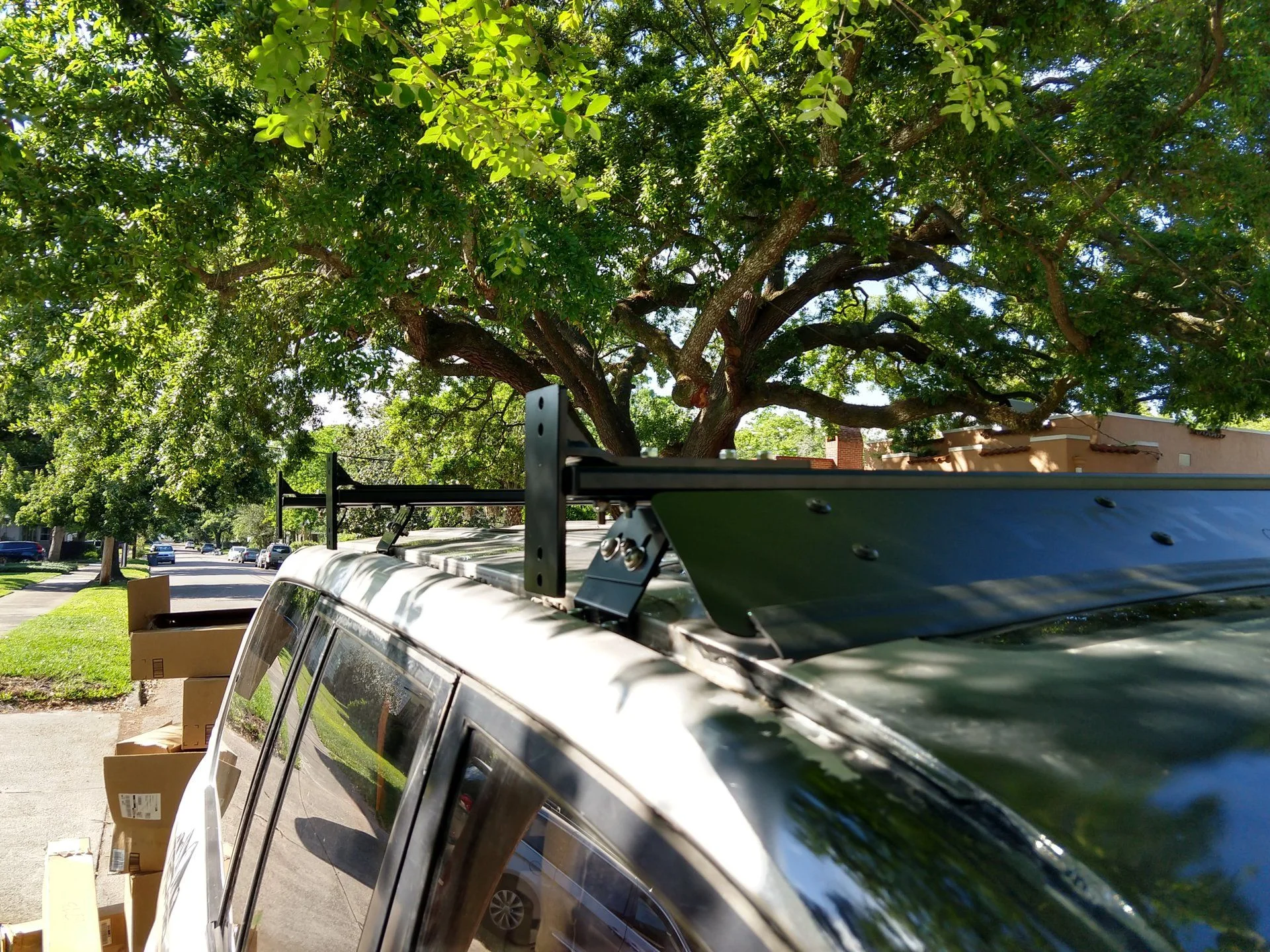

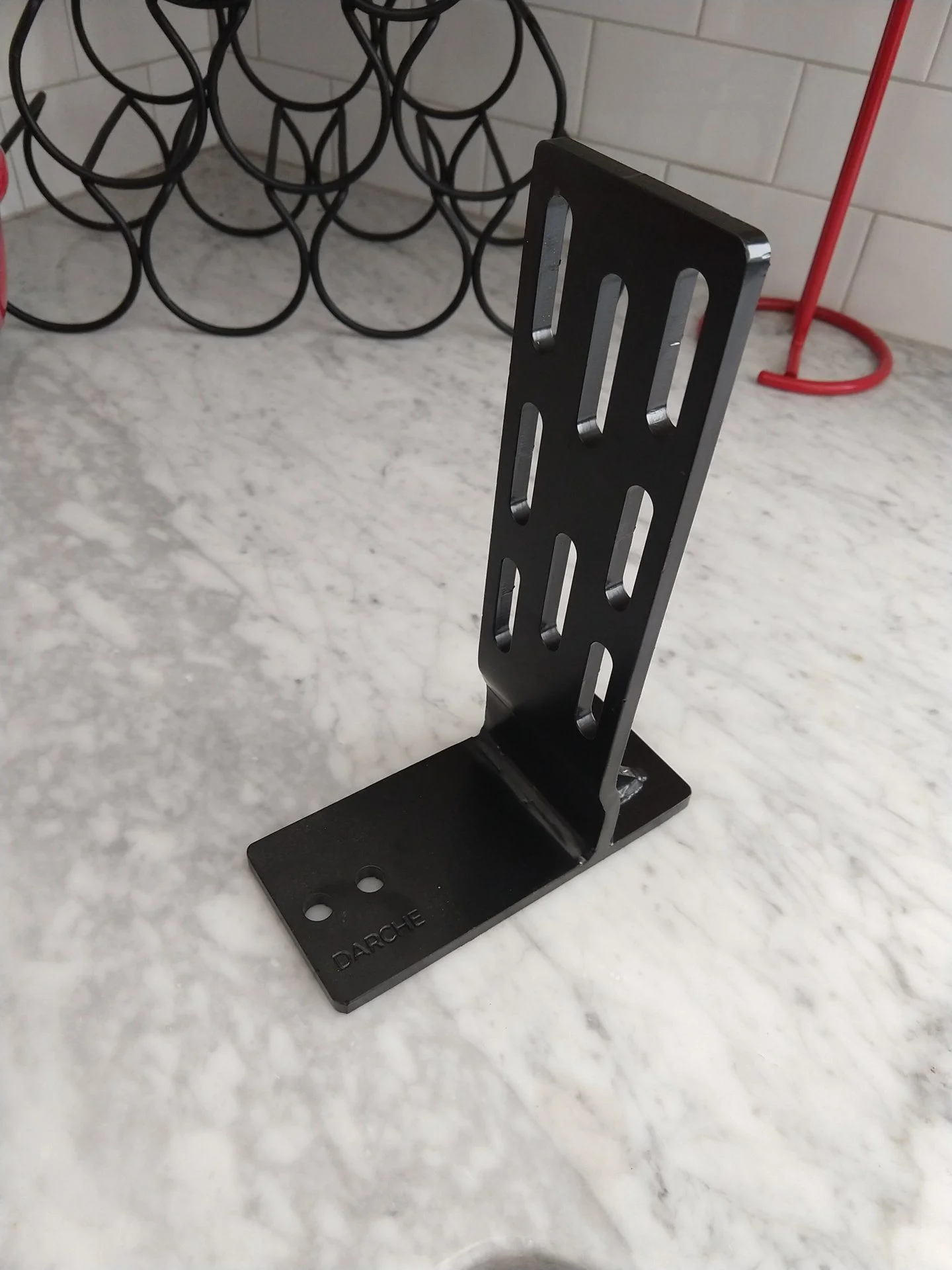

MOUNTS: Three mounts included. VERY strong and heavy. Powder coat was lacking in a few spots but not bad by any means. Hardwear included 6 zinc plated U-bolts to mount the bolts to circular racks and bars as well as a bunch of Bolts and nylon locking nuts.
1958955

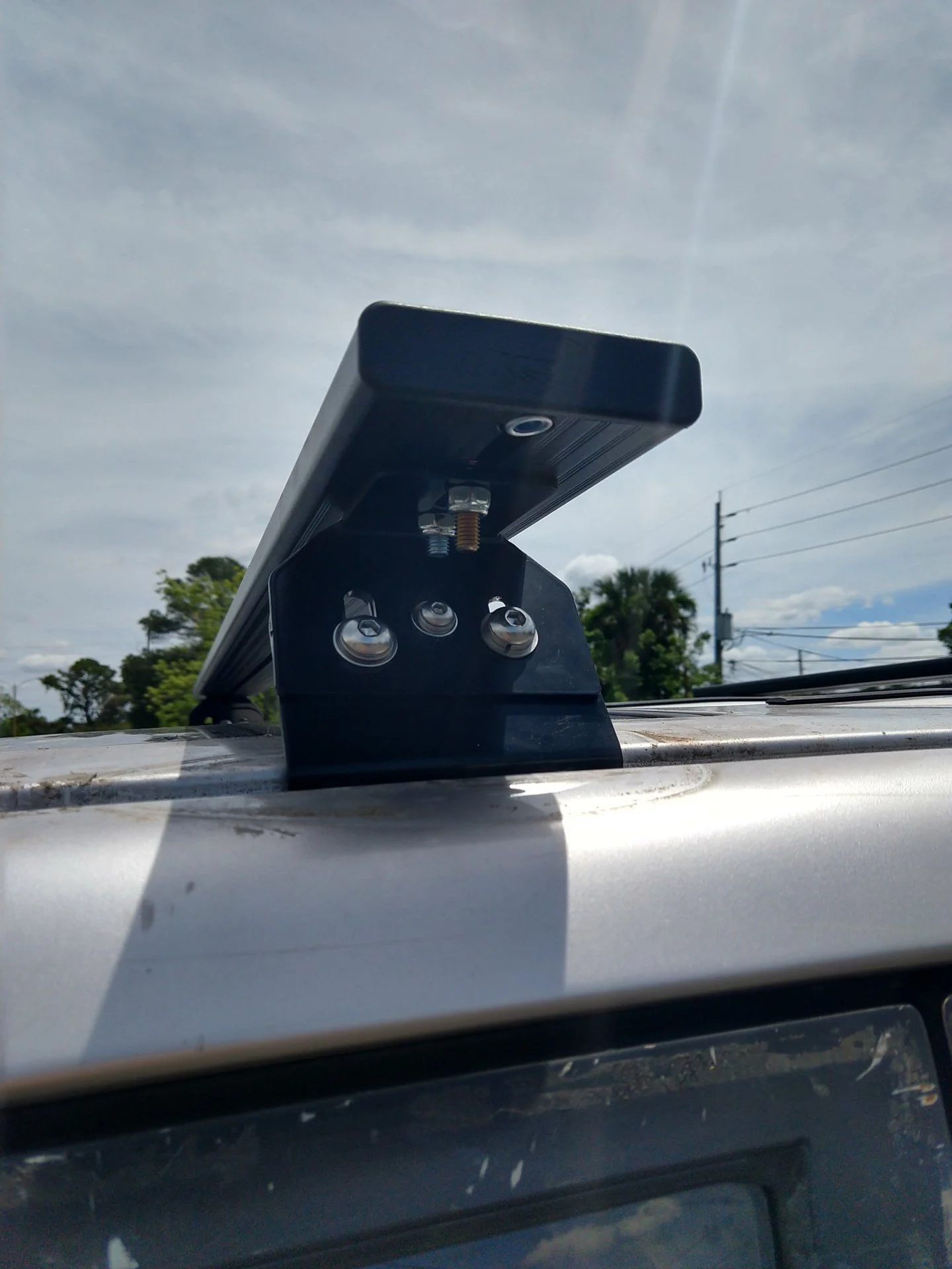

I used the channels in the Load bars and put three bolts into each mount. Mounts seem to be designed to mount long side high as the extra bracing on the shorter side but I wanted the awning mounted closer to the body and not as high so I flipped them over. Time will tell if I need to swap them back around.

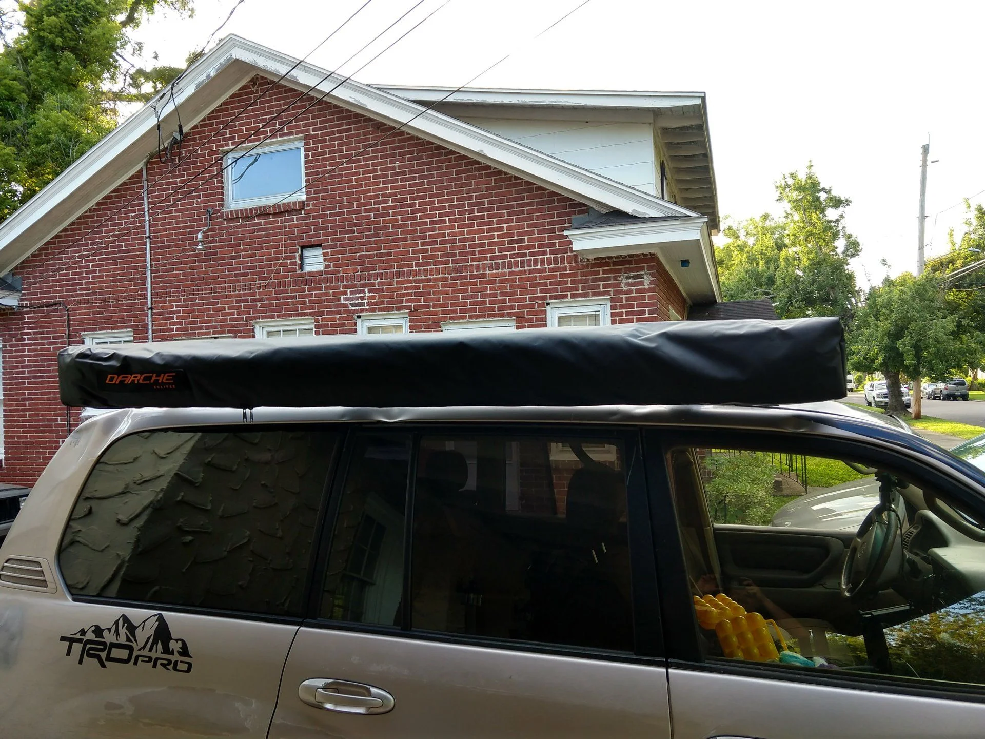

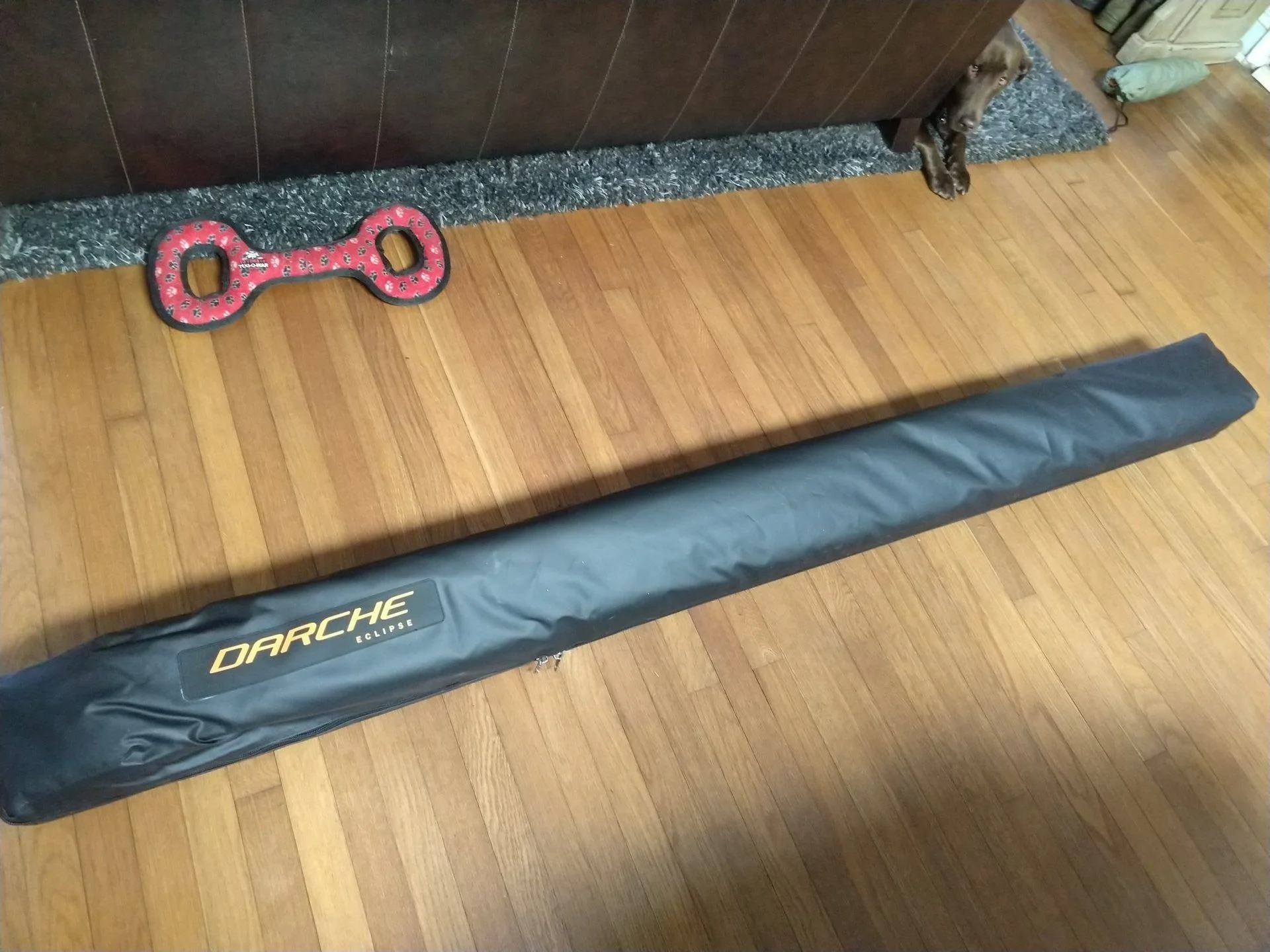

AWNING: The outer cover is nice and thick. Nice rubberized Logo is stitched onto it. At 45 pounds it was only slightly heavier than the 2500 i took off. The side by the logo is angled as it seems it was designed to help with cutting the wind when mounted on the drivers side. I elected to mount mine passenger side as my fridge is mounted where the 40 second row seat was.

MOUNTING: Back side of the awning has the familiar t slot for mounting. I slid in the bolts to their approximate location then lifted it up and had my girlfriend adjust them then finger tighten them to the Mounts. After ensuring the mounts were flush against the awning I tightened them to the load bars then tightened up the awning. 10 minute ordeal with 2 people.

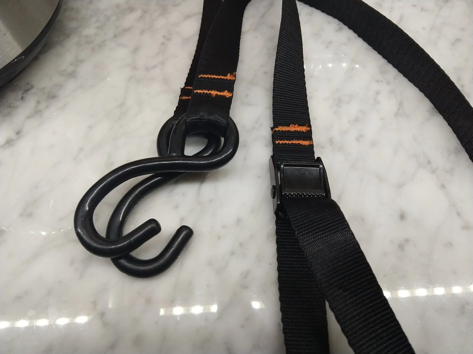

SET UP: Extremely Easy. Easier than the ARB. The awning is tensioned from the front and back. There are two tensioning straps that are stored in the cabin and it pays to set them out first. Both straps are well made and have a metal clamp buckle to hold the tension along with metal S hooks on each end. One end I put over the load bar on the other-side of the vehicle, the other hooks on to the awning arm.

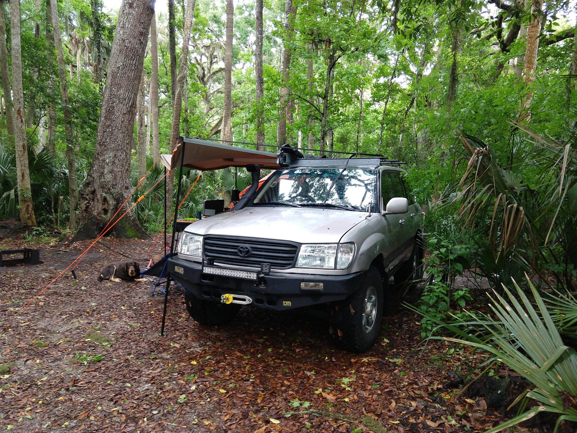

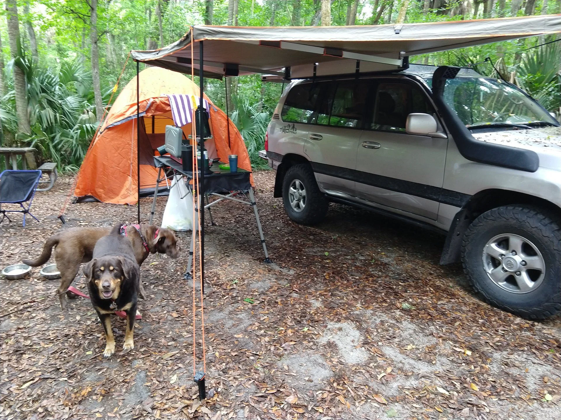

Since mine is passenger mounted my fronts come out first. Unzip the cover and flip it up. Undo two large Velcro Straps then walk the arms to the front and tension with the strap. The walk the other arms to the back and tension those. The middle supports have integrated Legs. Undo some velcro and they swivel on a ball joint down then they twist lock like most awning legs. The Front and Rear legs are stored inside the cabin with the straps and slide into a hole in each arm. My front pole couldn't go straight down because of my bumper so I angled it (as you will see in a later picture)
Guide Ropes attach to each arm top. The supplied guides are thick and bright orange making them easy to see and avoid. Supplied Stakes are also thick and strong as well, though for the main two stakes I used some left over large tree stakes because there was a storm forecast to come through

There are additional Guide points and ropes provided. But these aren't for staking it down. instead they pull the canvas down in the middle to create a gutter for the water to flow off. Wasn't sold on these initially but after a squal line came through and brought a ton of rain, water flowed off very easily.
1959012
Awning Material: While the ripstop canvas is thick it felt a little thinner than the ARB which was initially disappointing, However, the water proof coating it has is excellent. Held up to a ton of rain on Friday. and the gutters worked well. Darche also has a zipper that goes along the edge of the awning to allow you to add sidwalls to expand the footprint. Maybe down the line but that required too much commitment to stay put for me initially. and with the 123 square foot of shade coverage already provided it wasn't needed.
Overall: Loved the awning on it's first trip. Very Easy to set up and break down and it was STRONG. First day of camping brought a strong storm line through with 50 - 60 MPH winds, while the awning didn't see that due to the trees breaking some of it up it withstood 10x what the ARB did before the ARB bent. I wasnt sold initially on the usefulness of the front wing but with the sun not directly overhead for 80% of the day the front and rear wings provided great coverage to where I wanted it, right by my kitchen. Highly recommend people start considering Darche as an awning option. In my option, the perfect middle ground between the pricey top of the line and the roll out awnings.
