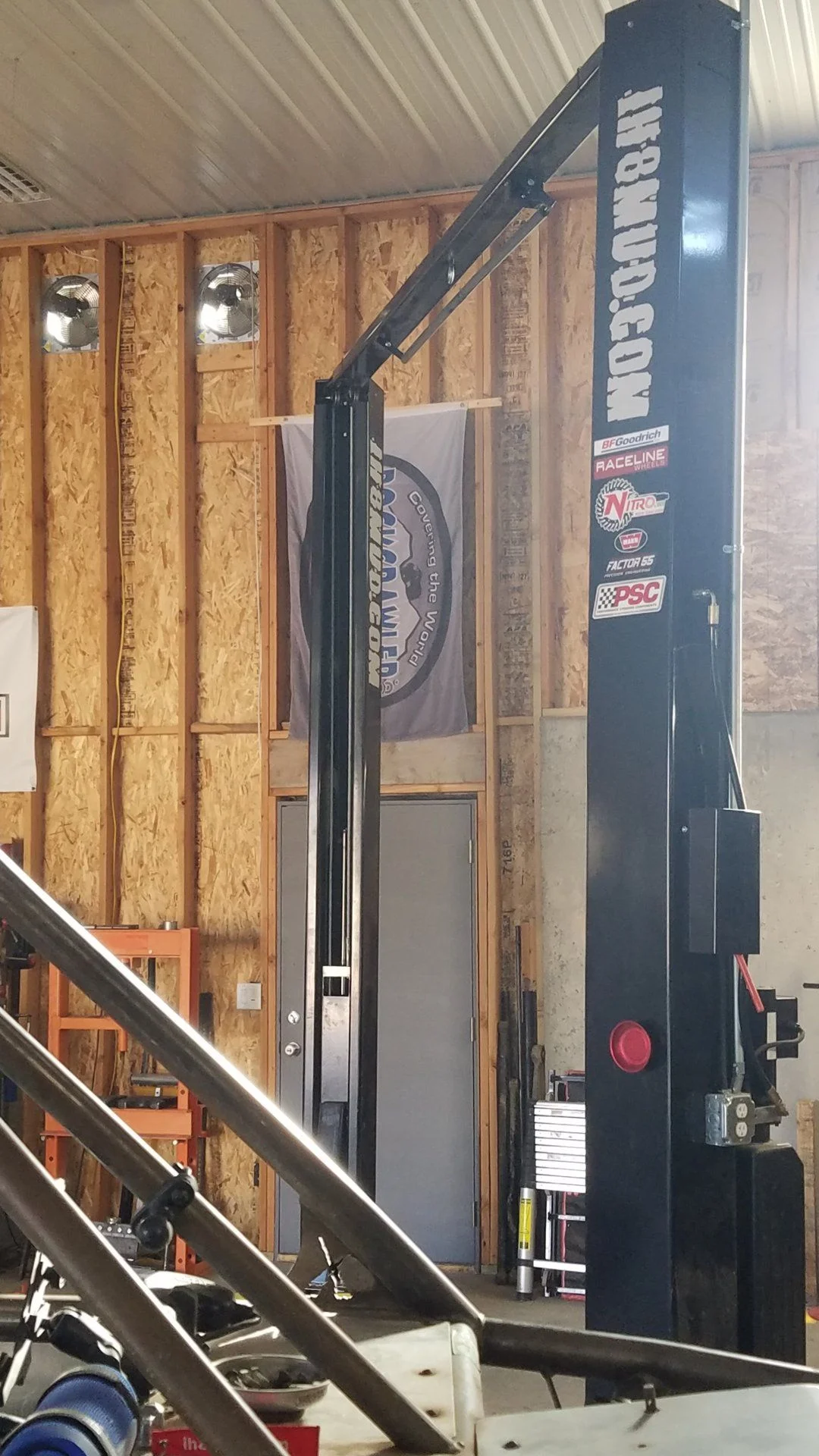

Mine is a year-ish old, and works awesome....
Of course, the MUD sticker increases the value :-)
