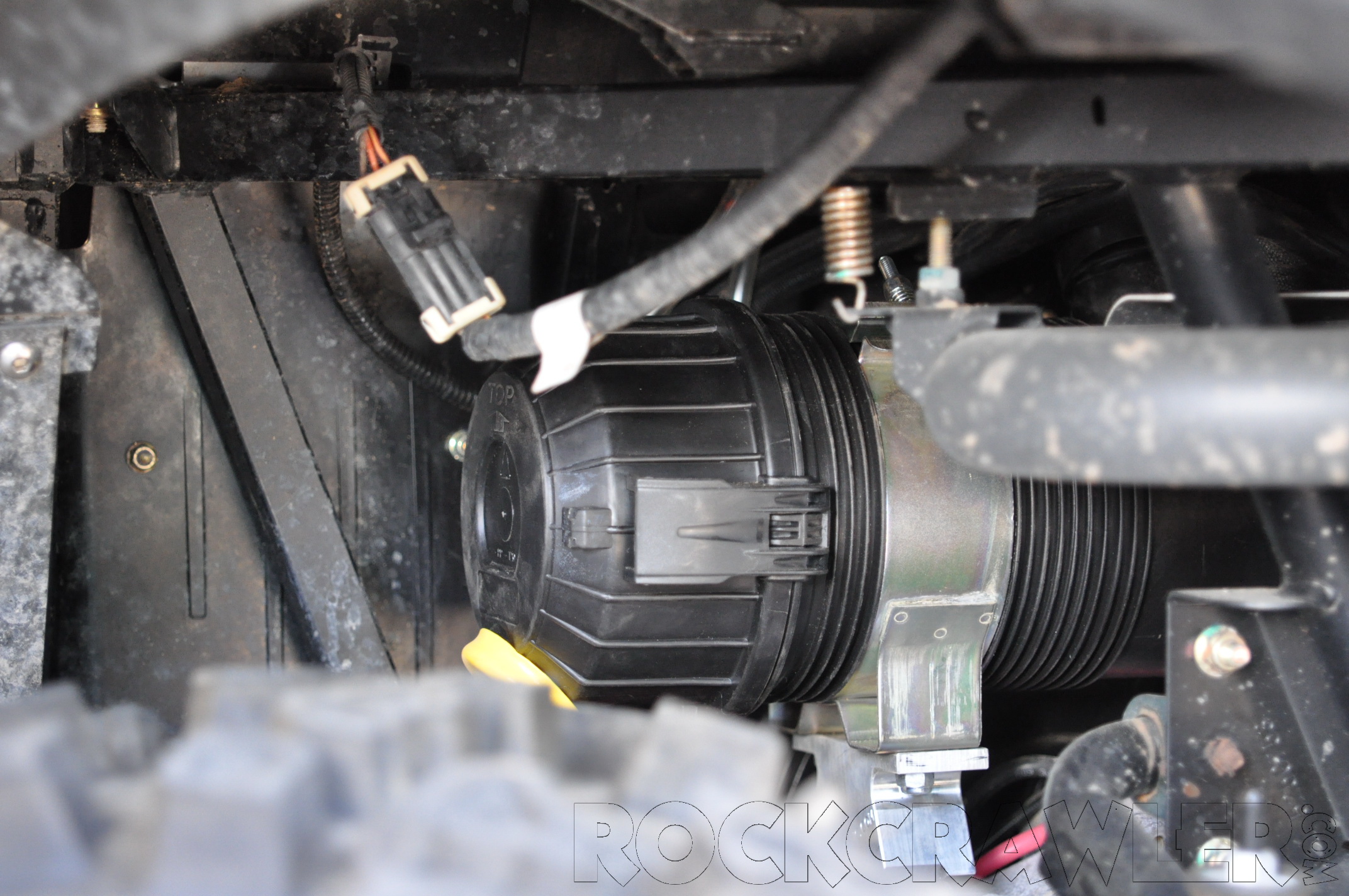

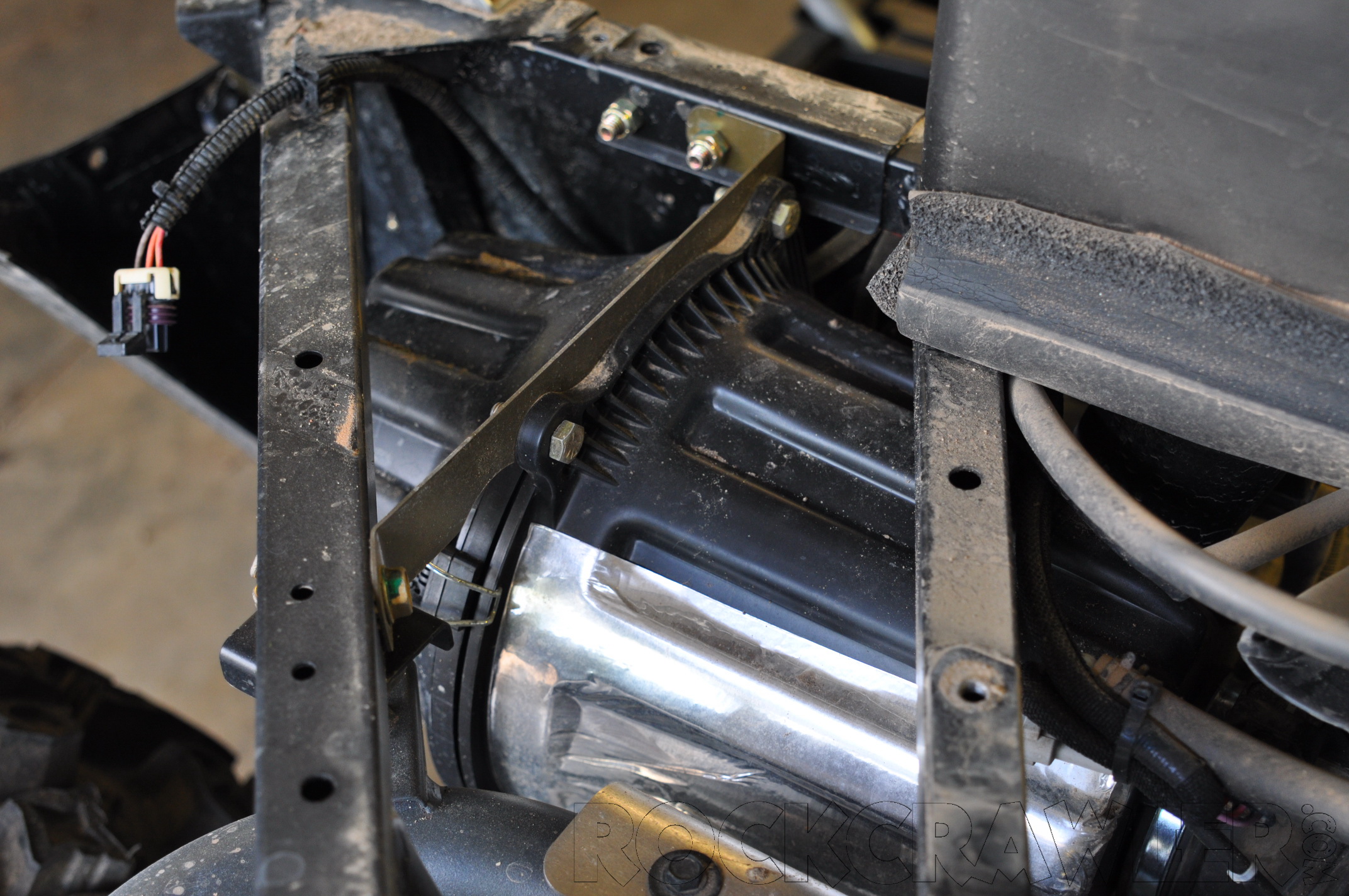

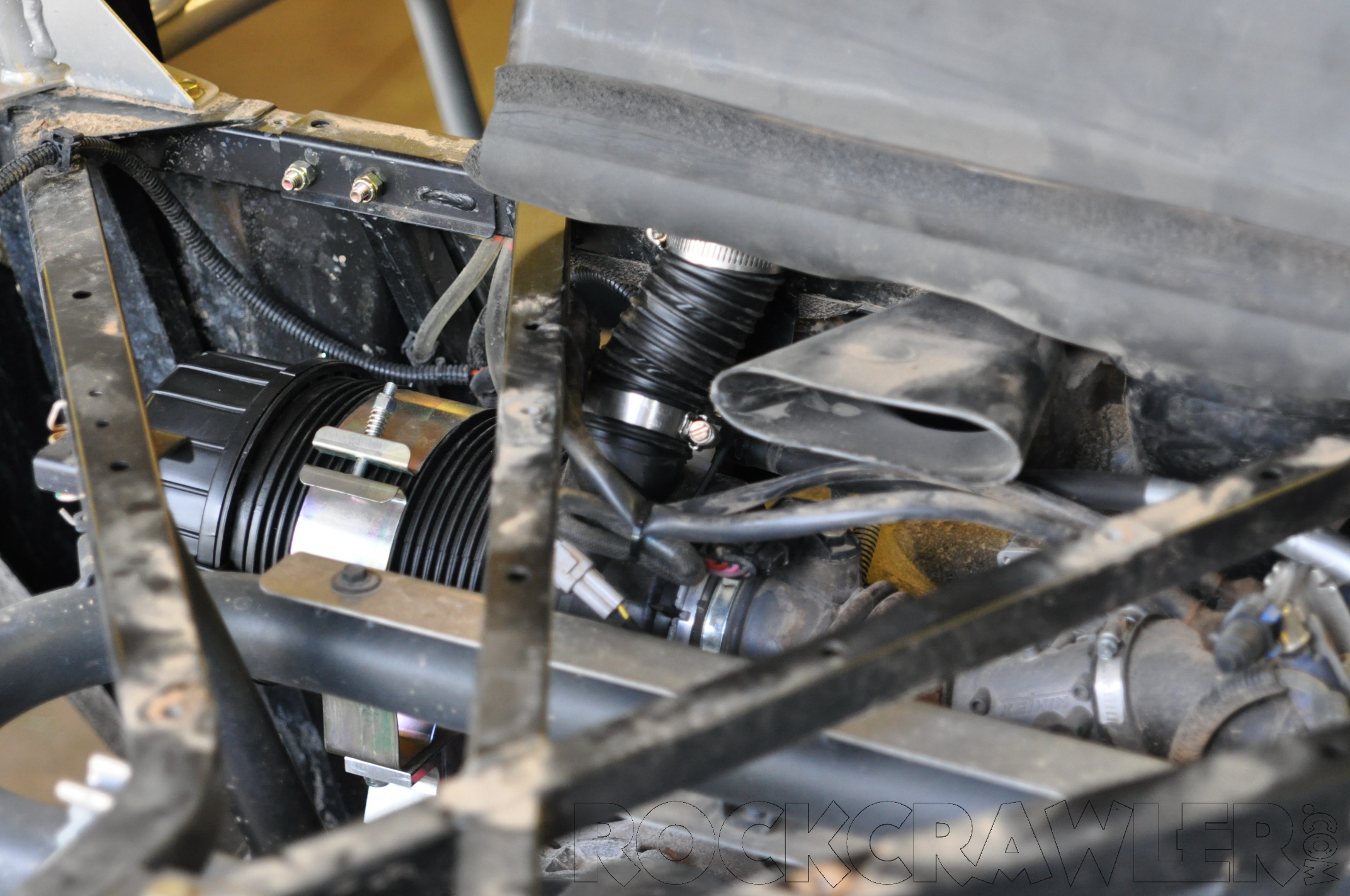

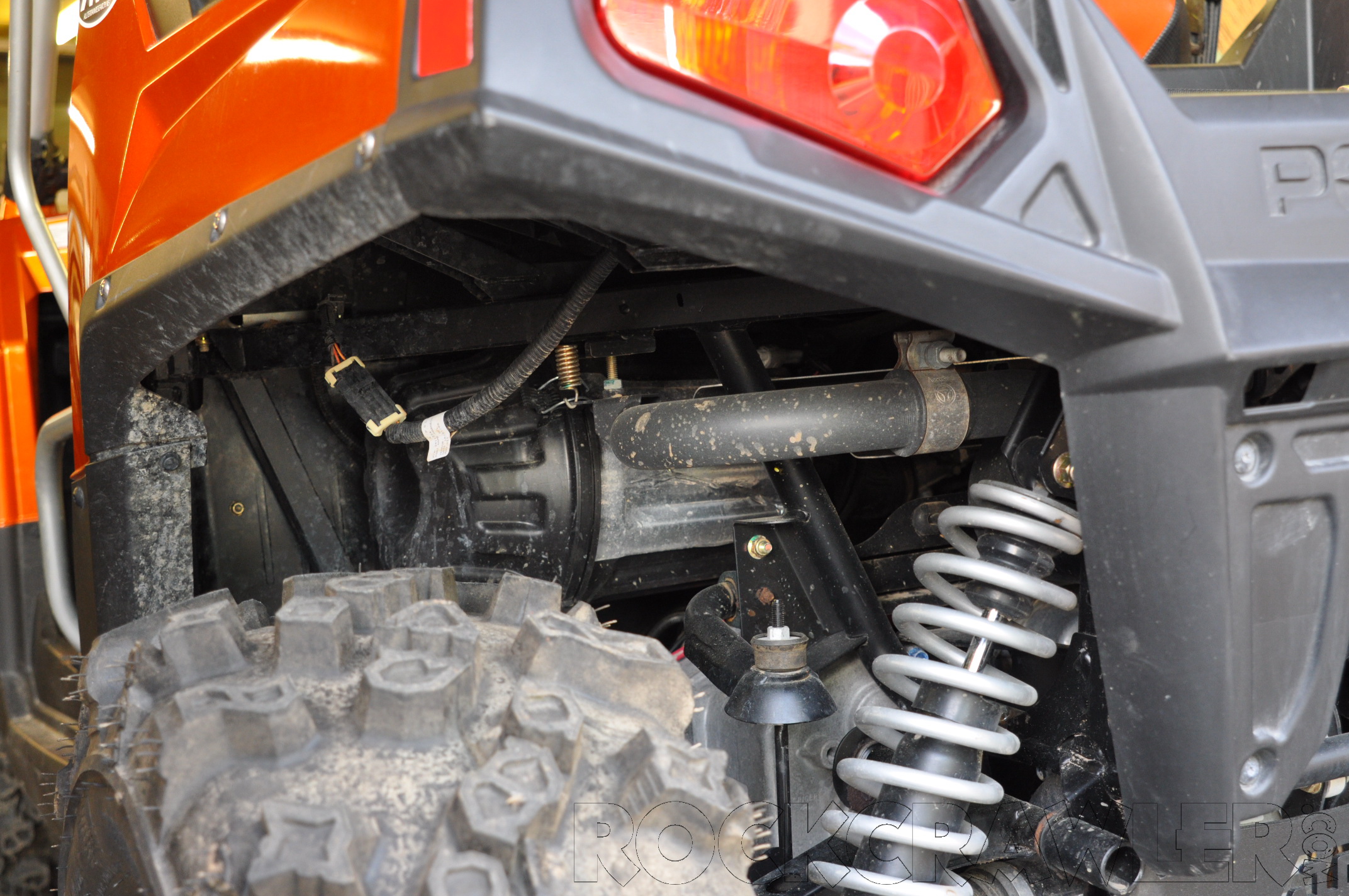

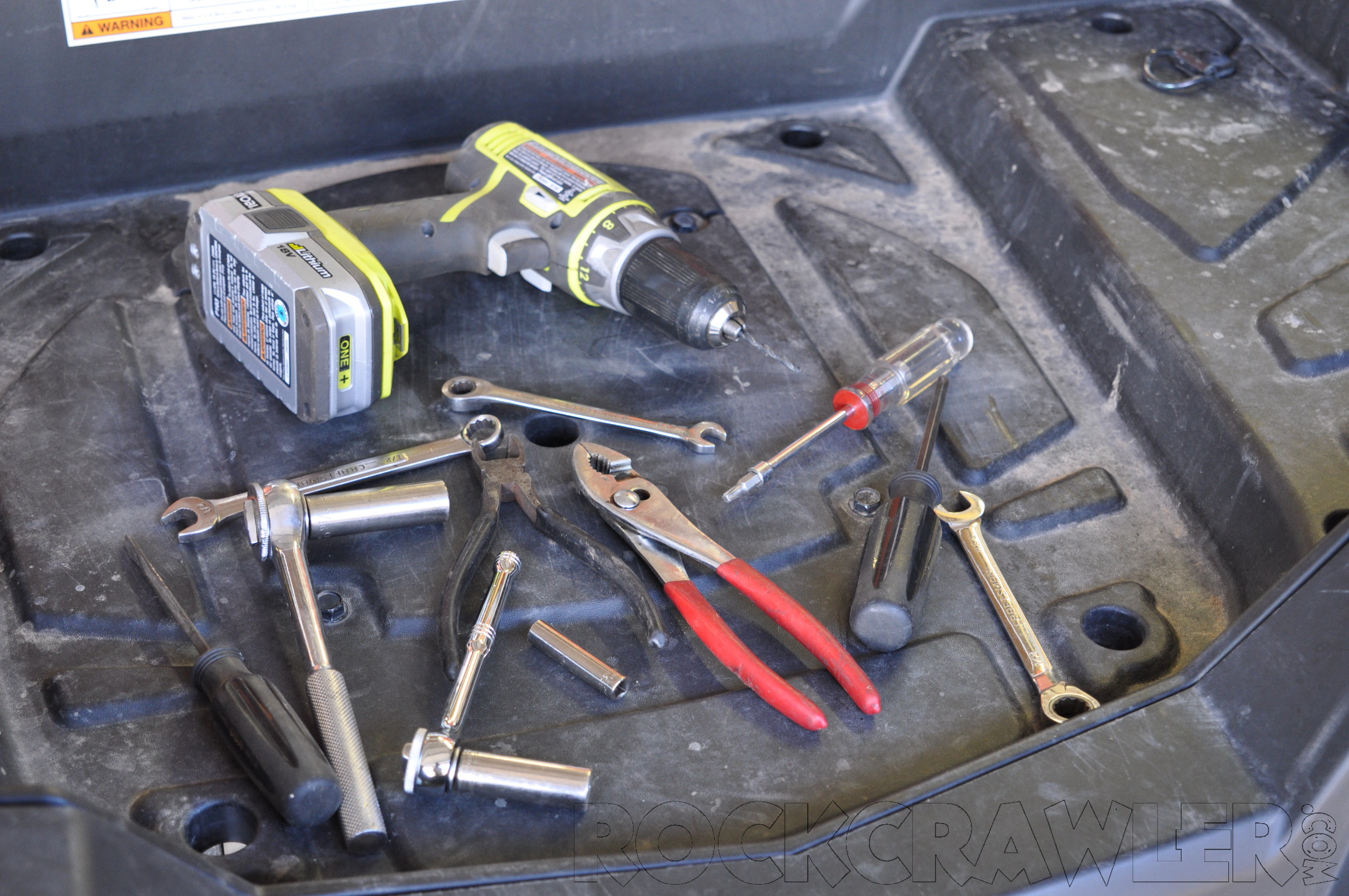

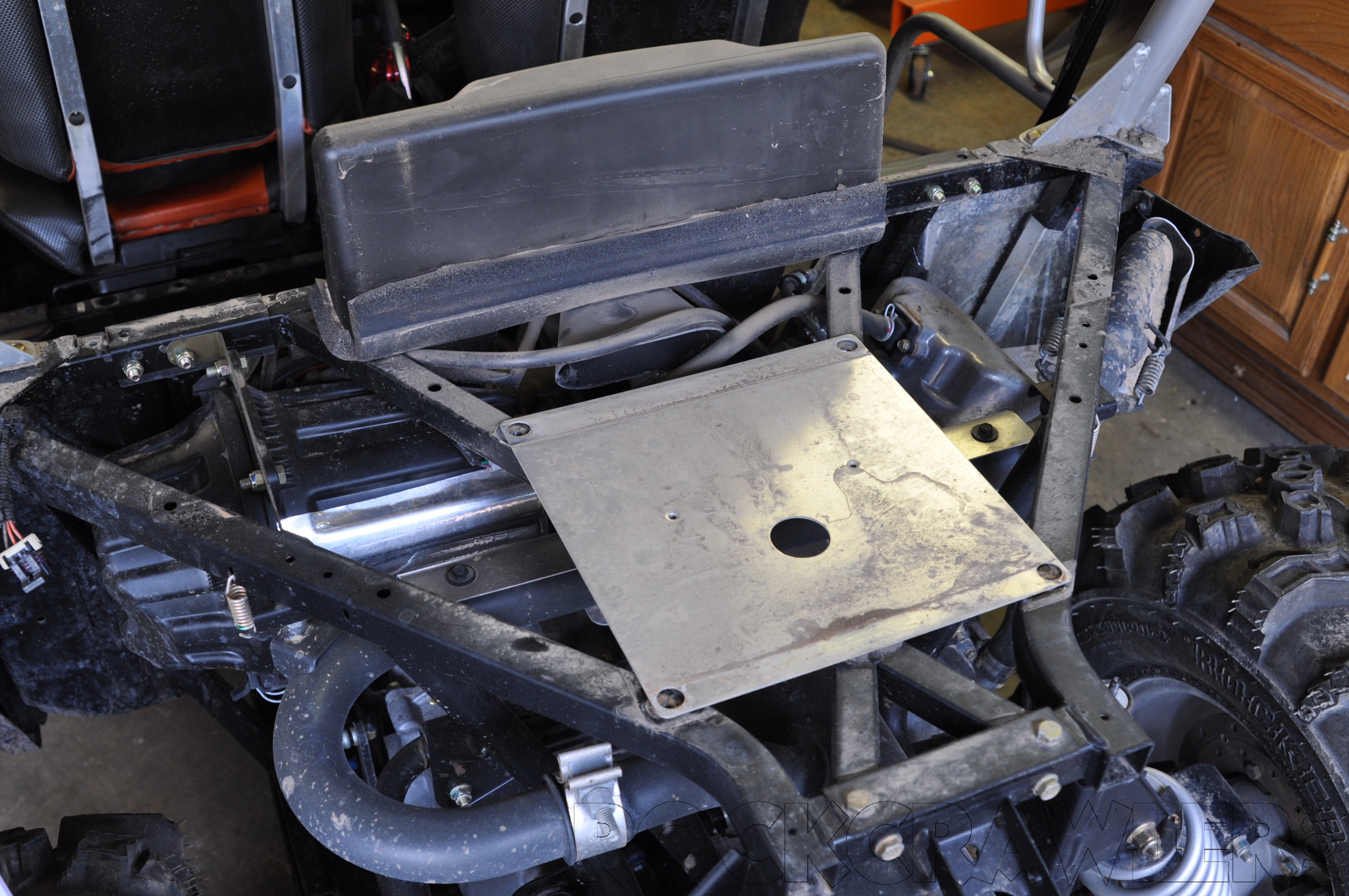

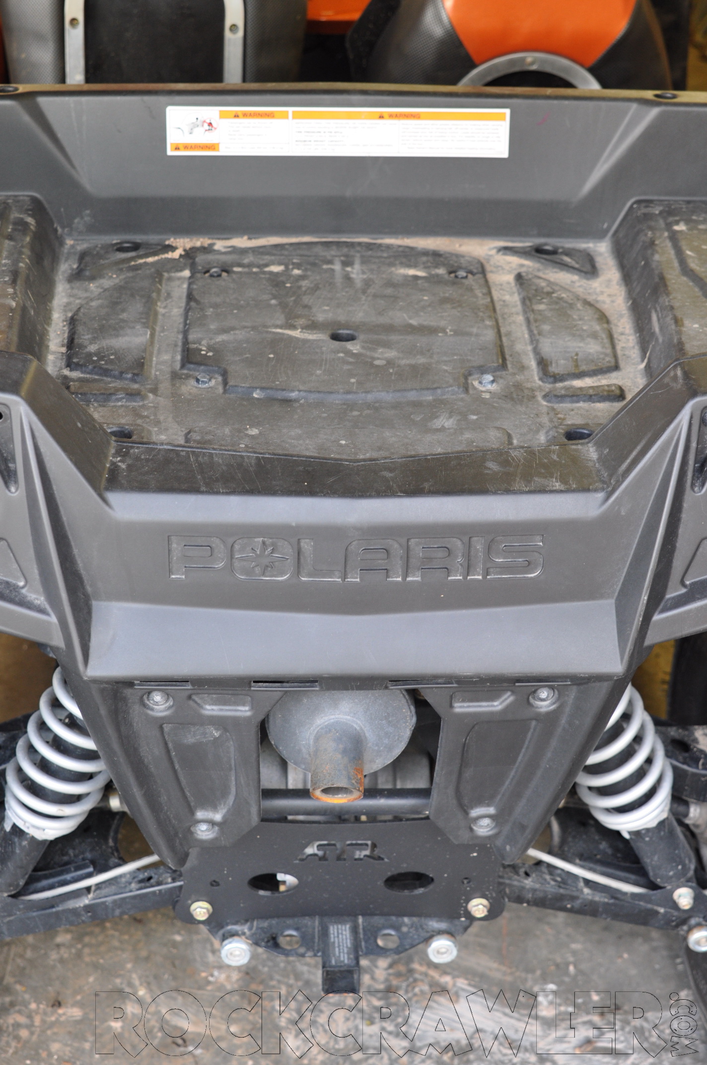

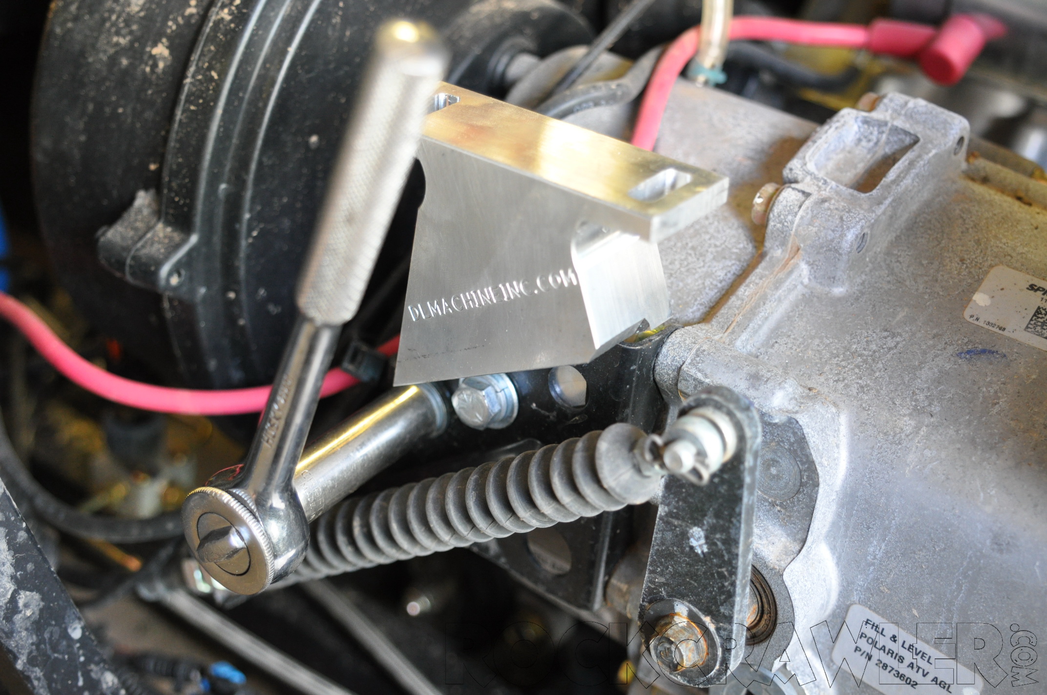

Installation:</p>Don provides a nice set of instructions, including pointing out what hardware needs removed so the rear deck lid can be pulled easily.* Not only are they numbered step-by-step, but there are printed images included as well to reference.** It doesn’t get any easier.

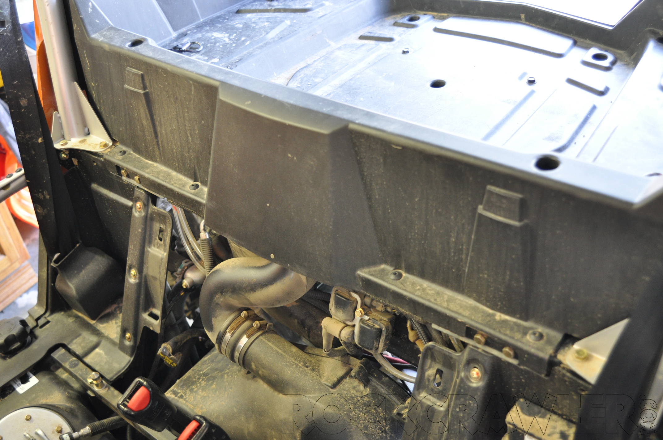

The ONLY part of the installation that’s at all difficult is step 12… drilling the holes in the stock plastic air intake housing so the machined aluminum adapter is centered.* My 2009 had the same issues warned about as the 2008 where only 2 screws went thru plastic and two were next to it…no big deal, since there is plenty of gasket surrounding the sealing point and the fender-washers included clamp onto the plastic edge nicely.

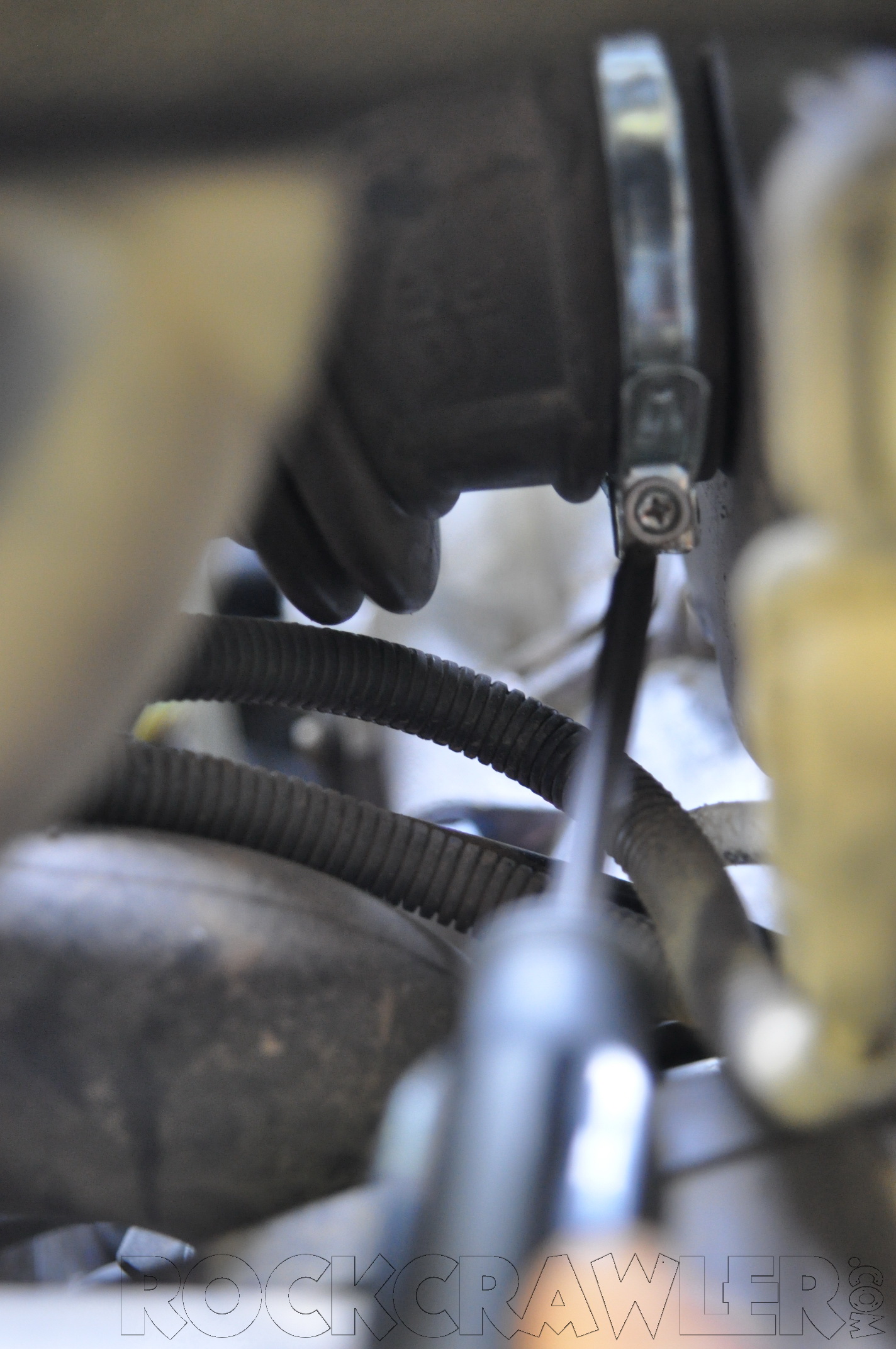

…and I hope you have small hands and good dexterity…getting the nylocks on those bolts is an exercise in irritation.

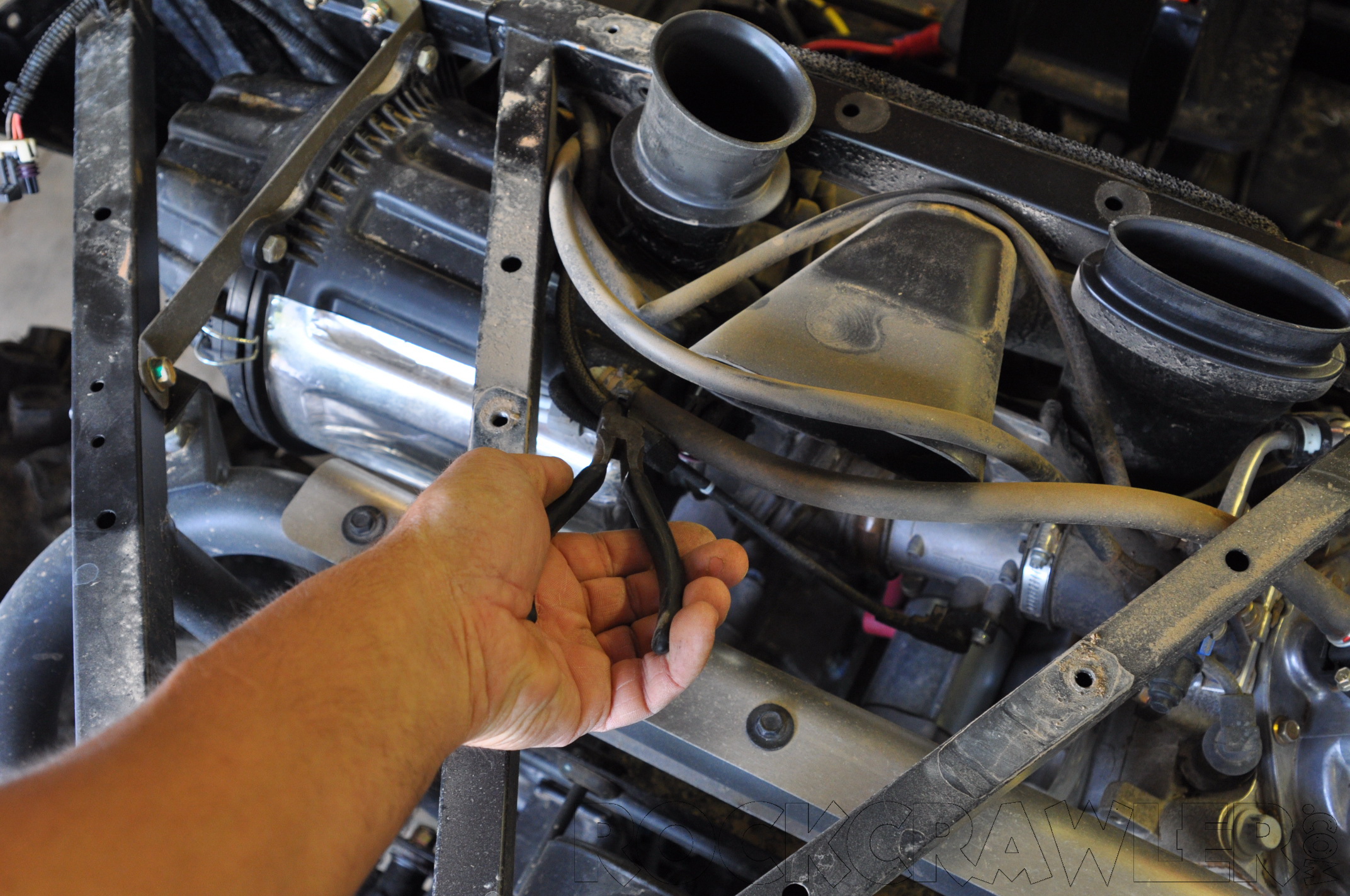

A final note…REPLACE the stock crankcase vent hose with a longer one…MUCH longer.* Get something about 36″ in length and sized to fit the airbox side (the crankcase connection required it to be stretched larger).* Loop the hose around the top of the crankcase when you install.* If you ever have the misfortune of flopping your RZR on it’s side, this will help pool some of the engine oil that escapes in the vent hose and keep it out of the airbox.* I’ve done this trick for years on my 1:1 rigs and it works well.
