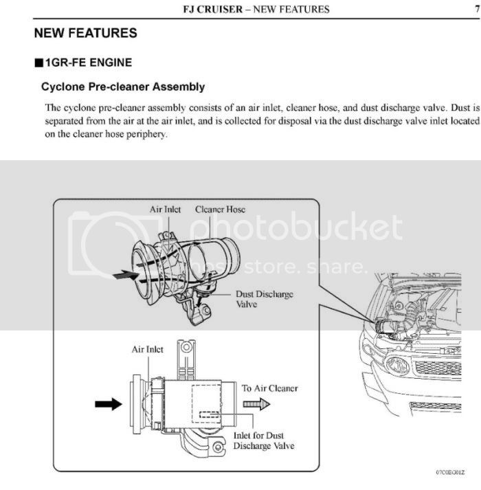

The attachement that replaces a straight tube spins the incoming air and uses centrifugal force to "spin" the dirt out of the air before it reaches the air filter. It also cerates an area of low pressure that accelerates the air into the intake. This will not work on a CAI but will work with a Safari Snorkle . I have 1 on order and should have it within a month. I'll give a update when i get it on.

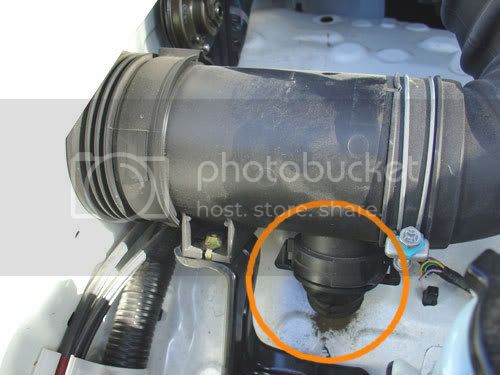

Teh dust collecter has a rubber check valve that seals off, so you have to purge it by hand (anyway that is how it works on the Prado). SO it shouldn't pose a water problem unless it is totally drowned in water for some time, at which time you will have much bigger problems with that much water in the engine bay.

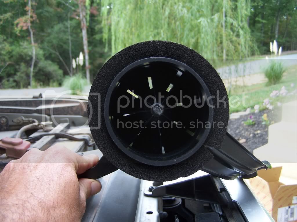

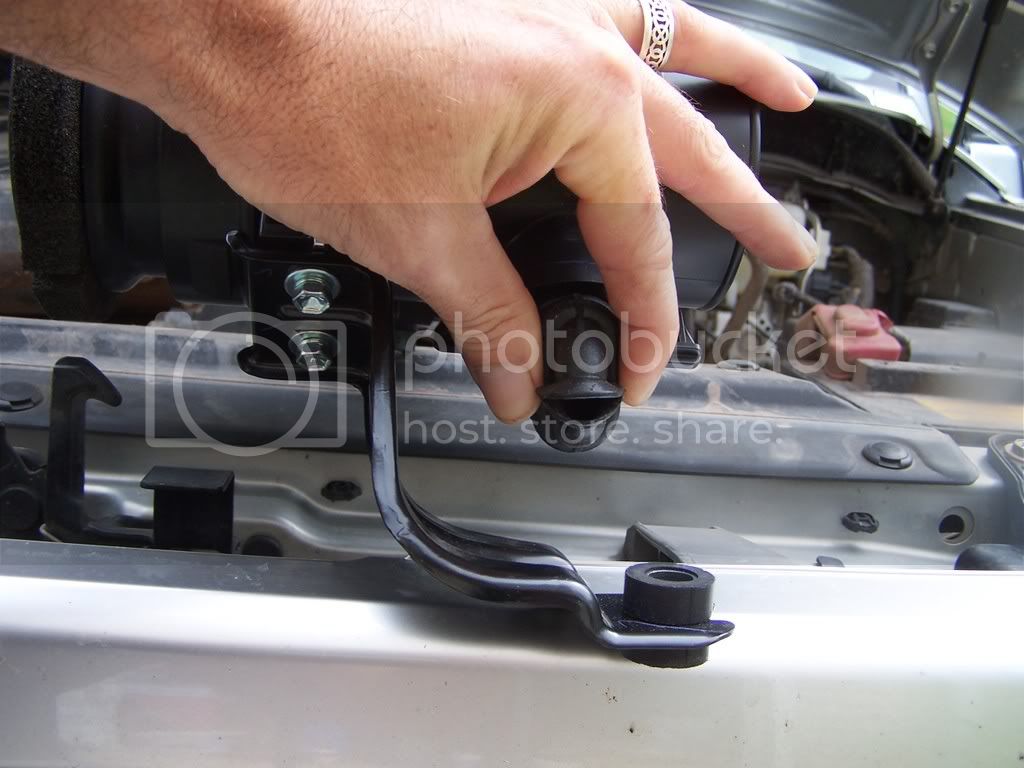

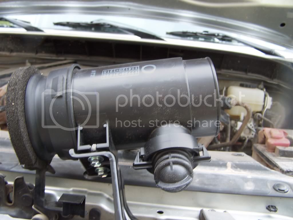

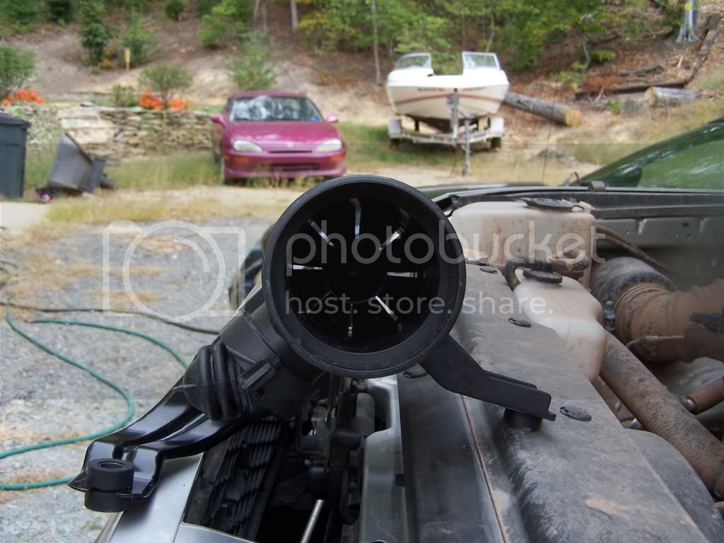

I installed the cyclone today and it was a 5 minute job. There's 2 15mm bolts and 1 clamp that have to be removed in order to install it, simple and anyone can do it. I installed a new filter as well so i can see if this thing really does anything. I'm heading to OBX next week so i'll give an update after driving on the beach for a week. Here's a few photos of it.
This is the disarge valve just squeeze.
